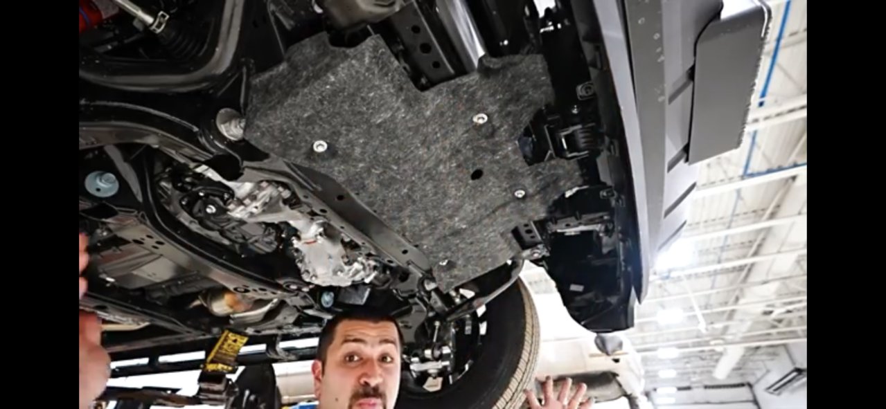

    These fiber/fabric style covers are for NVH purposes. It helps reduce road noise and also helps with exterior noise requirements automakers need to meet. It doesn’t really have any aerodynamic effect since the front air dam is there to reduce flow under the car. So if you don’t like it just remove it.

    That material sucks. Some manufacturers use it in the wheel wells too. Everything sticks to it. It’s a pain in the ass to clean.
    now if they had a hard plastic cover below to cover it, that would be fine.

    Started looking at how hard or easy it will be to change the Tundra's motor oil today.
    Had to put the front spoiler down by turning engine off and holding wiper mist lever up for 2 seconds or more. Removed 4 bolts securing the deflector under the cooler/front engine area. Looks like the same material the front wheel wells are lined with. I don't plan to do off pavement driving with the Tundra, so this light weight deflector will do fine for me, easy to remove/install, too.
    I like the drain under the spin-on oil filter:
    This deflector is super light, flexible, and easy to remove/install. You will probably need metal skid plates mentioned earlier for serious off road driving.
    Looks like this will be an easy oil/filter change.
