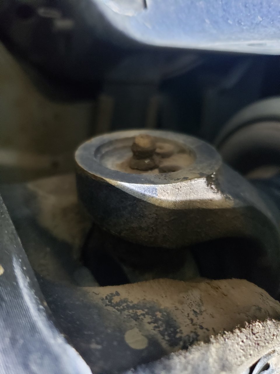

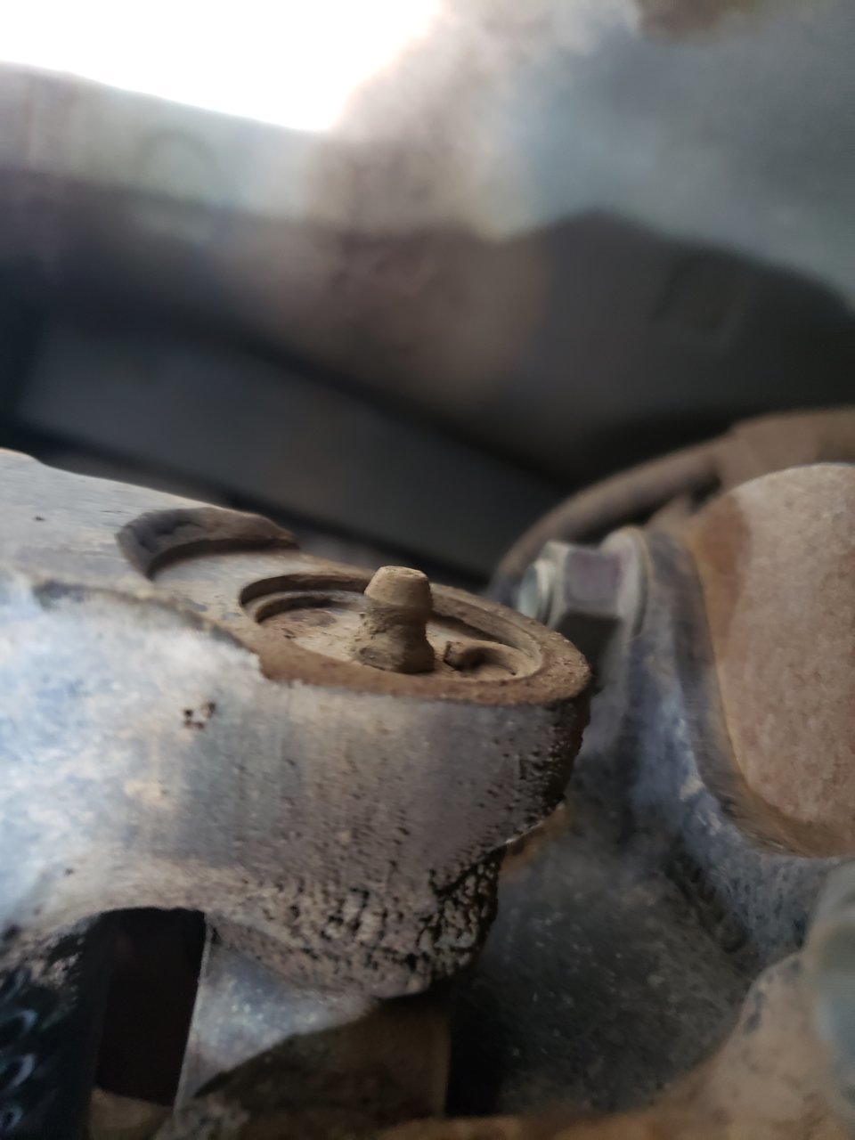

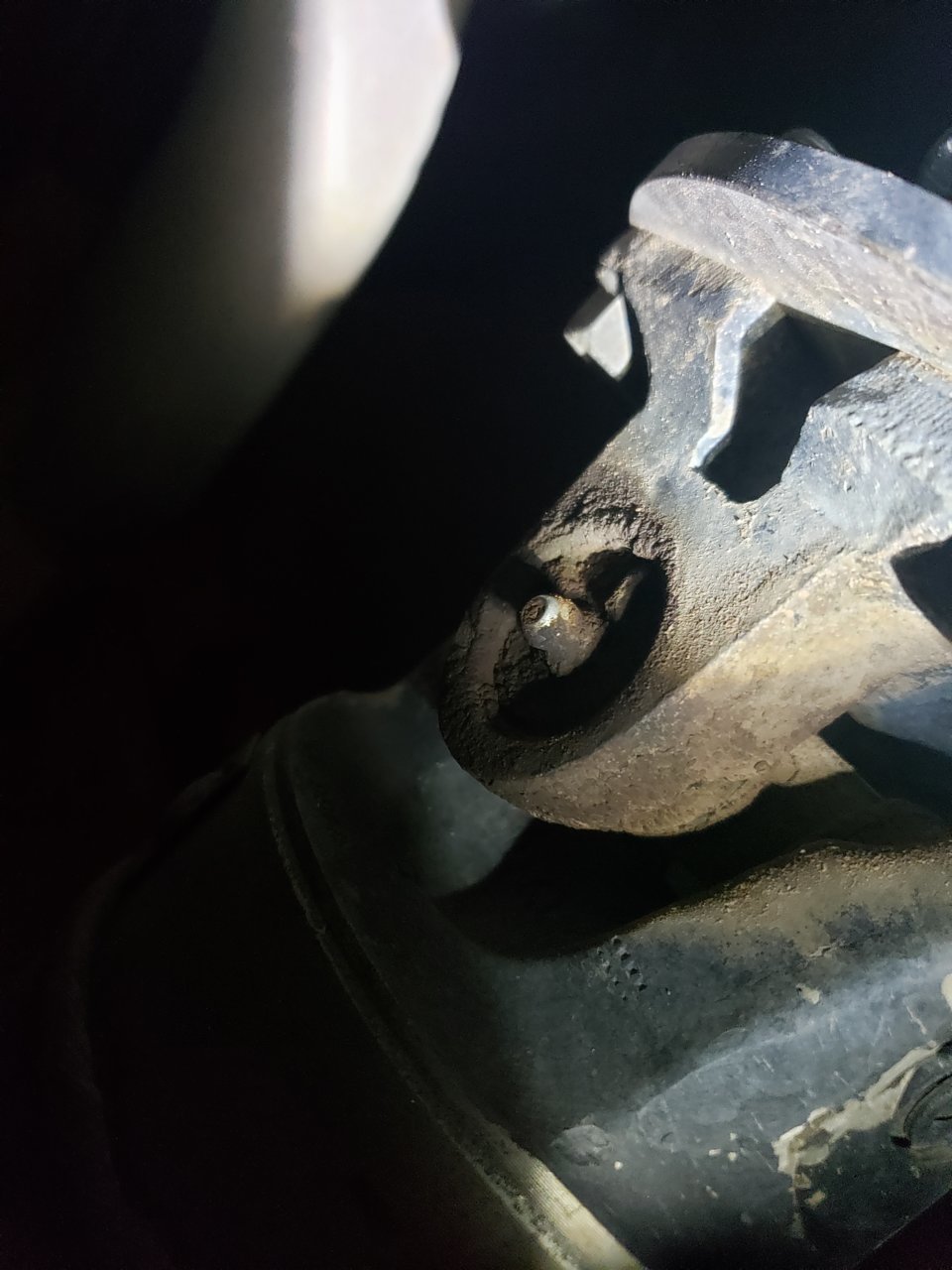

    I’ll raise it at work and have a closer look. I got under the car and just felt around with it in the driveway.
    I know when I worked at GM original joints had no grease fittings but replacement GM ones did.
    Does the fitting stick out or is it sunk in?
    Rica25 likes this.
  3. Dec 8, 2019 at 6:23 PM
    #33
    14burrito
    14burrito IG @14burrito
    Dec 14, 2014
    #798
    3,814
    2014 SR5 CM 4x4 5.7
    @ADSracingshocks - F 3 point ohh / R 2.5 - w/clickers @camburgracing - uniball UCA @rigidindustries - 40" amber/white split, Dually XL, D2 @coopertires - 35/12.5/17 STT MAXX @bayareametalfab - low pro bed rack @toyotausa - 17" rock warrior @sdhqoffroad - rock sliders, a-pillar @hondogarage / @apple / @gaiagps / @dualgps- navigation @wheelersoffroadinc - superbumps
    From what I recall, it's in there.
    When my wife gets home and takes over little man duties I'll take a quick pic if I don't forget....tired lol

    The zerks are painted over and it needs to be scraped off.
    Rica25 likes this.

    Pics are for RWD and not the forward shaft.
    Fed ones hidden, main shafts are right there easy to see, access.
