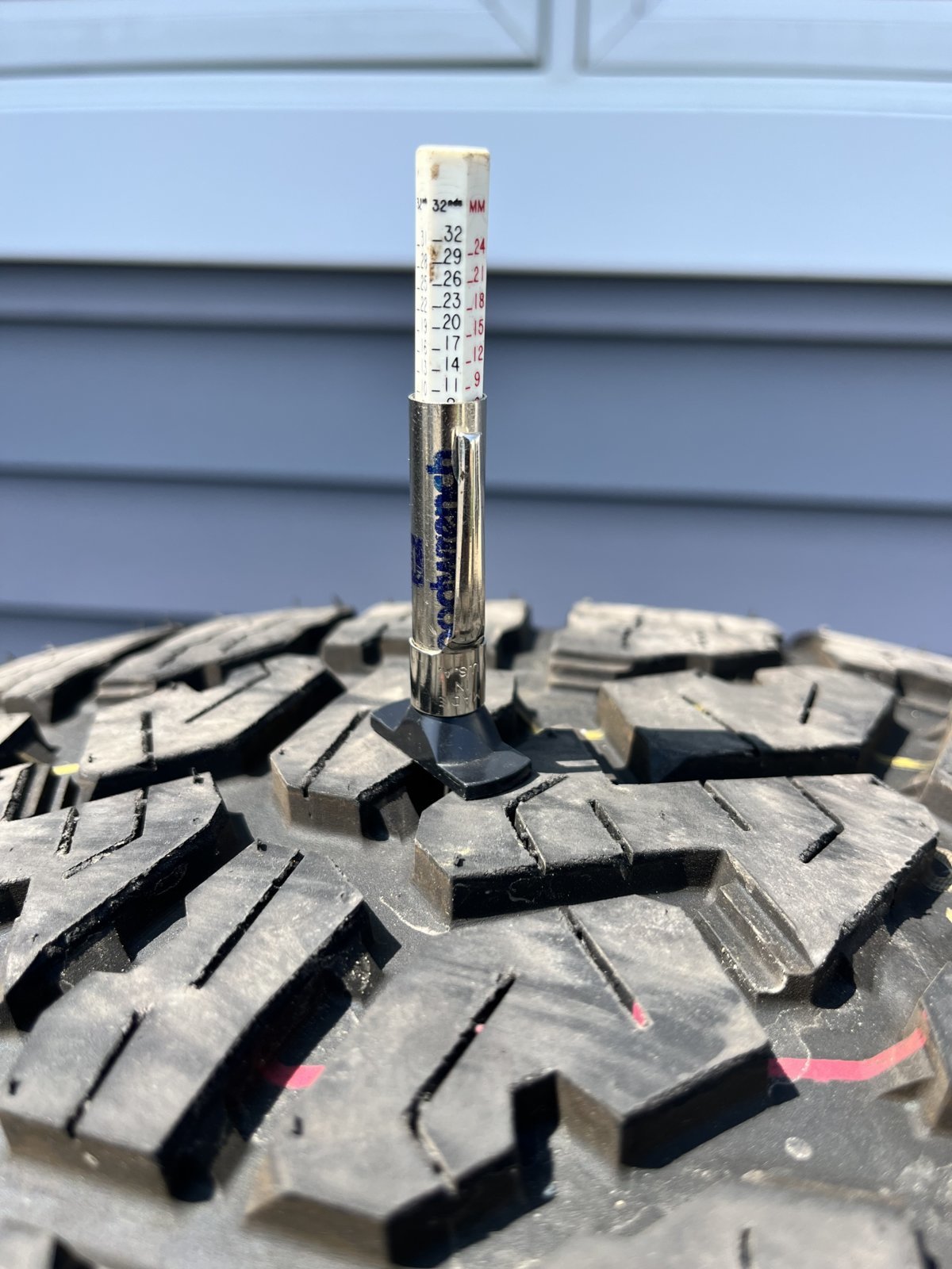

    TRD PRO comes with a bad alignment from the factory, excessive toe in and Chamber. Toyota replaced my tires after they prematurely wore, I got the same tires as replacement unfortunately. The tire depth is awful, 6/32 I couldn’t believe it.

    Brand new Pro Wildpeaks tread depth. I sold mine with less than 100 miles on them. IMG_7781.jpg
