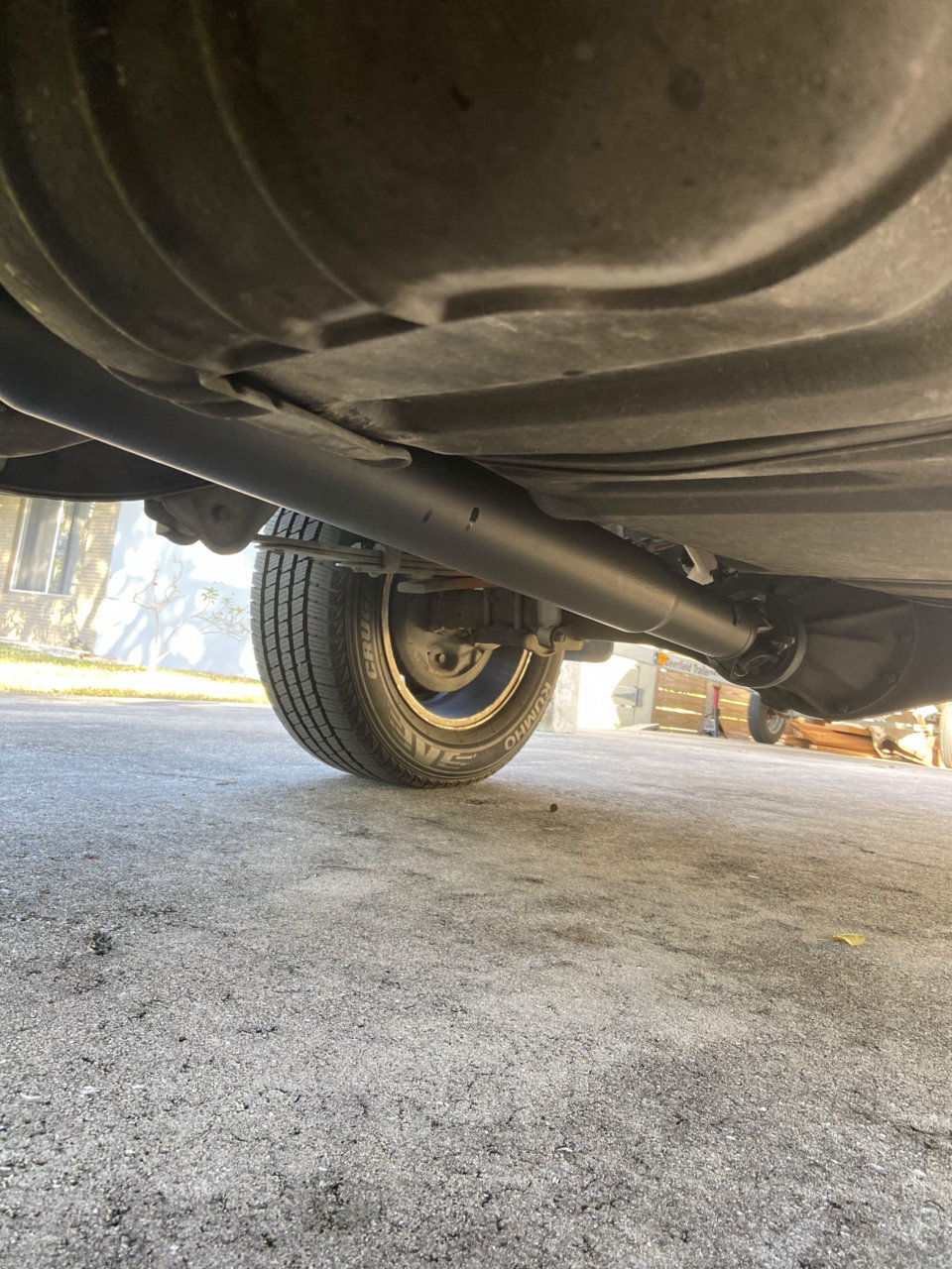

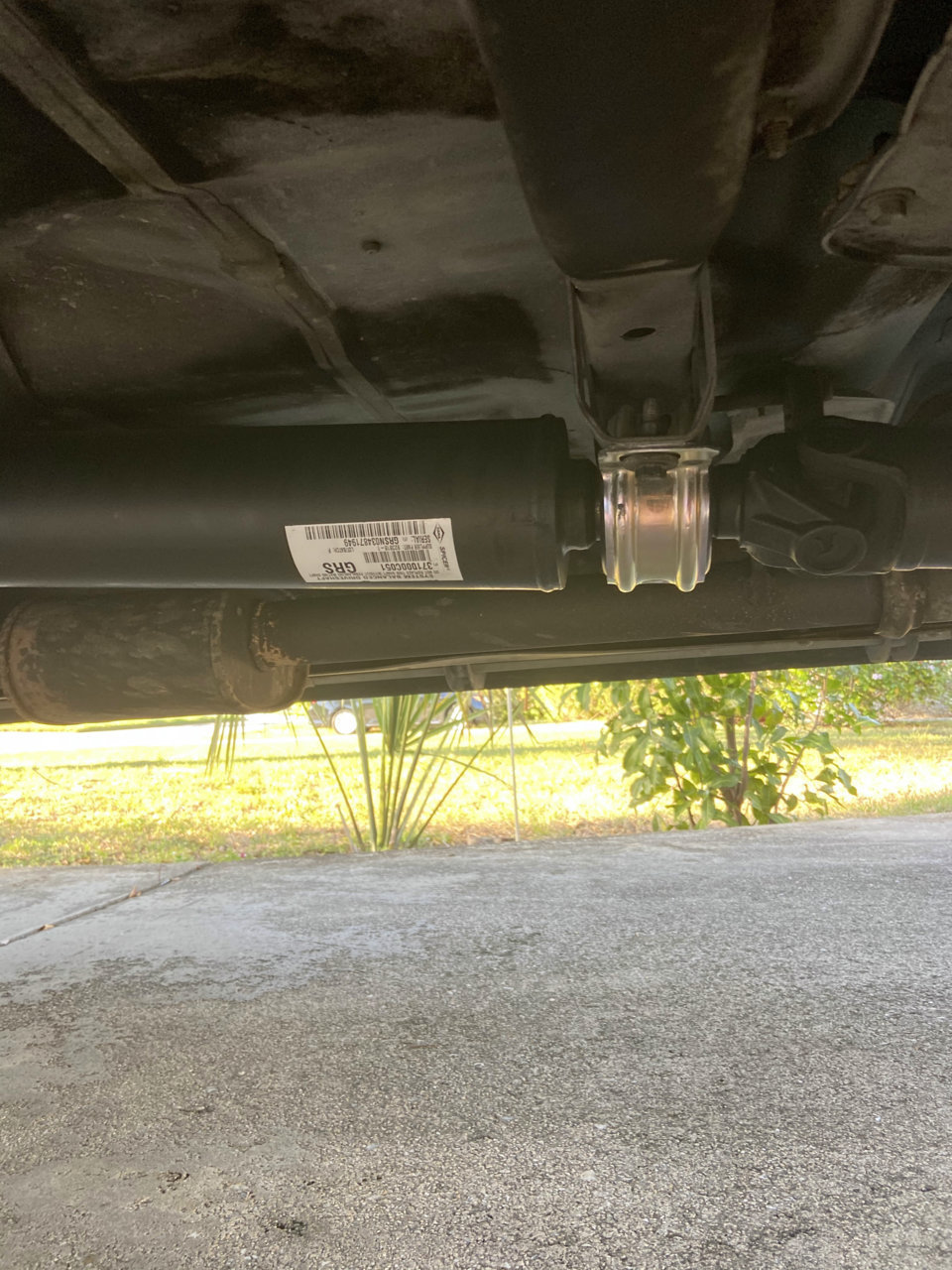

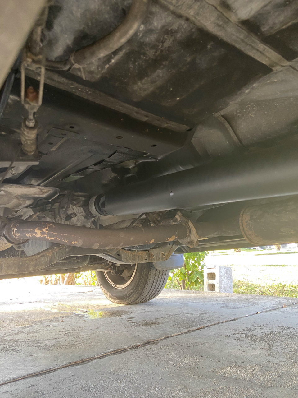

    Well, there it is, band new OEM drive shafts and center hanger. All out of money now. The first thing I noticed is that there's not backwards roll after I put it in park and take my foot off the brake.

    if they replaced the whole shaft then you must of had a ujoint go out and destroy the yoke. which would also explain the excessive movement in park
    and when that happens, you also get a nice ol clunk

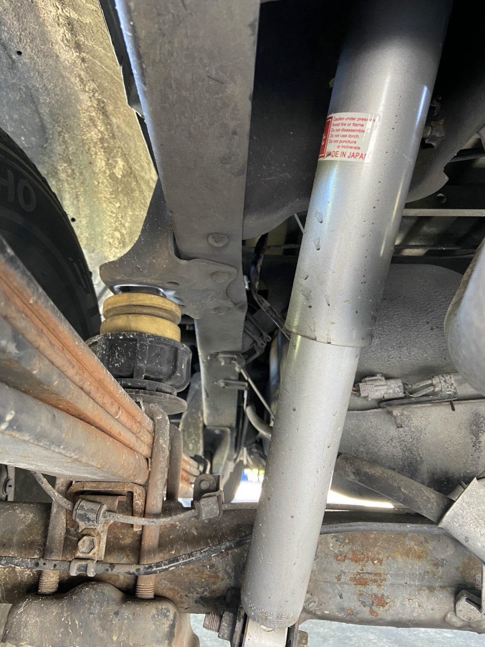

    I went ahead and paid the dealership premium since I wanted it fixed fast and was tired of the run around. She does ride much better. Now to the rear suspension: I noticed that there is a left lean to the rear and you can see the difference in clearance between the yellow bumpers. According to 1A Autoparts, it could be a broken spring [https://youtu.be/DPtydoXQZ00]. I also looked at KYB Gas-A-Just (dumb name) and these appear to the the right shocks.
    Any thoughts on uneven springs? I know that Chevy is known for this.

    Likely the springs are just worn. Band aid is some bolt on adjustable helpers to level it out. Fix is new spring packs.

    Get rid of the yellow jounce bumpers and put some appropriate ones on. Cannot stress this enough.
