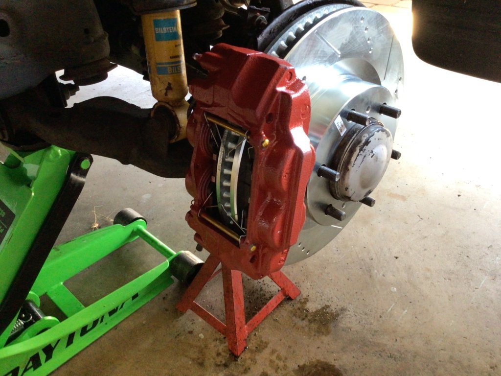

    - replaced front brakes, with new Gx460 rotors & calipers, Powerstop towing pads, and stainless steel overbraid flex lines. Had ears on calipers machined 3.5mm.

    Outcome: brakes are much, much better. Fronts are definitely, noticeably more powerful.

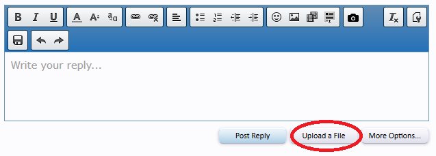

    Two options to get pictures in your reply.
    From smartphone/tablet, 2 ways:
    • Hold your finger on the picture you want to share; choose copy; go to the reply box, tap in the same spot twice (this may vary from Android to iOS) and choose 'paste' to apply the pic.
    • See instruction/photo below to use the Upload a File button, which will attach pictures into your post as thumbnails
    From computer, 2 ways:
    • Right-click the picture and choose Copy; click in the reply box where you want to put the image and press CTRL+V (in Windows) or Command+V (in MacOS)
    • Click the Upload a File button, which will attach pictures into your post as thumbnails

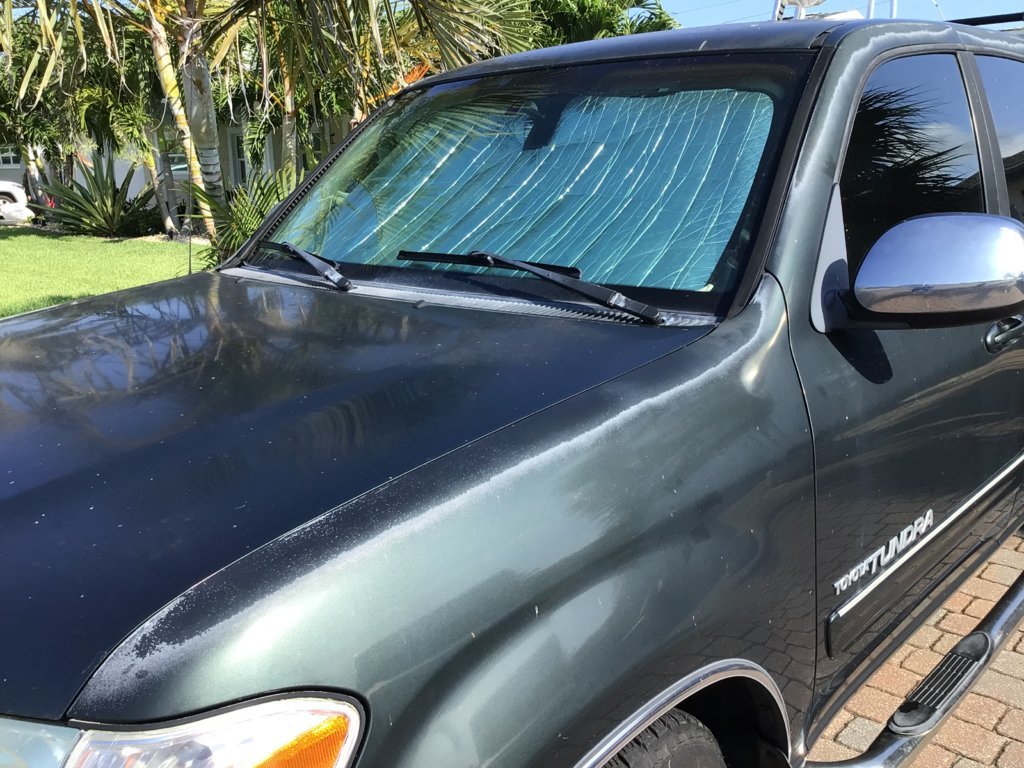

    Jedgar
    Jedgar [OP] New Member
    Aug 12, 2020
    #50693
    50
    2006 SR5 Double Cab 4WD, V8, forest green w/ topper
    None (no lift, don't want one), Bilstein 4600 shocks soon. Bigger Michelin tires soon.
  7. May 25, 2025 at 1:17 PM
    #67
    Jedgar
    Aug 12, 2020
    #50693
    50

  9. May 25, 2025 at 1:37 PM
    #69
    Jedgar
    Aug 12, 2020
    #50693
    50

    That aftermarket threaded rod on your LSBP valve ain’t right.
  11. May 25, 2025 at 5:15 PM
    #71
    shifty`
    shifty` We call it “riding the gravy train”
    Jun 20, 2020
    #48239
    29,793
    ATL
    '06 AC Limited V8/4WD
    I didn't want to say anything, but lemme tell you: That LSPV is WIDE open :rofl:
    Can't get less bias than that out back, so definitely no need to adjust the rears :D

    “Wide open” lspv was the only way I could get the rear wheels to skid (indicating max braking). As soon as they start skidding, abs kicks in and controls. The “aftermarket” threaded rod & bracket was my own concoction, fabbed from stuff I had laying around the garage, and a lot cheaper and less labor to install than a maual proportioning valve, which would require continual fiddling with depending on how the truck was loaded.

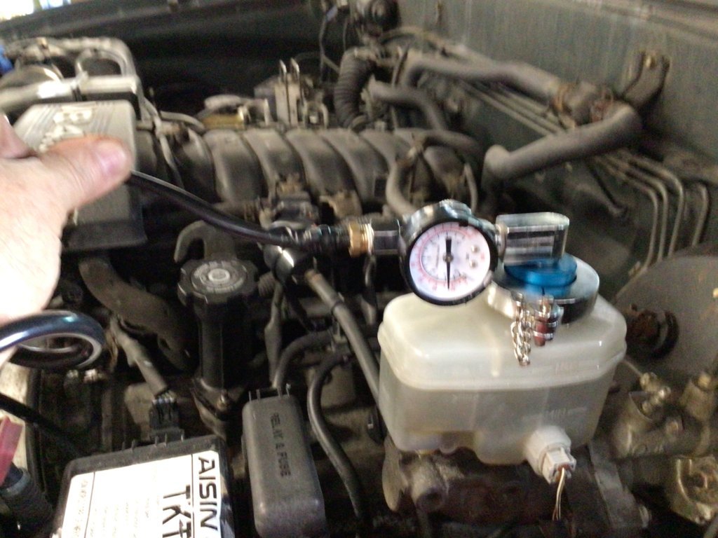

    Nobody commented on the Addco sway bar and Bilstein shocks (handles good), and “trick” set-up for pressurizing the master cylinder.

  13. May 26, 2025 at 6:01 AM
    #73
    Jedgar
    Aug 12, 2020
    #50693
    50
    Oh, and yes you do need to keep the rears adjusted tight regardless, to minimize peddle travel. The mismatch between the stock master cylinder and the new bigger front calipers adds a little extra peddle travel, so keeping any slack out of the hydraulics keeps that in check.
  14. May 26, 2025 at 6:21 AM
    #74
    Jedgar
    Aug 12, 2020
    #50693
    50
  15. May 26, 2025 at 6:22 AM
    #75
    Jedgar
    Aug 12, 2020
    #50693
    50
    KNABORES likes this.
  16. May 26, 2025 at 6:27 AM
    #76
    Jedgar
    Aug 12, 2020
    #50693
    50

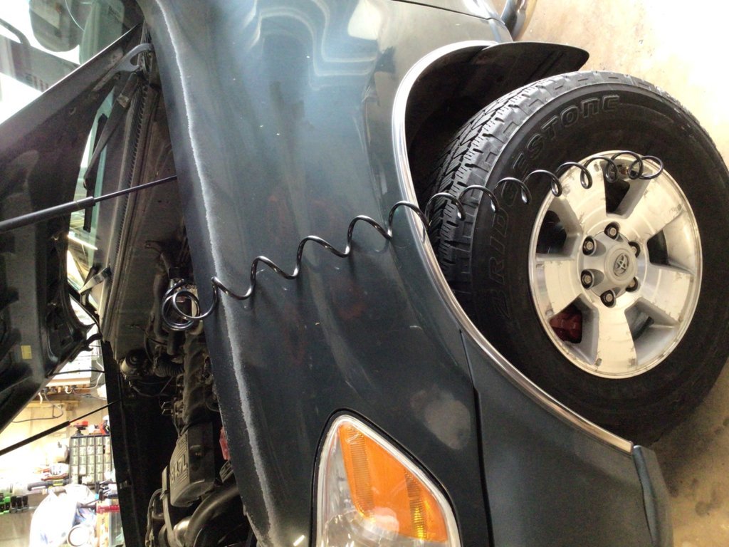

    Would love to do a “Waltrip- esque” mod to the front grille (or to an aftermarket one), before I do the painting : what’s the best / easiest option for this?

    Best bet is to find one of the FMS sports grilles and rehab it. That's what I did, and I made a writeup for anyone hunting for the same look: https://www.tundras.com/threads/1st-gen-darrell-waltrip-fms-grille-info-dump.147323/
    Knowing what area (of FL?) you're from could help someone help you source something. It's important to know the double cab version won't properly fit your access cab truck.
    Sometimes searching around for "Waltrip tundra" will net you what you're looking for on a parts truck to snatch one from. Sometimes it helps to mispell it waLLtrip. It wasn't exclusive to the Waltrip, it was also on the Yamaha edition Tundras and some people bought them from the dealer. I've seen Waltrip trucks also on www.car-part.com for ads that have pictures, but see that thread for what you need to watch out for.
    To "build you own", I saw one person's advice online, maybe on another Tundra forum. They basically:
    • Took the stock grille,
    • Carefully cut out the two horizontal bars,
    • Got some scrap ABS plastic to make crescent-shaped plugs to fill the holes where the bars met the outer frame
    • Shaved off a pile of ABS plastic shavings, mixed with real-deal Acetone (not the fake stuff) to make ABS slurry, and ABS-welded the notches in
    • Sanded everything down, used body filler to smooth the inner circle out
    • Screwed a screen to the back side of the grille (they may've added some extra bosses by ABS welding chunks in at the support locations you'll see in my thread, where the metal screen bolts into)
    I had quite a few hours of work into mine, but it was the look I wanted, and it's not like you can find them paint-matched already very easy.

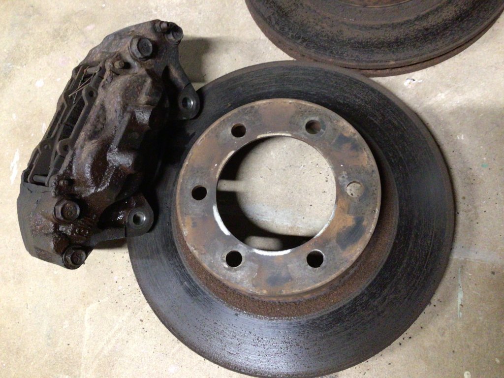

    If anybody is interested in a set of OEM 13wl rotors and calipers, if you pay the shipping from 32931, I’ll send them to you. They’re alittle crusty, but could be cleaned up with a wire wheel, and were functional when I took them off. The rotors are a little warped (pedal pulsation) but not bad.

    Nick
    KY
    01 Tundra V8 4X4 AC SR5 TRD
    Interested in at least the calipers depending on how shipping would play out. I'll PM you.
