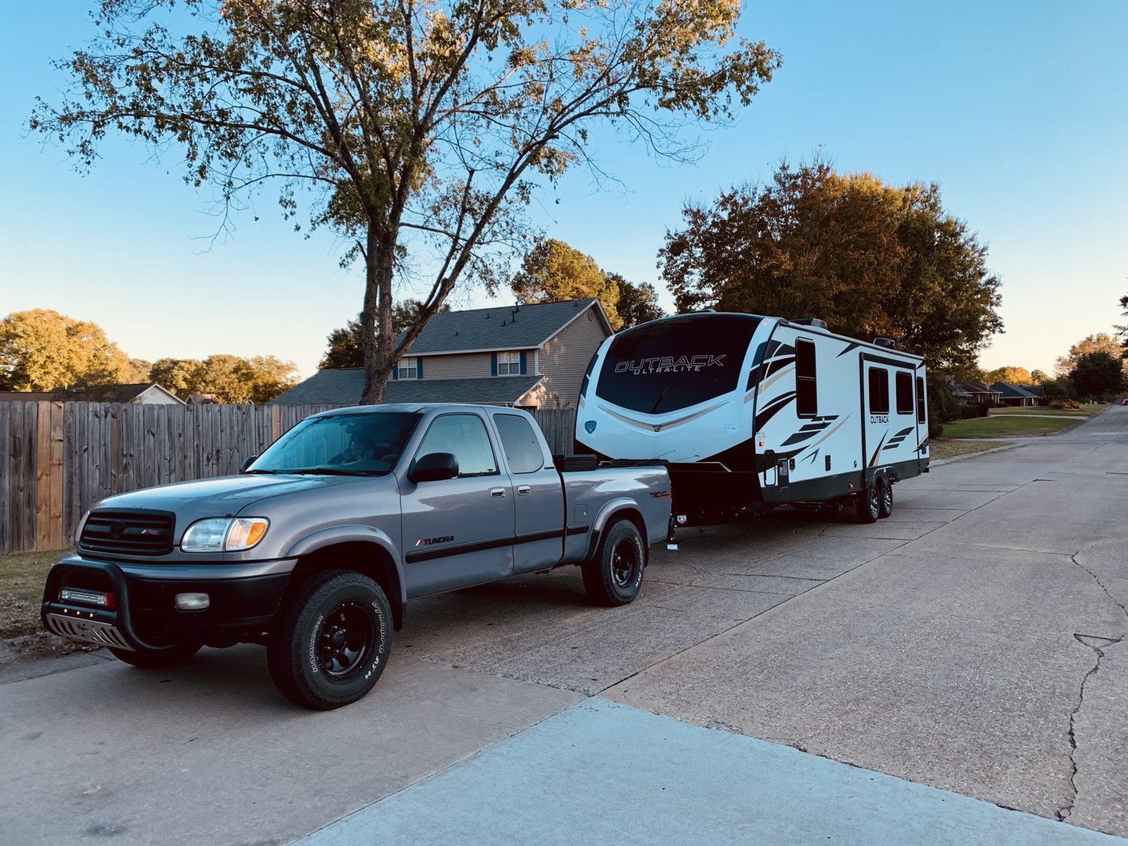

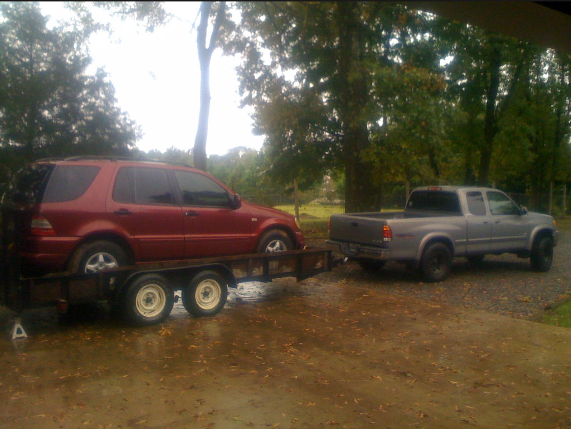

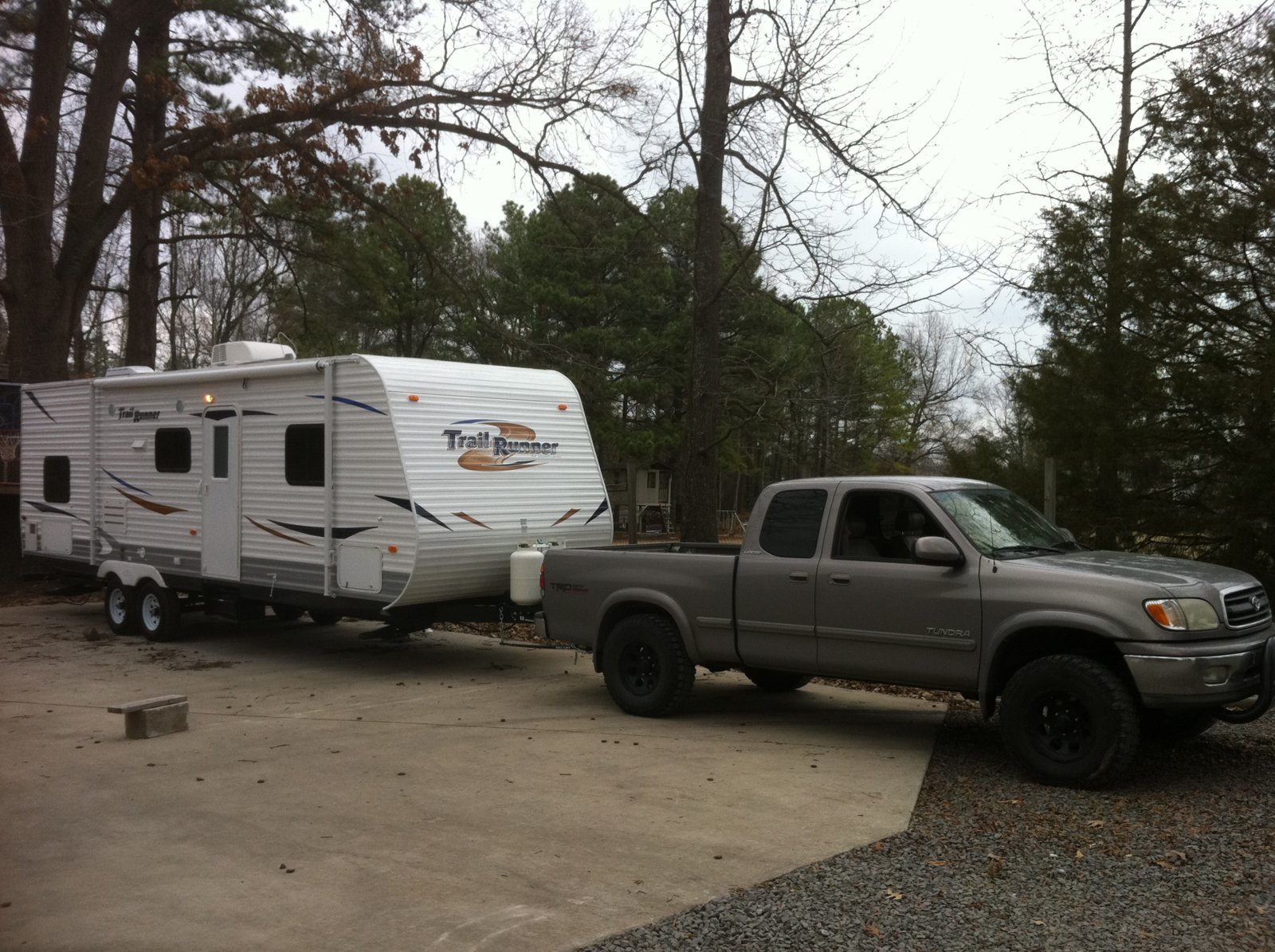

    This much? 6500# UVW with trailer brakes
    This much? 1500# trailer and 5000# SUV with no trailer brakes?
    This much? 7200# UVW with trailer brakes
    whodatschrome and shifty` like this.

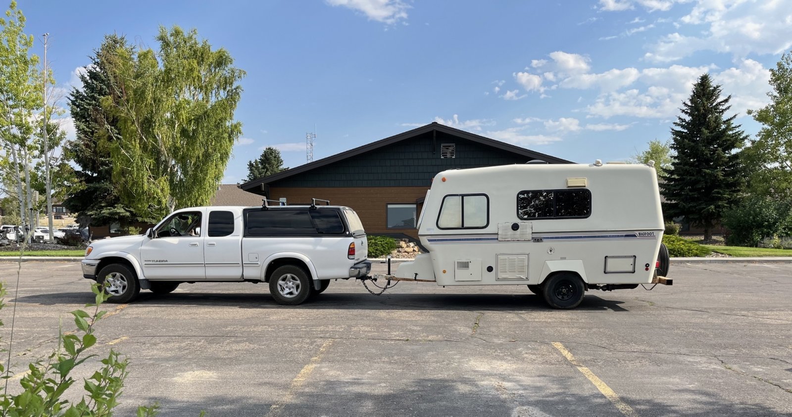

    Comfort is a highly individual thing. I towed this for years with a 98 Tacoma. ~3,000lbs.
    More than a few on the trailer forum considered it way undersized/underpowered. They weren't wrong, exactly...but it was well within the 5,000lb tow limit of the Tacoma. With trailer brakes, it wasn't bad. It was slow. Slamming the brakes in traffic during an emergency? Sketchy. But I made it work for thousands of miles.
    Now I tow the same trailer with my Tundra. I've got to say, I wouldn't be "comfortable" towing anything bigger. It's rated for more weight, obviously people tow more with them, but I wouldn't be comfortable.
