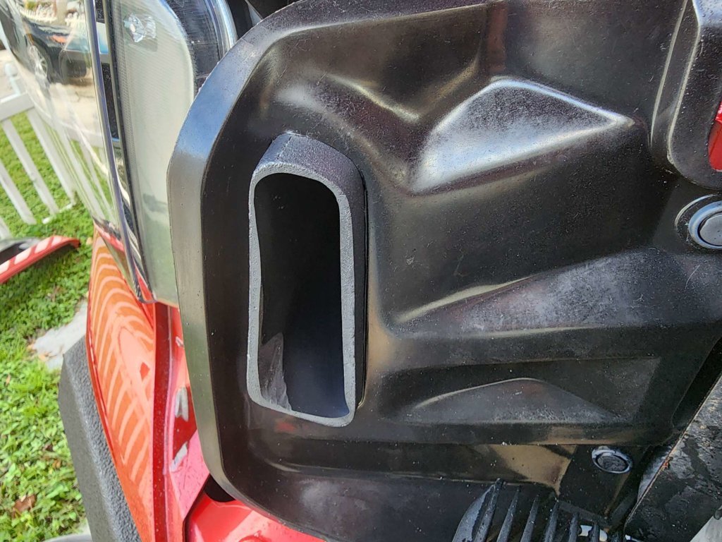

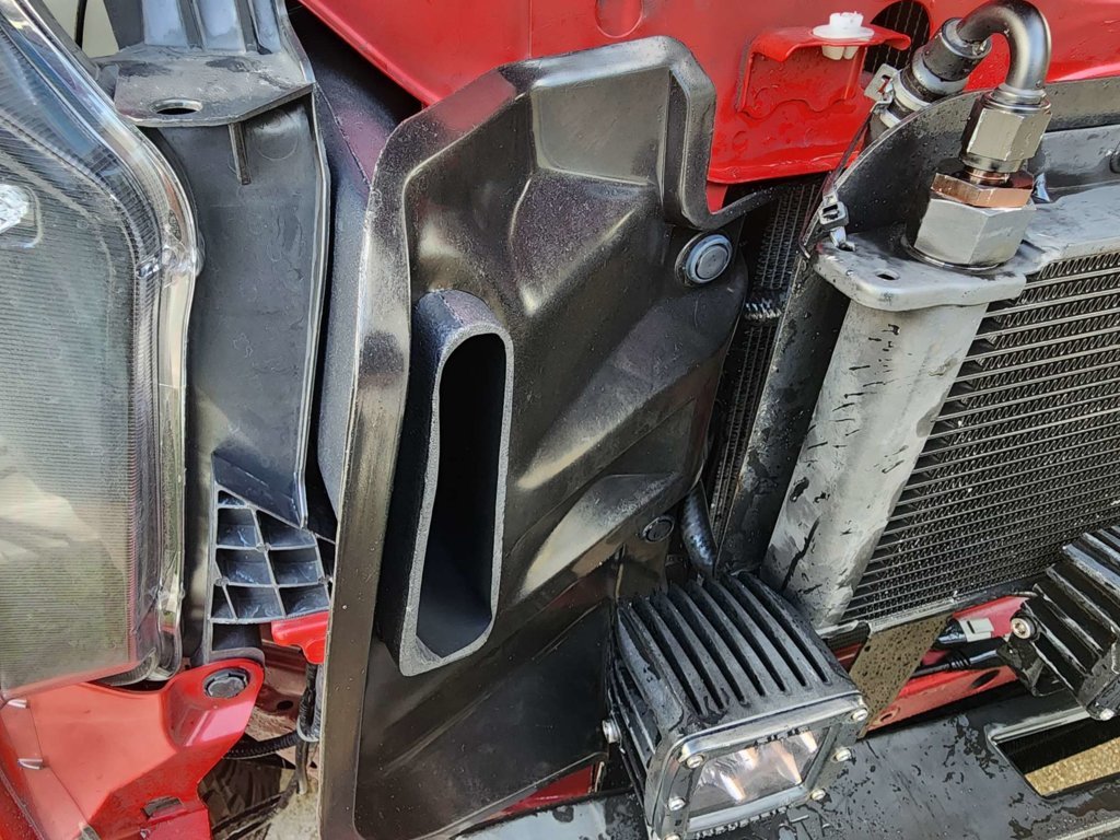

    The 2 lines run from the cooler go through the shroud. The holes have to be drilled on the Stillen shroud.

    If I'm not mistaken, it's because we have pre '19-'21 with the factory trans cooler so we don't have the DIY trans cooler behind the grille. Am I right?:confused:
    Ours is a simple shroud swap :thumbsup:

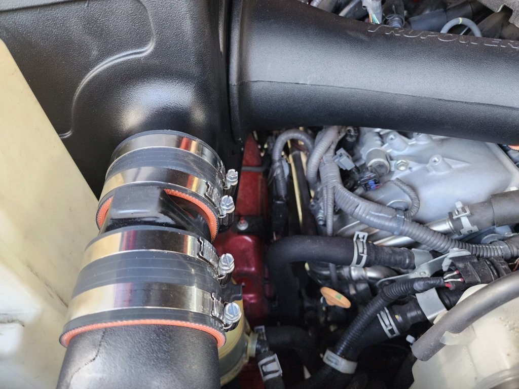

    So where is your intake tube sitting in relation to the shroud opening. My kit is the one that has the block off plate option. If I install the tube without that piece, the silicone coupler is too short. Installing it with that piece, I had to push the tube through the opening to get it to fit. I doubt having it sticking out versus being flush with the shroud will make any performance difference. I think getting a new coupler and getting rid of that blockoff would make a cleaner installation. Another option is replacing that piece with some PVC and leaving the tube protruding through the shroud. @pvn.beluga @TacomaTRD4x402

    Dang didn’t see this. Didn’t realize you got the block off plate!
