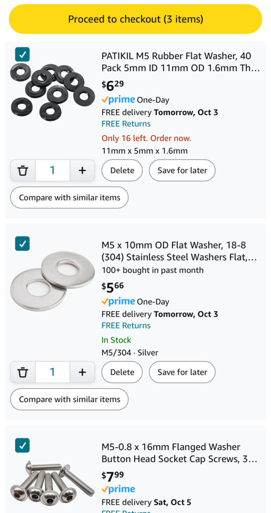

    Going to pick these up to mount up that lid. The washers are sitting at 10mm OD and the rubber washers are sitting at 11mm OD. Should look pretty good I’m hoping.

    I think Rene had said the socket caps were rubbing his hood so he swapped back out to button caps.
    I’m going to replace the one Stillen gave me with some longer ones, not sure how long those ones are but I’ll get the 16mm and try those out.

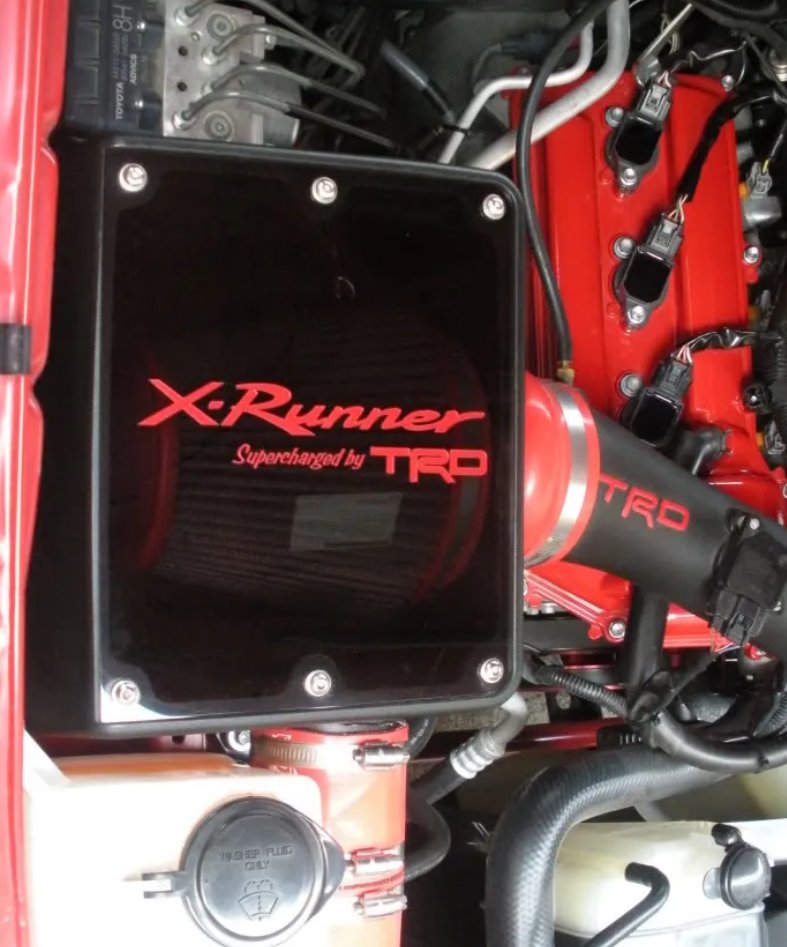

    These look good.
    I made something similar for my X-runner.

    I bought this tinted acrylic at McMaster Carr. I don't remember what they called it. This is not bronze, the color is off slightly because of the lighting. I believe it was a dark grey. The first couple I made I made with a dremel tool. Later ones, I cut on a laser. The logo on this cover is laser etched, then I painted it red to match the truck.

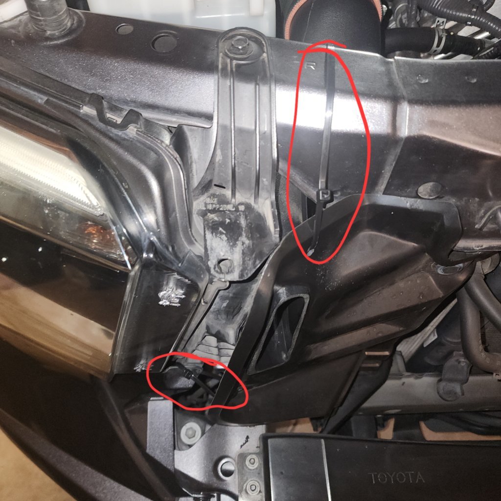

    Yep, just as I expected. Pulled off my grille and sure enough, the shroud is pushed back too far..
    So I'm thinking of cutting small holes in the left side of the shroud to pull it back then push the intake tube in as much as I need to to make it flush. In your case I'm wondering if you'll have to cut a piece of your tube off.
    Right here I have the tube pushed as far back as possible and I've found it like this as well..

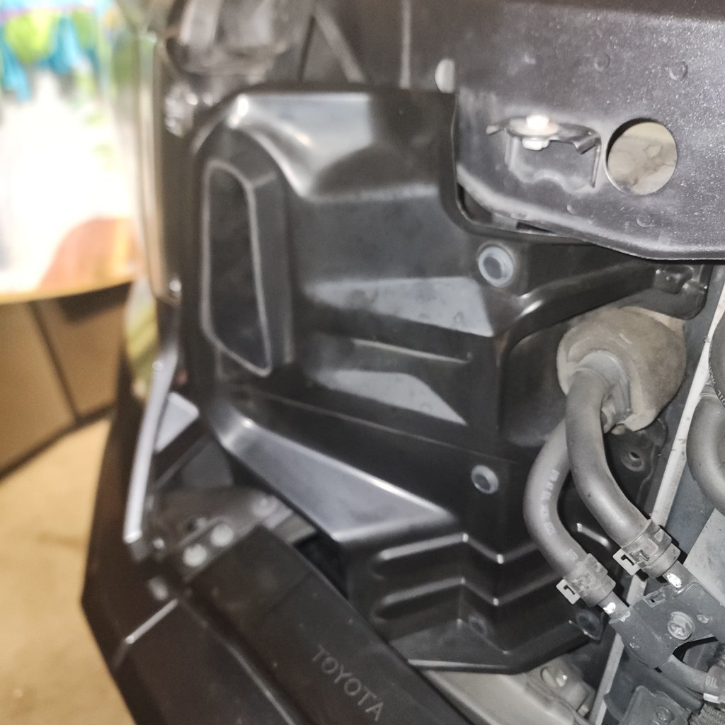

    Since I had of right now...
    This is what I had in mind to pull the left side of the shroud back. Just a couple small holes in the shroud and a few zipties n it should hold it in place(just a temporary solution)
    It may be the tinniest difference between flush or protruding but I feel flush would capture a fraction bit more air.
