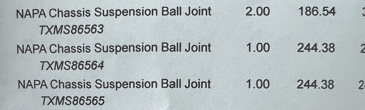

    Thanks all, so the work that was done is as follows and all by a very reputable ASE shop that I’ve used for years…
    - Upper and Lower Ball Joints
    - Axle seals
    - Front Rotors
    - Front Calipers
    - Front Pads
    - Adjusted improperly adjusted Read Drums
    - Alignment
  7. May 3, 2023 at 6:10 AM

    Honestly, as much as I and I'm sure other folks on here would love to solve the prob for you, this is one of those cases where I'd be marching back to the shop. This started after their work, and appears directly related (it's both suspension and braking, two systems they overhauled and tweaked) and ask them to inspect and fix. Sharing the video with them should clearly show the issue.
    We could sit here and lob guesses at the issue, but IMO, there's no silver bullet on this one, and too many unknowns regarding the work done and parts used.
    For your truck's sake, and possibly your life's sake, I sure as fuck hope they used OEM lower balljoints. There's a wall of shame with hundreds of 1st gen drivers who used aftermarket lower balljoints on these trucks and within a few thousand miles, found their wheel laying paralell to the pavement or shoved up into the firewall. Doesn't matter the brand. And Moog had a major recall on LBJs for 1st gens less than 24 months ago. Seems like a new one pops up every week on the FB group, and we have our fair share here for people honest enough to talk about it.

    He was aware and used these NAPA OEM spec, said they were good and pricey as can be so….
    Anybody have experience with them?

    Someone here shared a story, a local dealership ran to a NAPA to get LBJs for their vehicle when they had theirs done, and service agent told them, "Eh, we do this all the time" (or something to that effect) but ... I can't speak to it.

    I wonder if these are re-boxed OEM (as in Napa bought from Toyota and put it in their box). They are pricey.
    If they are NOT actual OEM lowers, I would be leery of them.
    I remember that as well but I think they went somewhere else for OEM ones?
