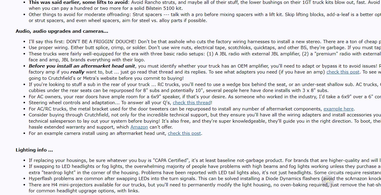

    The first two replies have all the info you need.
    It's all organized into sections. Scroll about 4 or 5 sections down in the 1st reply, it's literally right there.

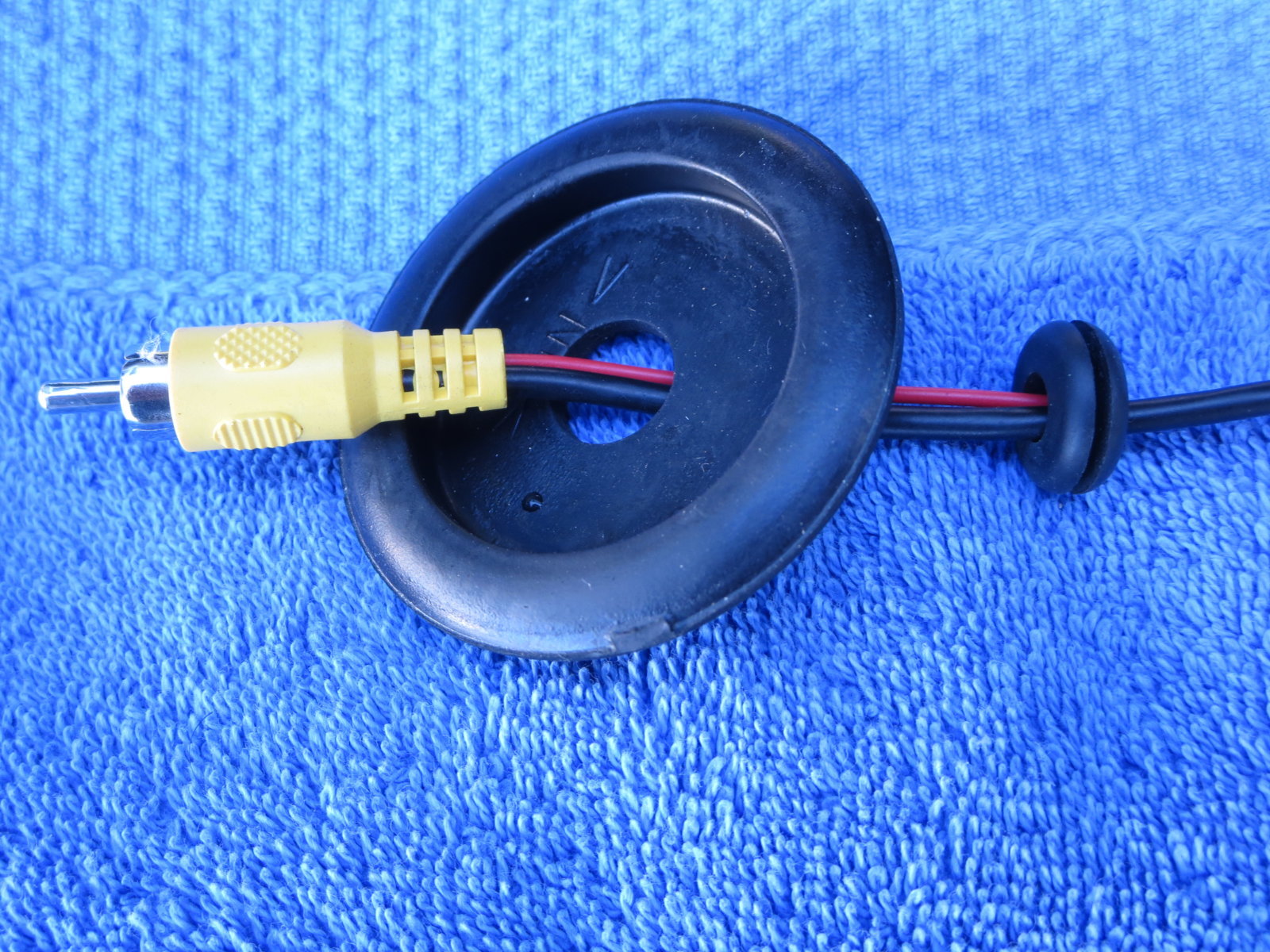

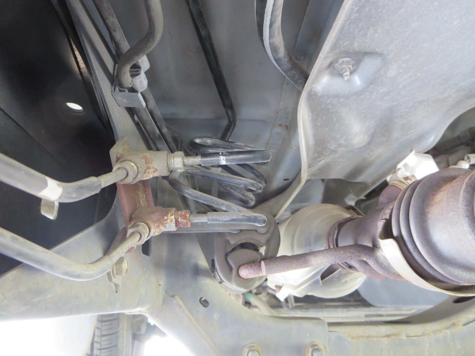

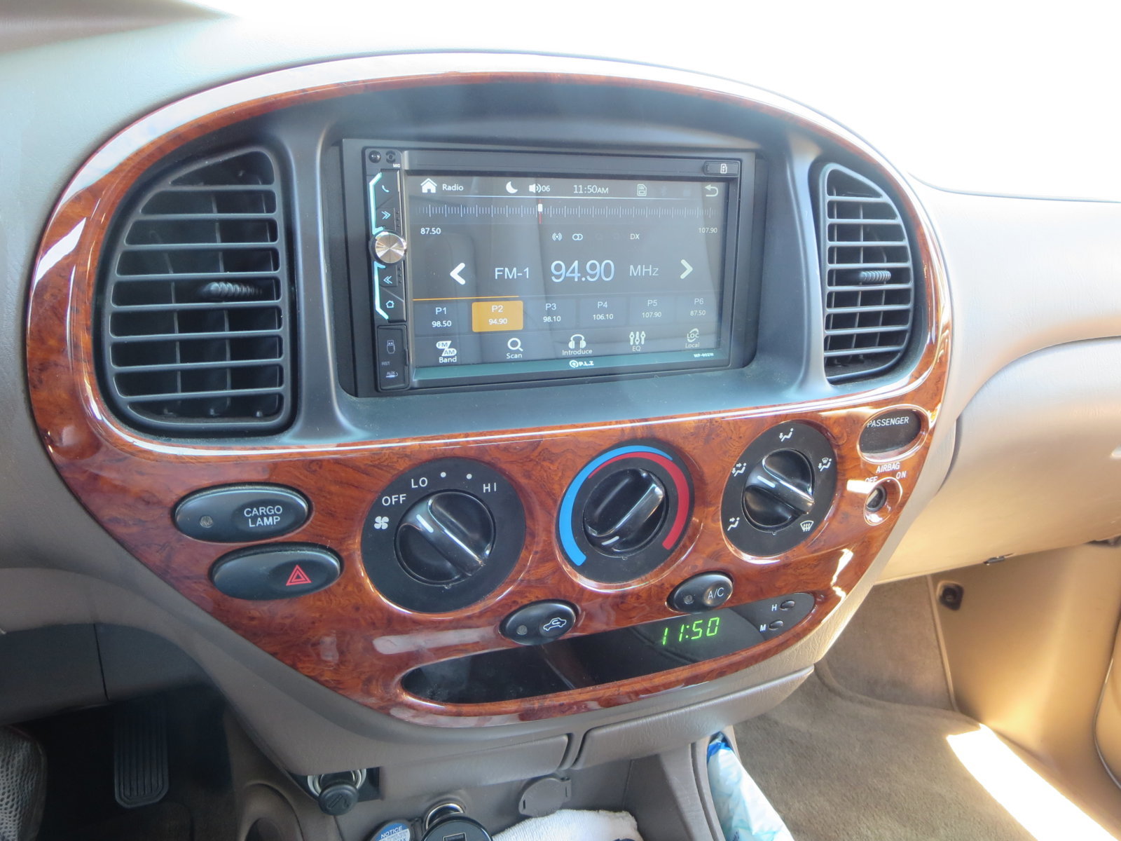

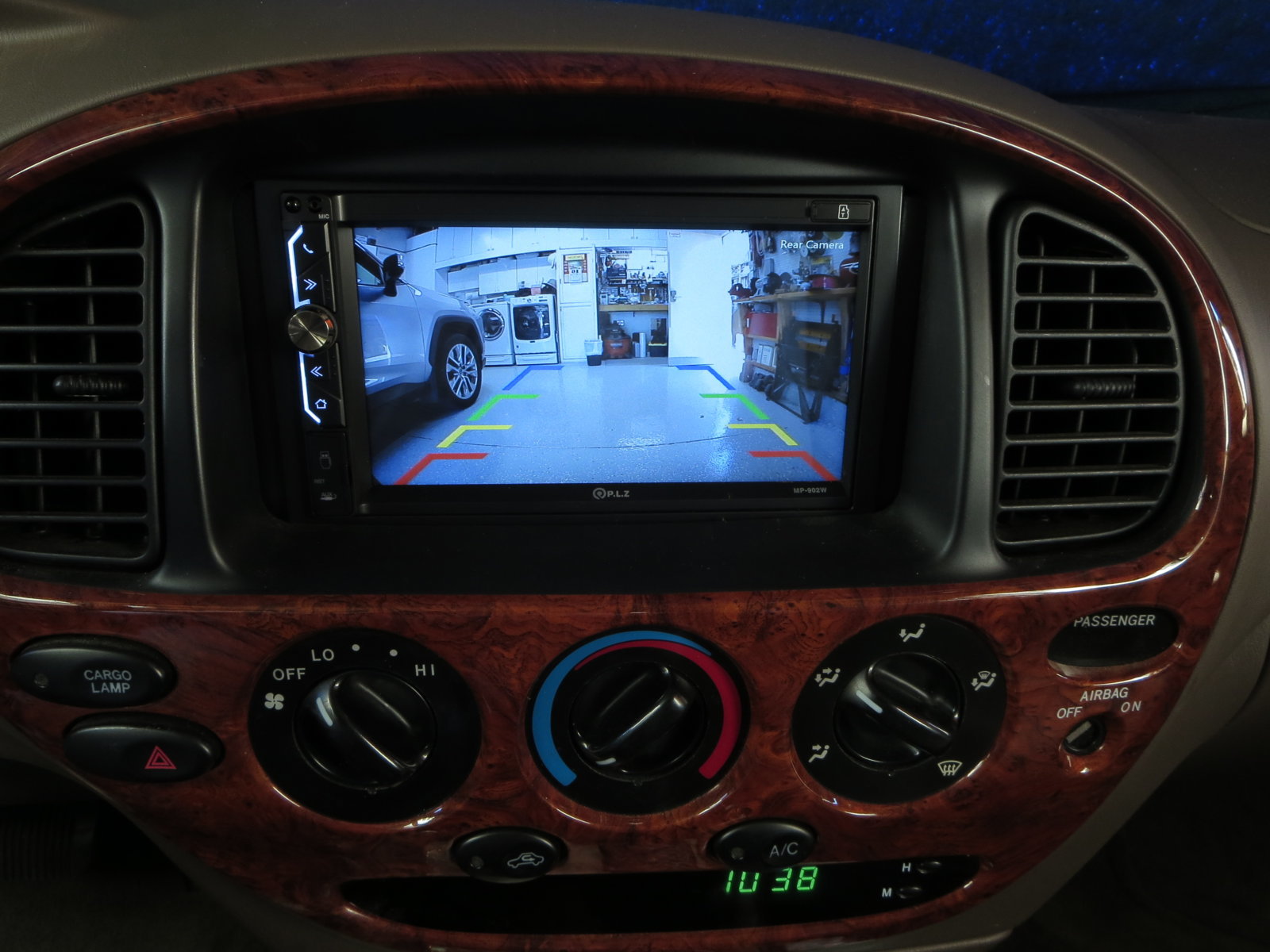

    Finished the radio swap, new unit works and fits nicely, the back up camera is great to have after 22 years. The stereo wiring diagrams from the forum links were invaluable. Was originally looking at the wrong connector (from the amp) to connect the new radio to. Brought the Metra 70-1761 which nicely connected to two harnesses previously to the (removed) amp. This two connector set is only $5 on Amazon. The Metra trim 95-8202 finished up the sides. Followed shifty's route and ran the BU cable on top of the frame to the rubber grommet, punched a 0.5" hole and added a sub grommet to finish it. The Posi-Taps are a great idea and will buy those for stock, they will come in handy. I found corrosion on the brake connections under the grommet. This surprised me as I have no corrosion anywhere except this part. It hasn't used fluid so I don't think there was a leak. Attached are some pics of the install. Thanks to the forum for the advice and resources. IMG_4330.jpg IMG_4324.jpg IMG_4316.jpg IMG_4319.jpg

    Where is the large grommet located on the truck?

    Under the carpet at the drivers and or passenger floor board

    Your stereo looks almost exactly like the Chinesium unit I just sent back to Amazon. Did you wire your steering controls? Do you have steering controls?

    I'm not familiar with Chinesium brand. Cars made in 2003 did not have steering controls. Later model cars incorporated steering SIGNALS to help the back up cameras show the car path based on the steering wheel position.
    The unit has great sound, many features, the blue tooth seamlessly connects to my phone and plays Sirius XM or car navigation maps or phone calls, USB, micro SD, and wall paper.
