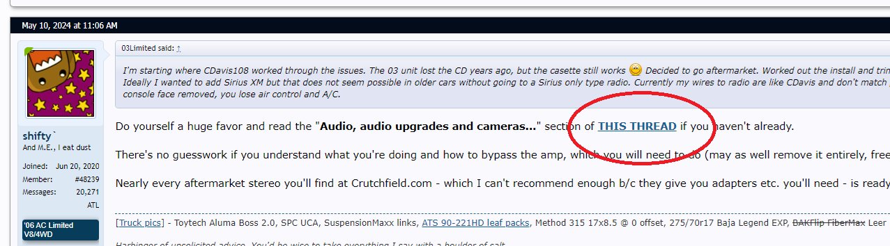

    I'm starting where CDavis108 worked through the issues. The 03 unit lost the CD years ago, but the casette still works :) Decided to go aftermarket. Worked out the install and trim nicely. Working on wiring and as pointed out may have to bypass the aplifier below the head unit. Have six speakers, a nice Toyota labeled head that weighs a LOT. Ideally I wanted to add Sirius XM but that does not seem possible in older cars without going to a Sirius only type radio. Currently my wires to radio are like CDavis and don't match posted schematics so will remove the amplifier and adapt those wires to the new head. Will know more when I get the amplifier out. Not fun driving around with the console face removed, you lose air control and A/C.

    Do yourself a huge favor and read the "Audio, audio upgrades and cameras..." section of THIS THREAD if you haven't already.
    There's no guesswork if you understand what you're doing and how to bypass the amp, which you will need to do (may as well remove it entirely, free up some space.
    Nearly every aftermarket stereo you'll find at Crutchfield.com - which I can't recommend enough b/c they give you adapters etc. you'll need - is ready for Sirius. You just need to budget in an extra $60 for this tuner.
