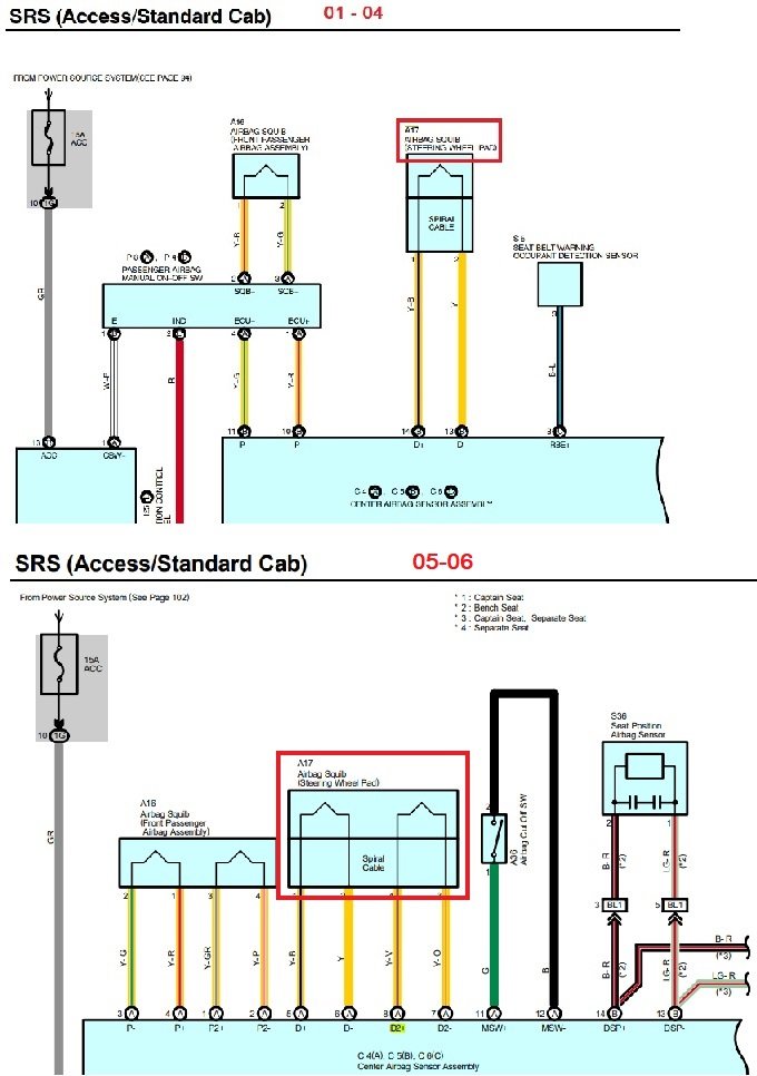

    Due to folks installing audio controls or changing steering pad, I had wondered about that ?

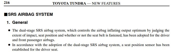

    As for 2 connector airbags, according to the 05 New Features from TIS and looking at 03-05 EWD's, dual-stage SRS airbag system did not come about until 05 year model.
    That begs the question whether for looks or adding audio controls. can one install an 05 dual stage on a single stage designed year 01-04 ?
    1st Gen Tundras New Features Chronology | Toyota Tundra Forum
    from 05 SRS Airbag System New Feature....
    from 04 05 EWD, Access, Standard....DC is the same
    A17 bottom of steering wheel area....

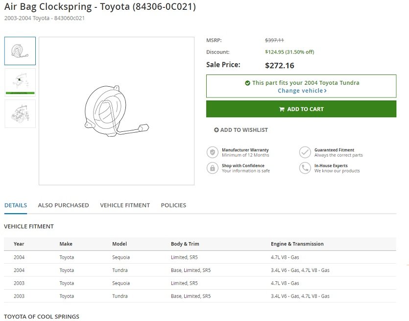

    This is the clock spring for my 04 DC, single connector with steering wheel controls. When searching for cheaper prices than dealer, notice also that number is valid for Sequoia 03-04.
    2003-2004 Toyota Air Bag Clockspring 84306-0C021 | Toyota of Cool Springs vParts

    How do people feel about OEM vs aftermarket on the clock spring? Given the airbag connector it’s not a good part to skimp on? But then again, it’s probably the same part from the same factory? Just discards or seconds or something?

    OEM, it's built to expected specs and lifetime expectancy. This is a part you're going to install and never touch again.
    Unless you're dying right now with strapped budget, why use anything except OEM in this case, knowing OEM already lasted this long so you'll likely never replace it again in this truck's lifetime, and there will never be a question in the back of your mind about compatibility?
    I would use OEM just because of all the BS "squib circuit" failure codes I've seen people post here and on other forums. Anything related to SRS, I just don't mess around with it, but if I must, I'm going with OEM, unmodified.
    My 2¢, take it or leave it.

    My thoughts too but $20-$30 vs $250-$300 is a large jump, just wanted confirmation on the value. I set up a saved search. I found a few $120 OEM used options. I think I'll maybe wait for a harvest of my OG spring and see how it compares to the one I got for free with the dual airbag outputs. I wonder how dumb it might be to try to de-pin and re-pin the OG connector for my OG airbag somehow / some way. That seems safer to me than changing the bag to a new one and/or only plugging in one connector. If I'm able to do that with the springs I have (both of which are OEM) that might be one path forward. I realize it's airbags but it's also wire and aside from resistance there isn't a whole lot of tech in a wire.
