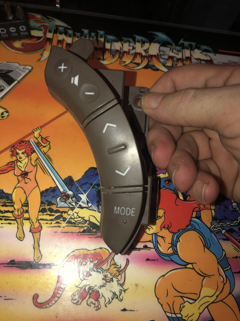

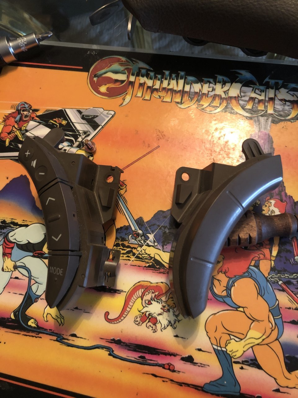

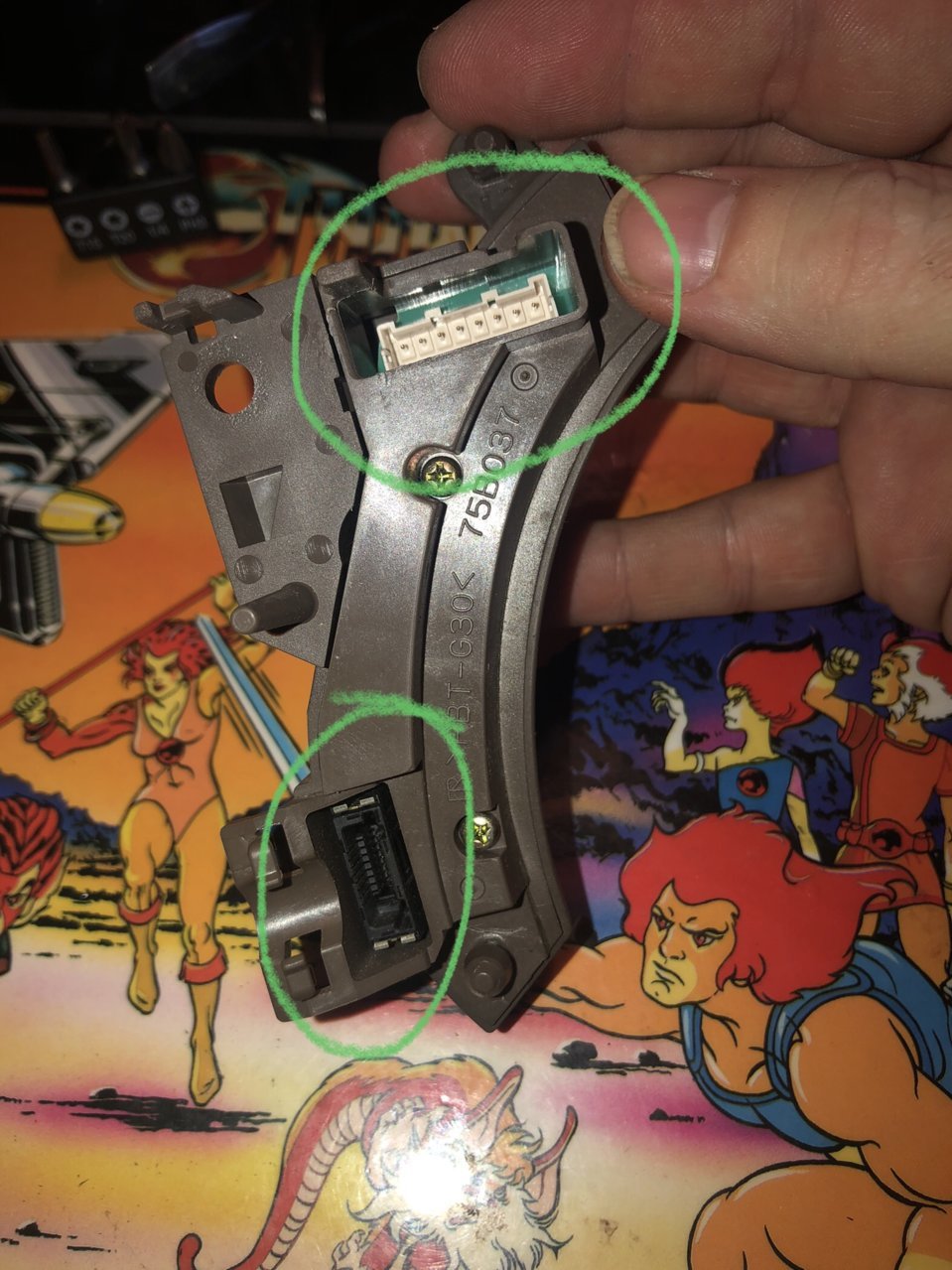

    E82E9999-3020-4396-8121-31C386C6E07C.jpg 35EB2E9A-97C0-4CB3-86E5-63FBB8CEB0F6.jpg

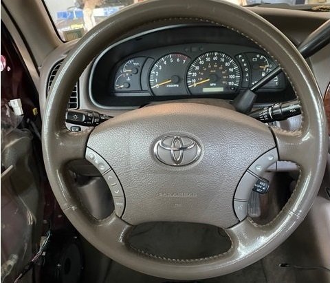

    Just gotta figure out what goes where in regards to the circled places
    #37
  8. Mar 2, 2022 at 9:10 AM
    #38
    BubbaW
    Aug 19, 2019
    #34845
    4,126
    Bubba
    Where Eagles Nest
    04 DC LTD 4X4 4.7 V8
    T150 Lover
    The black connector is a plugin for ribbon cable that goes from left controls to right side controls if you had them….for phone on/off hook

    Other side is just a dummy panel

    Oooooooh, fancy! And that’s what let’s you answer your phone with the wheel and run the call through the speakers?

    Right side control plugs into left side control via ribbon cable. Left side control plugs into clock spring. If you don’t have the harness behind the radio that @assassin10000 showed in post #4 then truck side of clock spring is not wired for controls. No big deal, just add 3 wires and pins into the plug beneath the steering wheel and run them up to your radio. I can try to take pics this weekend of how I did it or you can search my post history. I know I’ve talked about doing this before.

    I'm unclear on the question but I was able to plug my controls in behind the airbag. Lets call that the "in" side of the clock spring. On the "out" side of the clock spring lies this harness which is beneath the steering column.

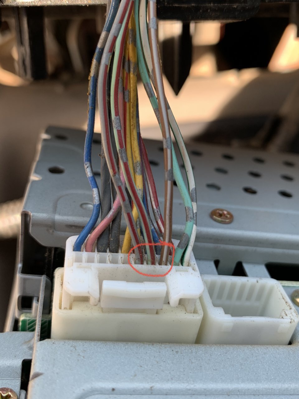

    The photo above was taken from my donor truck which was wired for SWC but my truck was not. I believe the top 3 wires on the right were empty on mine and I just pinned 3 spare wires in there and ran them to my radio. I referenced the above picture and the wiring diagram to figure out which ones were resistance and which one was the reference ground and then tied them into my ASWC.
    This is a pic from my donor truck of the harness behind the radio that does have the steering control wires. Which are the first 3 in the row closest to the camera. Wire colors are gray/red, green/red, brown/white. Reference these to the pic I posted above and you can figure out where they need to be pinned beneath the steering column.
    shifty` and daveeasa[QUOTED] like this.

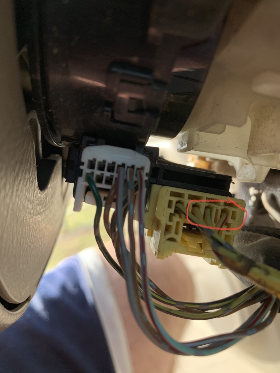

    so if I’m understanding you correctly, I am looking for the circled 3 wires on each end?
    F4DB25FA-F973-4310-B16D-BC8C92507A1F.jpg 87121393-6907-4F4F-BB6A-F33F6E7F6026.jpg
    (I circled your photo’s)
    so if I take off my column shroud I should have access to the first photo and then it’s just a matter of checking the radio side for the sake of due diligence, correct?
    and if I have those 3 then I’m pre-wired for radio controls?
    and from there, the right side (Rabbit Hole) is a different side quest, correct?

    In that first photo, you have the wrong harness circled. The wires listed are in the white harness to the left. Yellow=airbag=not gonna have a good time. Do not meter or test light those wires whatever you do.
    The right side controls transmit through the exact same 3 wires so if you have left side controls, right side controls are a breeze.

    Wrong on the yellow connector. Yellow connectors are often airbag-related in most modern computer-controlled vehicles. Never dick around with those.

    Might go down a little rabbit hole here but a quick lesson on the way these buttons work. They are based on resistance unlike most newer vehicles that use data, or a canbus system.
    Let’s say for example you press volume up. That button has a unique resistor between it and ground that is for example sake let say, 1000 ohms. Volume down, 500 ohms. Track up, 760 ohms. Etc… Each button has a unique resistance.
    Factory radios are built and programmed to where when they receive those arbitrary resistances, they perform a command associated with each unique resistance.
    If you are doing an aftermarket radio you will need some type of interface module, (ASWC, PESWIPS, etc…) that learns these resistances based on button presses and then outputs a different command to whichever radio type you program them to work with.
    I don’t understand why Toyota uses 3 wires when they could just use 2 but they do. I used to have this wiring diagram laying around but I am on my phone right now. I think volume up/down and track up/down transmit resistance on one wire and the mode/right side controls transmit on the other wire. The third wire you will connect to chassis ground and that is what completes the circuit and gives you the arbitrary resistances.
