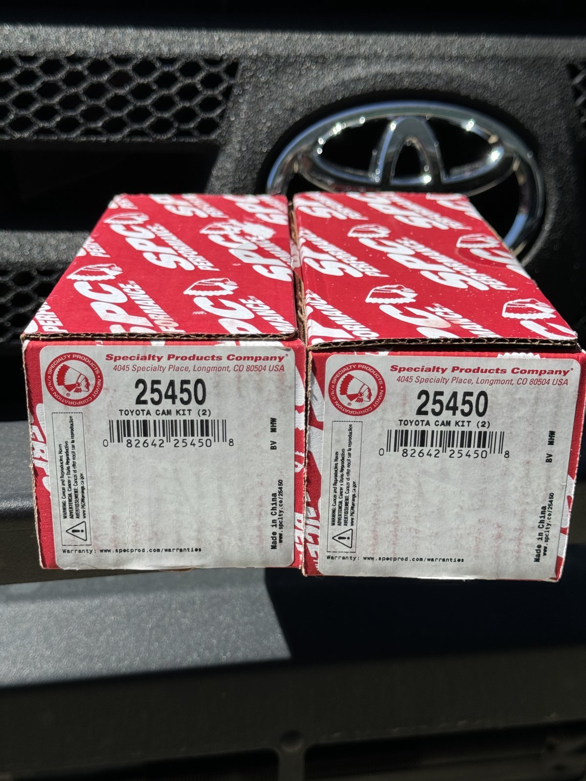

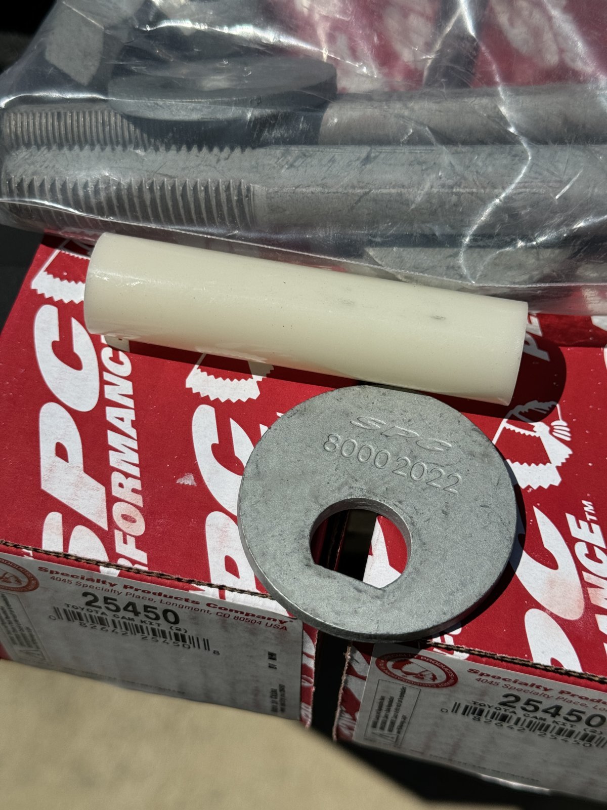

  23. Mar 19, 2024 at 1:11 PM
    #53
    TundraDude772
    TundraDude772 Shake N’ Bake, Ricky Bobby
    Apr 8, 2018
    #14307
    104
    Eric
    FL
    2010 & 2020 SR5
    2010 SR5 CrewMax Silver Sky Metallic 7” BDS/Fox 17x8.5 Method MR705 40x13.50 Toyo M/T Transfer Flow 46 gallon ICI Magnum front bumper PML Transmission Pan Hooke Road 18” bed rack Nature Nest Hard-Shell RTT Ironman 4x4 awning Coachbuilder upgrades SuperPro LCA Bushings Total Chaos UCA’s Energy rack bushings Moog LCA Cams 2020 SR5 Double Cab Voodoo Blue 40/20/40 Front Bench TRD Pro Grille TRD Pro headlights 17x9 Vision 351 285/70 Toyo A/T3 PML Transmission Pan RCI Skidplates eBay bumpers TRD rear sway bar
    I see in post #1 OP shows the Mevotechs being made in the US, and that they are similar to the SPC’s. I bought SPC’s from autozone but noticed they said made in China, bummer. The washers look the same, and both come with the same plastic sleeves. So I’m not sure what changed. Maybe where the bolts are manufactured?
    I priced out all new OEM hardware and it was about $200 to complete both sides, so about double what I paid for the SPC kits. Not really sure which route to go, I have more confidence in the OEM parts; so that’s probably what I’ll do.

  25. Mar 20, 2024 at 4:08 PM
    #55
    TundraDude772
    Apr 8, 2018
    #14307
    104
    Eric
    FL
    2010 & 2020 SR5
    Good looking out, those look like they’ll handle the higher torque specs better than the plastic bushings on the SPC. I just ordered a set of 2 from Amazon, I’ll compare them to the SPC’s I have and post some pics.
    Luckily I’m nowhere near the rust belt, but I’ll take every advantage I can get when it comes to rust prevention.
