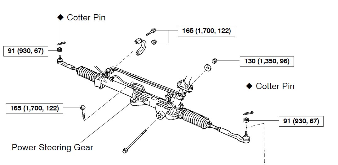

    What are the torque specs for the steering rack nuts and bolts for a 2004 SR5 2WD v8 4.7 tundra?

    Let me know if you can read this since it's a screenshot on my phone.

    I'm having trouble finding out the part numbers for the bolts and nuts for the steering rack. Can someone help me with this? Thanks!

    Welcome aboard @Marcus5327! These part numbers and diagram should help you out. Pretty sure they should be the same for all 2000-2006, but enter your VIN when you order and the dealer will be able to confirm.
    Passenger side mount:
    • 90080-10184 - Flange Bolt
    • 90080-11402 - Stud Bolt
    • 90179-14061 - Nut (for stud bolt)
    Center mount:
    • 90080-11341 - Bolt
    Driver side mount:
    • 90080-10188 - Flange Bolt
    • 90201-16033 - Washer
    • 90178-10033 - Nut
    https://parts.toyota.com/a/69361363__6708584/FRONT-STEERING-GEAR--LINK/841420-4505.html

    This is for my 02 Tundra, best to check your FSM.
