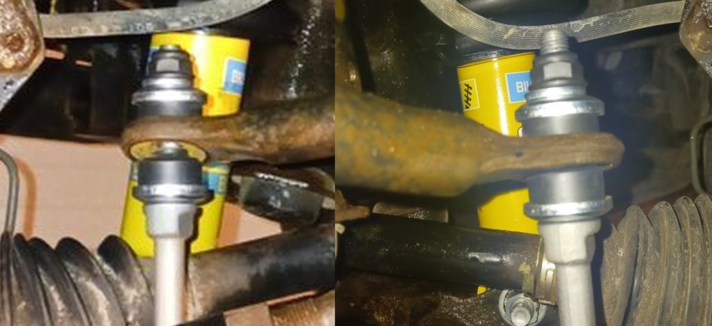

    You're too nice. One side is properly tightened, nicely but on the verge of too much. The other side is definitely not. Right is right. Left is wrong. Note the # of threads at the top of each.

    Just kidding :)! Great advice, and good catch from @BubbaW and @shifty`. I'm pretty sure I just posted one photo (on the left) from before I set the truck back on the ground and properly tightened both. I will take a look just to make sure I didn't forget one, but I'm pretty sure I got them both after lowering - just posted one photo before and one after. Thanks for the visual check-over of my work folks!

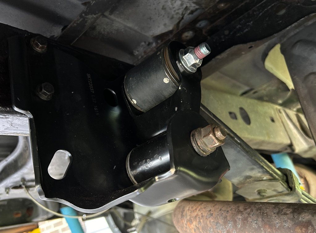

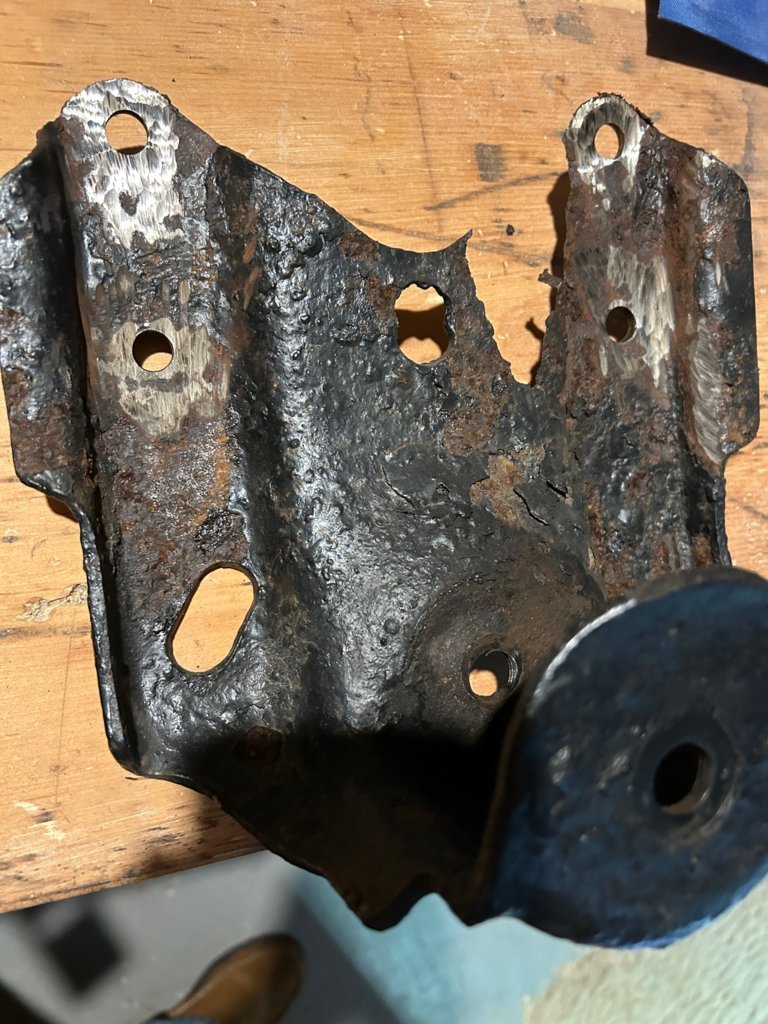

    When this happened to me it turned out to be rusty hanger brackets...when the shackles would move as a result of the springs flexing they would rub against big clods of rust, telegraphing a loud "clunk" along the chassis. I figured it had to be bushings, but only discovered the problem when I pulled off the springs/shackles for replacement. Can't really see inside the old bracket so well in the picture, so you'll just have to take my word for it. So now I have new springs, shackles, AND hanger brackets!
    New brackets are relatively cheap, but a world class pain in the ass to install! Pro tip - do both sides while you're at it.
