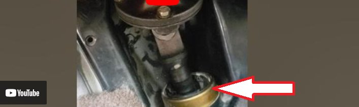

    You need to replace your steering shaft seal if you haven't already. That thing is wrecked. It's a cheap part, and there's a sticky thread at the top of the 1st Gen forum showing the p/n and process.

    No, I mean your steering shaft seal is absolutley fucked, rubber is totally blown out, and it introduces road/engine noise, potentially water, and smells. See pic below.
    Totally normal in these trucks, it's one of a laundry list of common issues covered in the community megathread. More specific details on the seal issue and replacement here: https://www.tundras.com/threads/diy-steering-shaft-seal.48664/

    Not my video but helped me fix my issue after steering rack bushing replacement and total flush & clean of power steering system.
