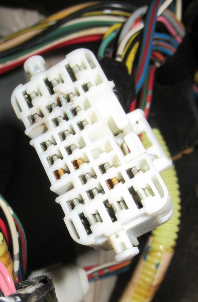

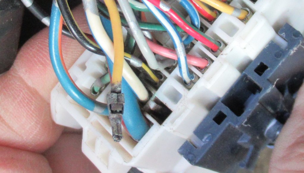

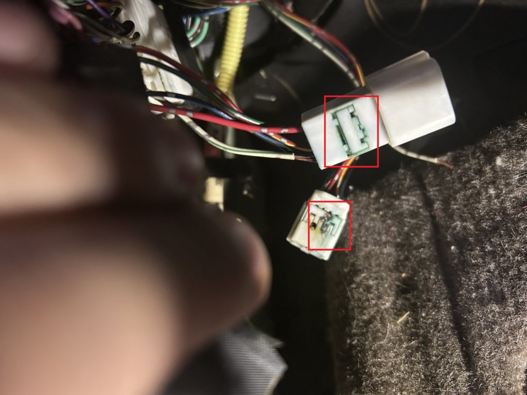

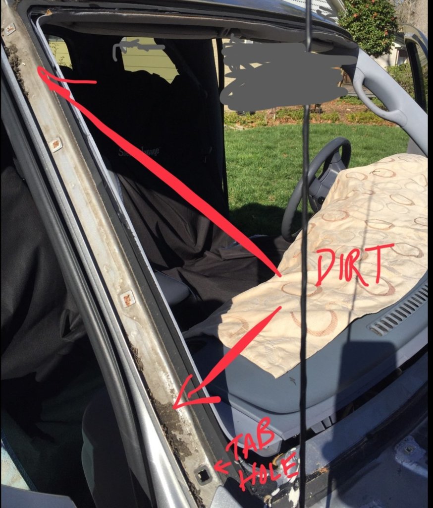

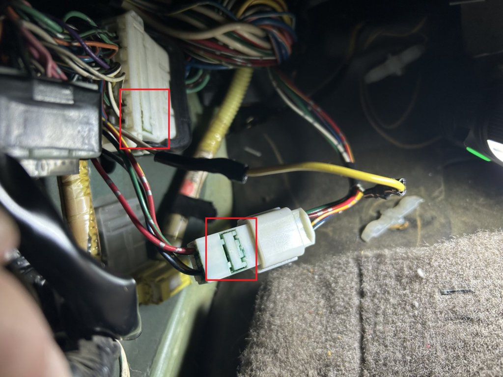

    • These trucks usually don't have a ton of other electrical issues. Hidden corrosion inside the battery/alt cables happens. Sometimes, a couple thousand miles after timing belt changes, people will have startup issues because the crank position sensor wasn't properly tucked away and gets rubbed by a belt (pic), correct routing info here. There's also a similar problem with camshaft position sensor under the cam cover, where the belt will rub through (pics). There's the rodent issues mentioned earlier. Occasionally, water trails down harnesses into the ECM behind the glovebox (pics, pics), or the in-dash fusebox (pics & pics & pics) it happens a LOT. Many drain/vampire issues trace back to aftermarket add-ons whether the owner knows they exist or not - alarms as mentioned earlier, brake controllers, poorly installed trailer receptacles, those are some big ones.
    While I'm tempted to believe you have a short in your ignition is the culprit, pay specal attention to the bolded fusebox bit up there, since it's hit so many people over the years, it's why we have so many pics of cases to share. I'd rule out water intrusion, especially if you're the kind of person who doesn't think it's important to fix cracked windshields, or if you've been victimized by the shit work Safelite is known to deliver.

    Yes. Remove. Unplug connectors. Look for green traces as shown in the pics.

    Mine started in the on position as well, right after a bad windshield install... Never saw any water, but once it dried up, no more issues. I got a new windshield correctly installed afterward.
