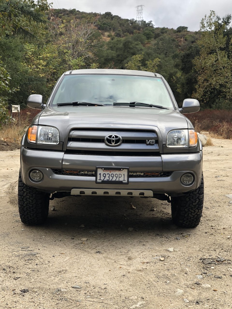

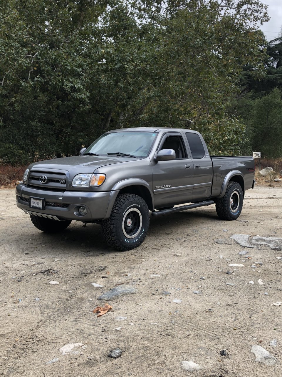

  24. Nov 7, 2020 at 1:58 PM
    #84
    Voss
    Voss [OP] Not a new member
    Feb 28, 2019
    #26833
    1,650
    2003 AC TRD 4x4
    Tires on, pics below. Thanks again to everyone for all your help!

  25. Nov 7, 2020 at 2:04 PM
    #85
    torino69
    torino69 The old guy
    Aug 27, 2020
    #51423
    21
    West Fargo, North Dakota
    2004 Toyota Tundra Limited
    None worth mentioning
    Nice looking Tundra.
    Voss[OP] likes this.
  26. Nov 7, 2020 at 2:06 PM
    #86
    FirstGenVol
    Dec 13, 2018
    #22934
    14,316
    East TN
    2002 AC TRD 4x4 V8
    Looks great!

  28. Nov 7, 2020 at 2:54 PM
    #88
    Darkness
    Darkness Allergic to white
    Jul 23, 2018
    #17315
    9,976
    Luis
    All over SoCal
    The darkest
    It's really dark
    Looking DAMN good! Those are my favorite Toyota wheels, great choice.
