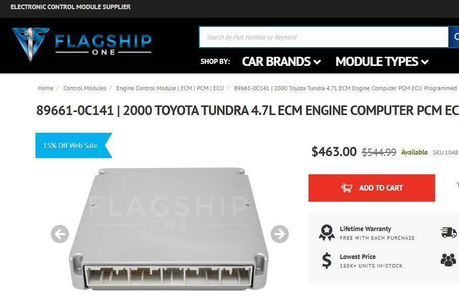

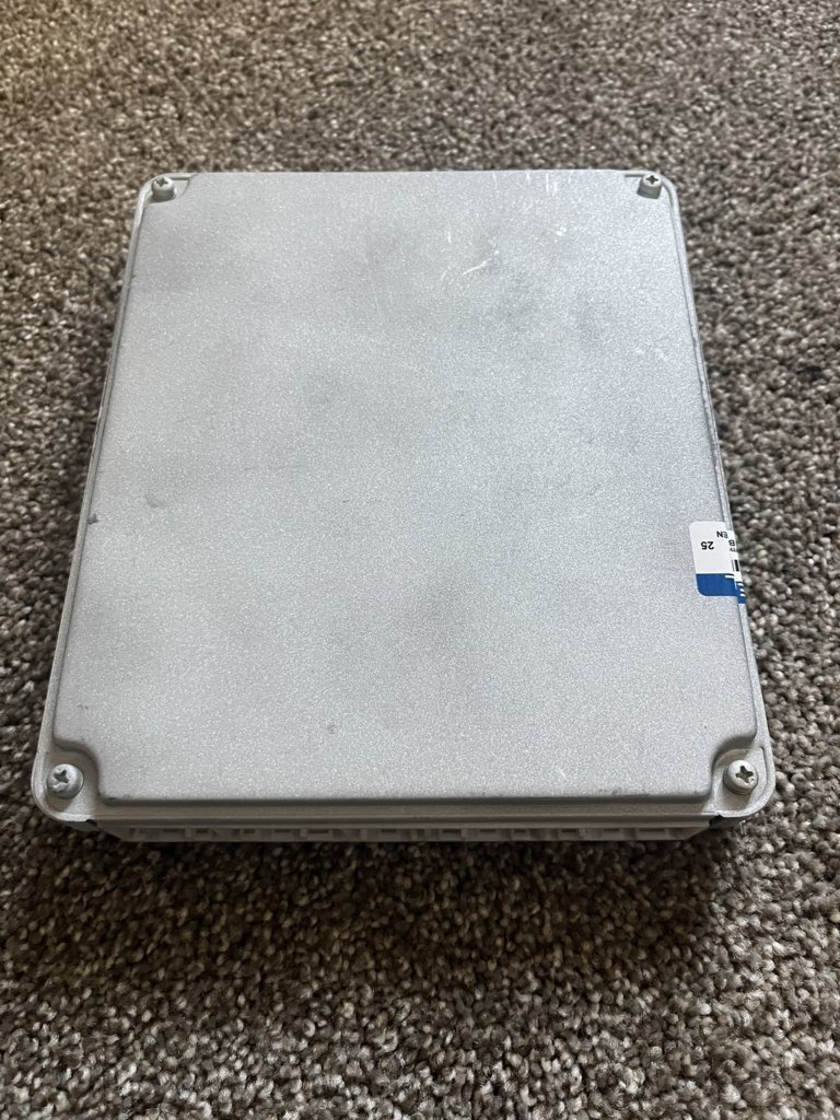

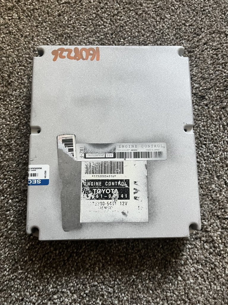

    I ordered an ecm from Flagship 1. It showed up with the sticker mostly faded away and the whole unit has been sandblasted. How do I know? Because the screws that hold the cover on are normally zinc plated with a gold appearance. These ones are not. And there is a section of the unit that is not sandblasted because a sticker or tape was covering it. Would you install this? Flagship 1 has been nothing but unhelpful on the phone, asking me over and over if I installed it and if it's working. I told them I don't trust it based on its appearance and based on the fact it's been sandblasted. Like why?

    I personally would trust it either, especially if I payed as much as it says it cost. That thing would be back in mail PDQ.
