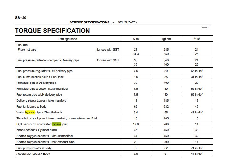

    ok, sorry to bother you. already spent hours looking through this manual with no luck. got them on 13lbs. Broke off starter bolt at 29lbs, been waiting for a week for bolts from local dealership. Just nervous about these old bolts. Thought might get a little info here. Thanks anyway.

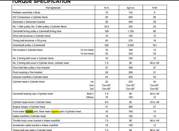

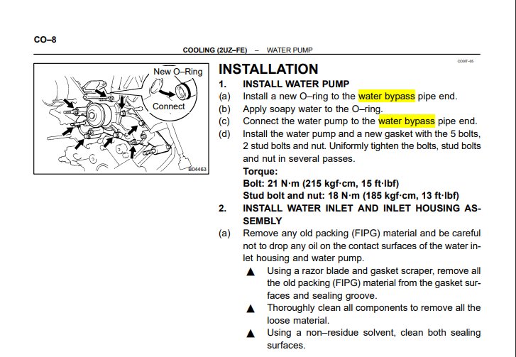

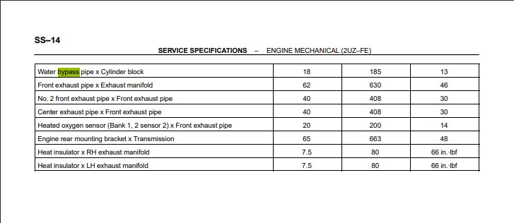

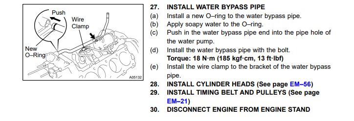

    The shitty part about searching the FSM is that you must know what the manufacturer calls a part. For example, "coolant crossover" turns up nothing. Whereas "water bypass" will give you some answers.
