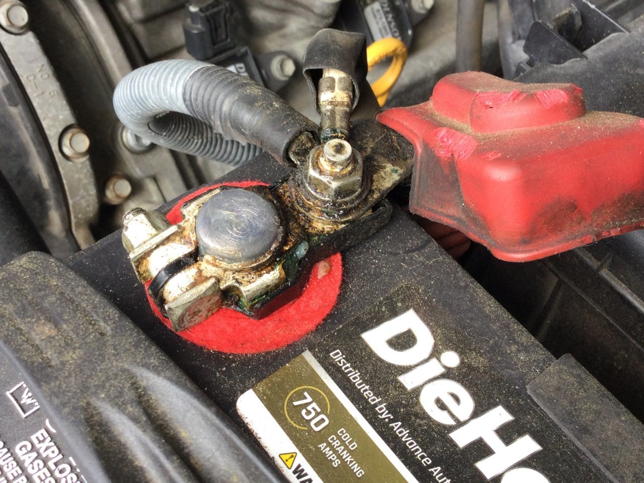

    It was one of these two bolts
    Color is funky cuz I was using an LED flashlight, but you can see where they’re at

    @RUSTYNUTS - that’s an aftermarket battery terminal and some wonky wiring. I would get a crimper and some nice lugs and them use a marine style terminal

    Other than what I described, I don't know anything further. I bought a replacement at Autozone and replaced the entire unit.

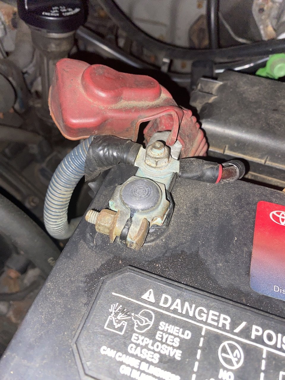

    This is an OEM FGT. Unmolested except for squirrel chewing on the cover

    Oooh here's what my '06 looks like. I've been seriously contemplating getting rid of this wingnut for a standard nut. I hate wingnuts on important stuff for the exact reason @des2mtn mentioned somewhere around here. I don't think what I've got here on top is OEM.

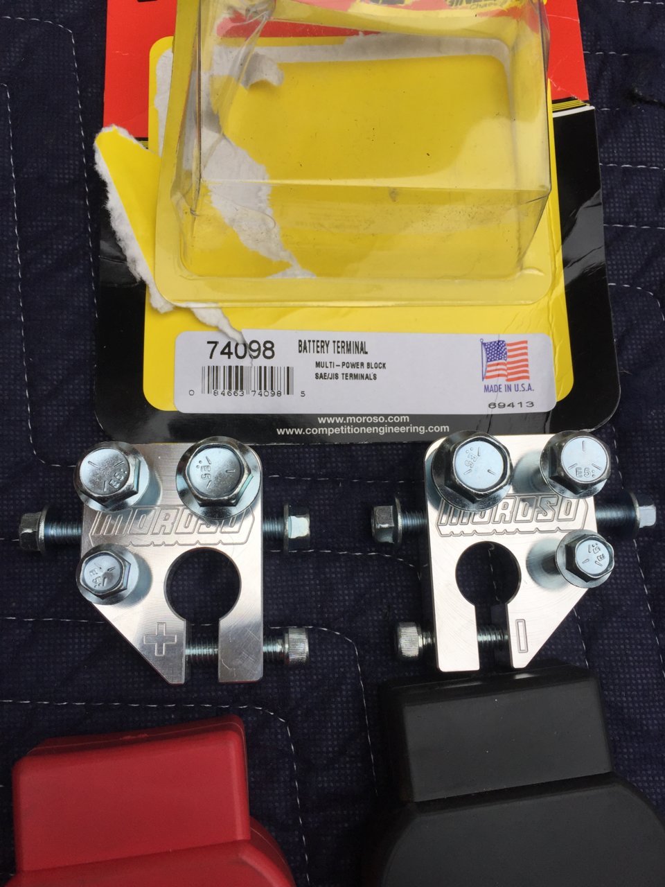

    6D209092-FE64-4993-985A-9D18ADDB7555.jpg Purchased these from Summit …….have worked very well so far

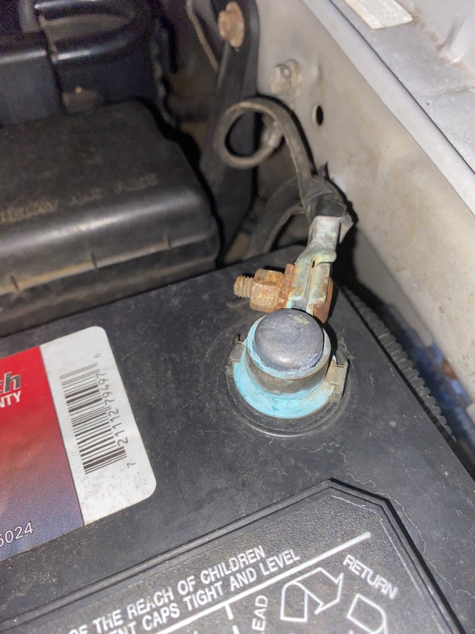

    I just looked my shit up, the boot has never fit right on it. Now I see why. Original p/n is 90982-05054
    Looks nothing like mine. I never thought to question it, but always thought it looked out of place:

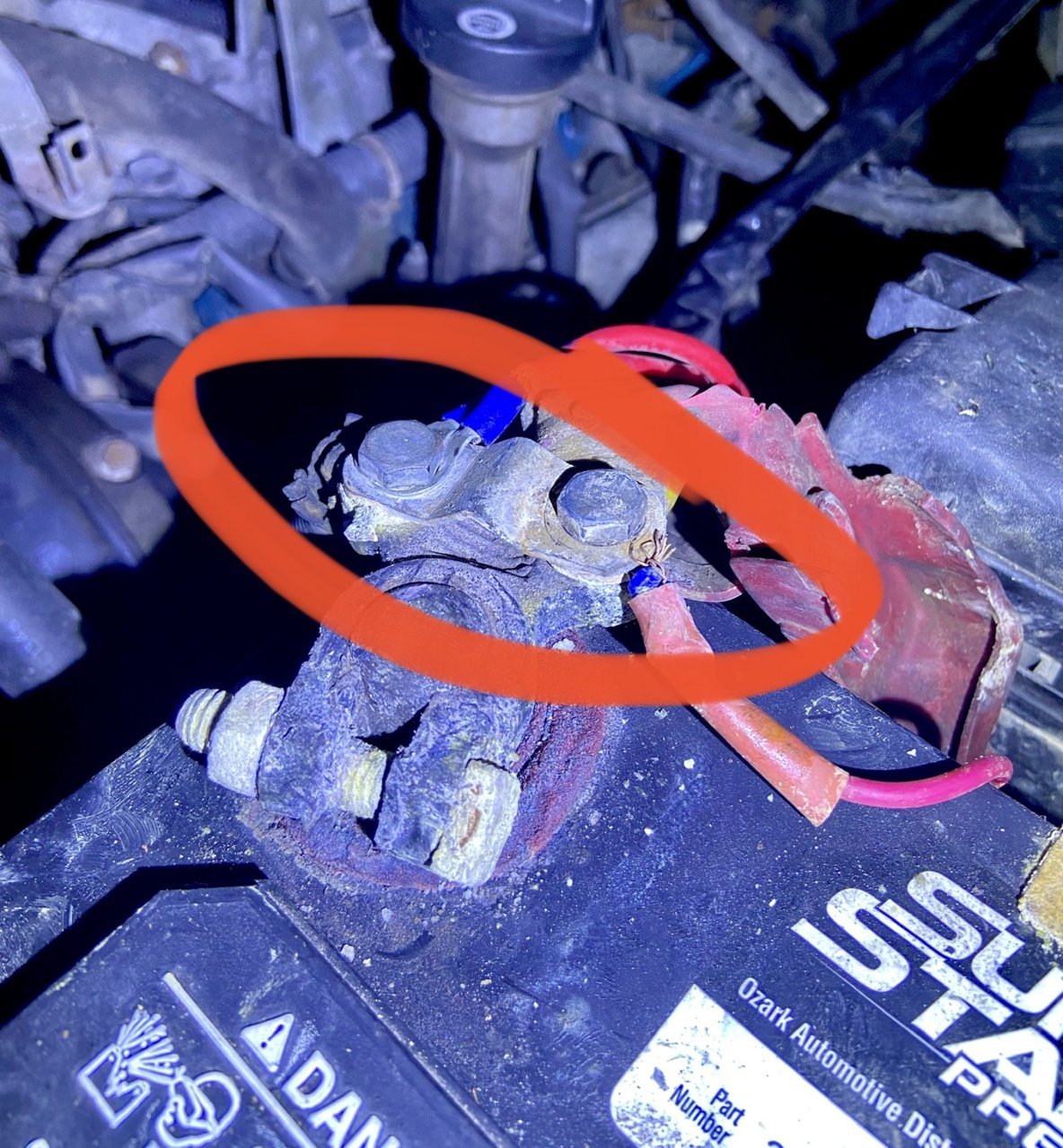

    I just had the same problem happen to me, yesterday. So, I followed your suggestion....only, now it just clicks a half-dozen times (instead of just one time) but does not kick over. '05 Tundra 4.7l, 100k mis.
    Original bat. cable clamps seem to be in good shape. I also put a thin film of dielectric grease on the terminals. Maybe I didn't clean 'em as well as I thought. Any thoughts?

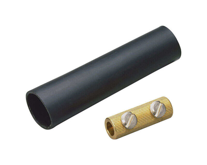

    @metalpete - if your large gauge wire is too short, you can repair with something like this
