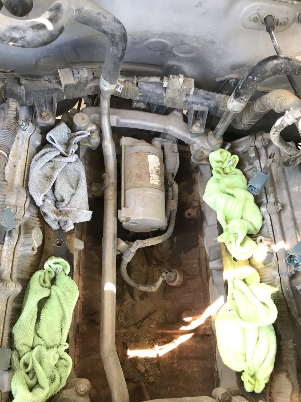

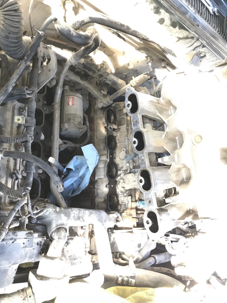

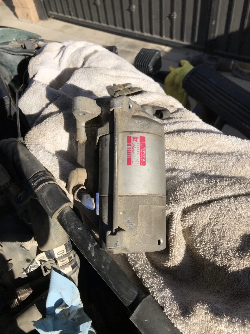

    Hey guys,
    Just pulled my starter out. (That was stupid. I hope that engineer has long since been buried.) And before I buy a new one, I assume OE is the way to go? Straight from my Toyota dealer? ALSO, please see picture...I broke a plug off and now will have to try and pull this sensor out of the block..hoping someone can refer me to which sensor this is.
    Thanks for your time!

    Knock sensor?
    Also, denso from rockauto is the way to go
    N84434, FirstGenVol and shifty` like this.

    Oh and yes, pretty sure that's knock sensor bank 2, an the other is knock sensor on bank 1, on the right. May as well replace them both while in there, with hopes you won't need to open this up again.
    Rats seem to love chewing on those bastards.

    There was two versions.
    DENSO 2800282 Reman Info 1.4 kW; w/o Cold Spec
    DENSO 2800233 Reman Info 2.0 kW; w/ Cold Spec
    Here's an NTK knock sensor from RockAuto. I personally would go with OEM on those sensors. Either starter above is fine.

    It’s actually not a bad design to keep it away from the road salt on the underside of the block. It helps to prolong its life unless you like to wash the engine block and let the water pool around the contacts but that’s a different discussion.
    Downside unlike a lower block mounting, it’s a huge PIA to remove and replace.

    If you had click of death just replace the solenoid contacts. The motors are bullet proof. Also buy new connectecters from Toyota and rep in the wires - do not buy aftermarket pig tails

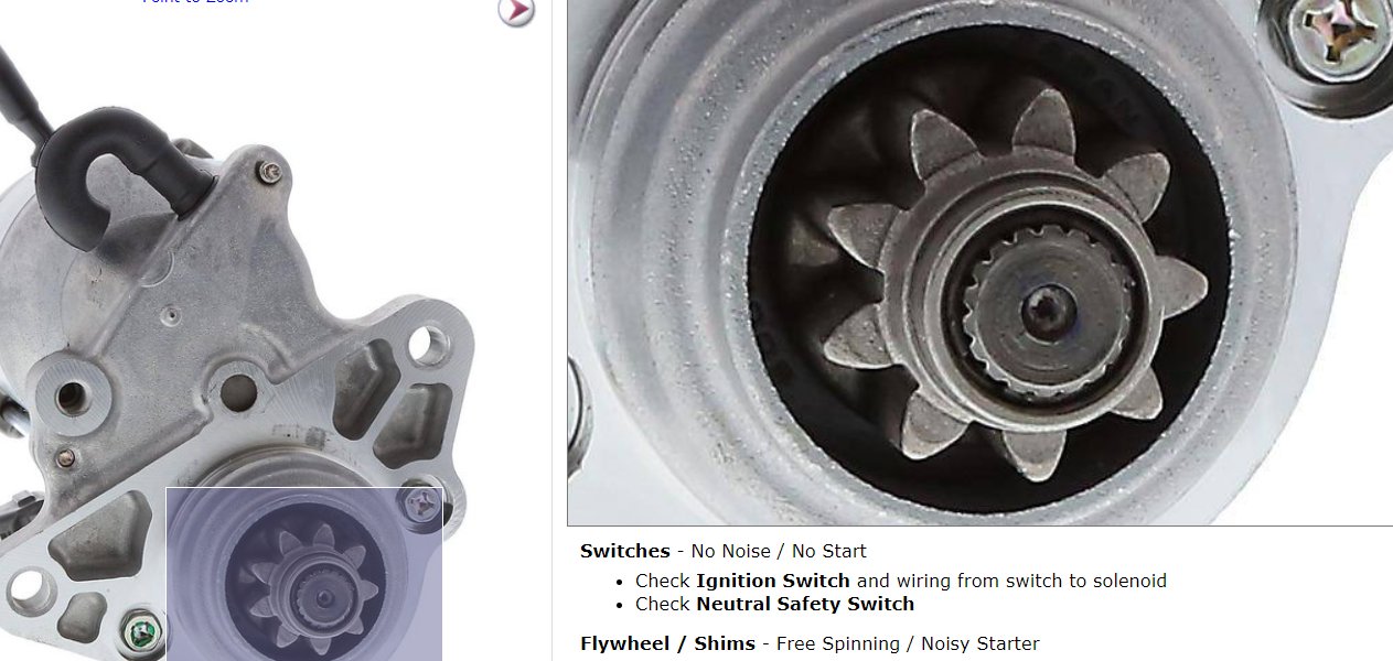

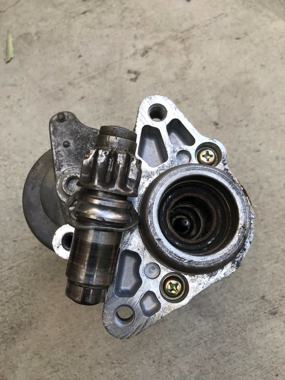

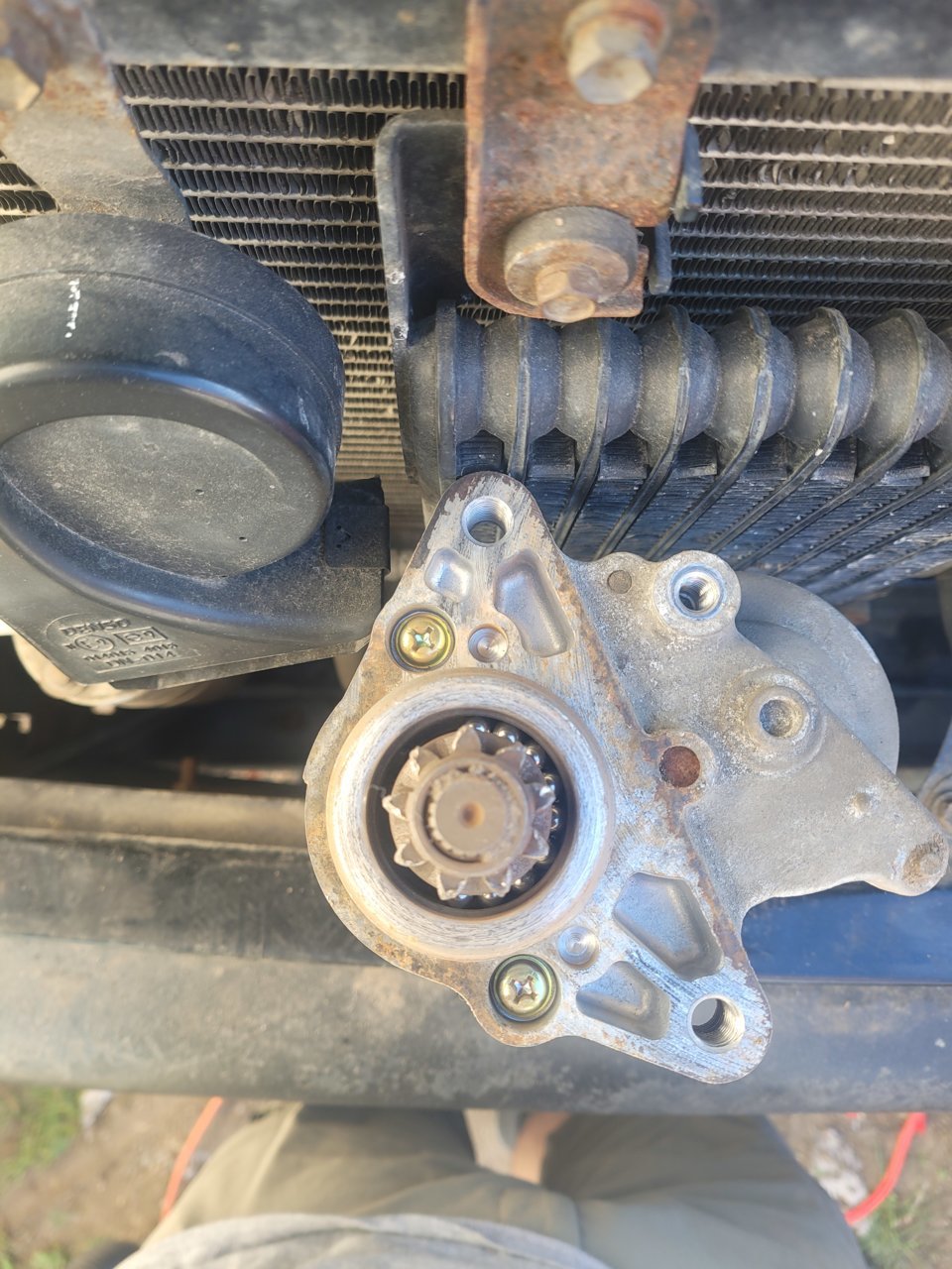

    My starter for fun. Pretty sure the gears aren't suppose to be rounded off like that...and the ball bearings are supposed to go all the way around the shaft, haha 20221012_151738.jpg

    I'm just curious where the extra half dozen bearings went :rofl:

    I was too...than I figured I'm better off not knowing :notsure:

    They fell into the block? Yikes!

    I would think more the bellhousing of the transmission ? Maybe worked their way out through an Inspection port. Some where in the woods. Highway?

    Pretty sure those teeth are supposed to look like this...

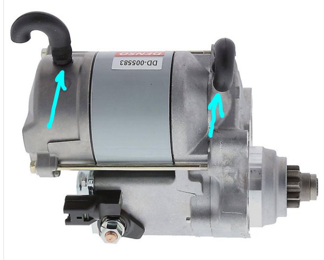

    What the fuck are those "hoses" for on the RA starter? @tyler-brown... you got any wisdom on that? These? Vents???

    I do believe you are correct sir. I wouldn't be surprised if my excessive cranking on the motor during my last trial and error with the Yota (When I needed to replace to ECU) caused this wear, and failure of the starter. Also. It was just it's time.
    And I ain't got any wisdom on nothing haha. Mine does have the hoses. I suppose for a 30$ core that I won't even use going through rockauto as shipping would be more than that. I could break it open and see what the heck

    My guess is probably "filtered" breathers to help keep the windings on that little motor cool. Just a hunch though. Pop-er open!!

    I don't think you are missing balls....its the bearing cage that you're missing, which keeps the balls equally spaced out in the race. Sometimes they are made from nylon, although usually they are steel.

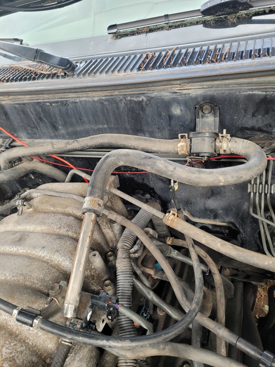

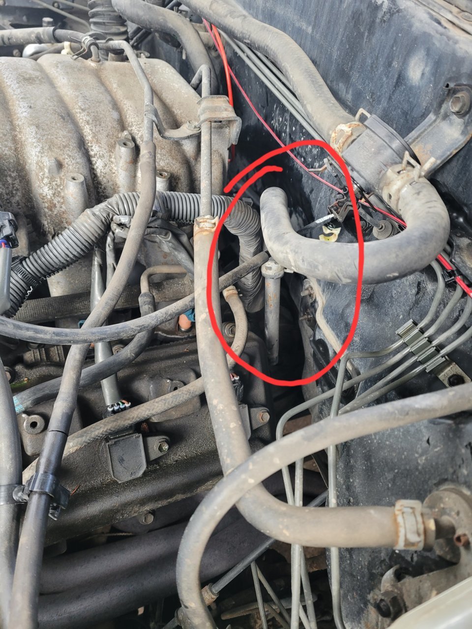

    One more question!
    How does this fit back into the block?
    Just a press fit? Tap with a hammer? Is there supposed to be an o-ring on it? 20221027_123115.jpg

    I don't believe thst is made to come out, the metal portion at least. It's part of the rear coolant cross over and is not a replaceable part unless you get the entire cross over. I'm sure it can be rigged to be put back in though. Just be sure to check periodically for coolant leal in thst area.

    I had something similar happen on the V6 with a valve cover purge hose. I JBwelded it back in place instead of changing the whole valve cover out.
