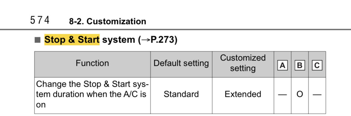

    Can anyone tell me how to get into the menu for the start stop? Not the menu that lets you change from standard to extended. I'm talking about the menu were you can change the duration and like 2-3 other settings about the start stop. I got to this menu by accident and I should have taking a picture of it because I can't get back to it now. Someone on here has to know which one I'm referring to.
  9. Apr 15, 2022 at 10:14 AM
    #39
    xc_tc
    xc_tc New Member
    Dec 28, 2021
    #72329
    895
    You can only change to and from extended. There is a stop start information display but you can’t change any settings there.
