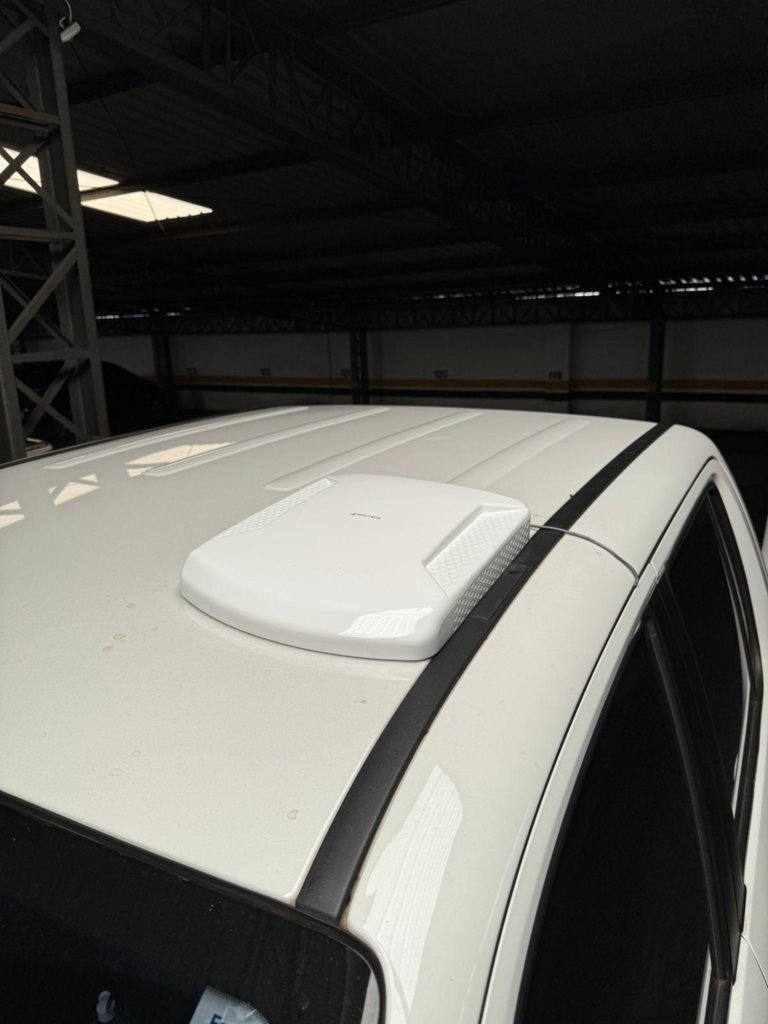

    How about this magnetic setup?

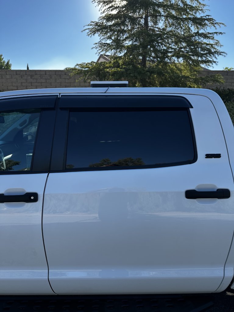

    There's room behind the moonroof on my crewmax to fit the Mini.. It's close, but it fits with the Trio flat mount

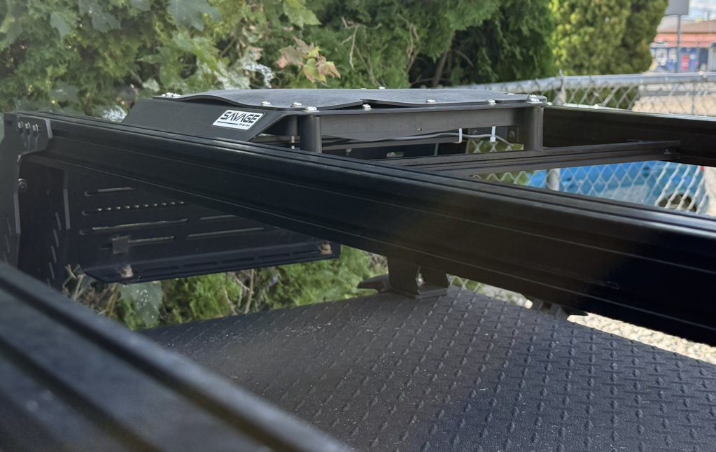

    I mounted mine to an UpTop Overland Rack using extrusion bars the Savage mount and several types of tamper resistant bolts. I power it while driving using the outlet in the bed and have a small Jackery with a solar panel when parked for work, tailgating and camping. Unfortunately the Savage hail cover has started to warpIMG_3779.jpg IMG_3780.jpg IMG_3781.jpg

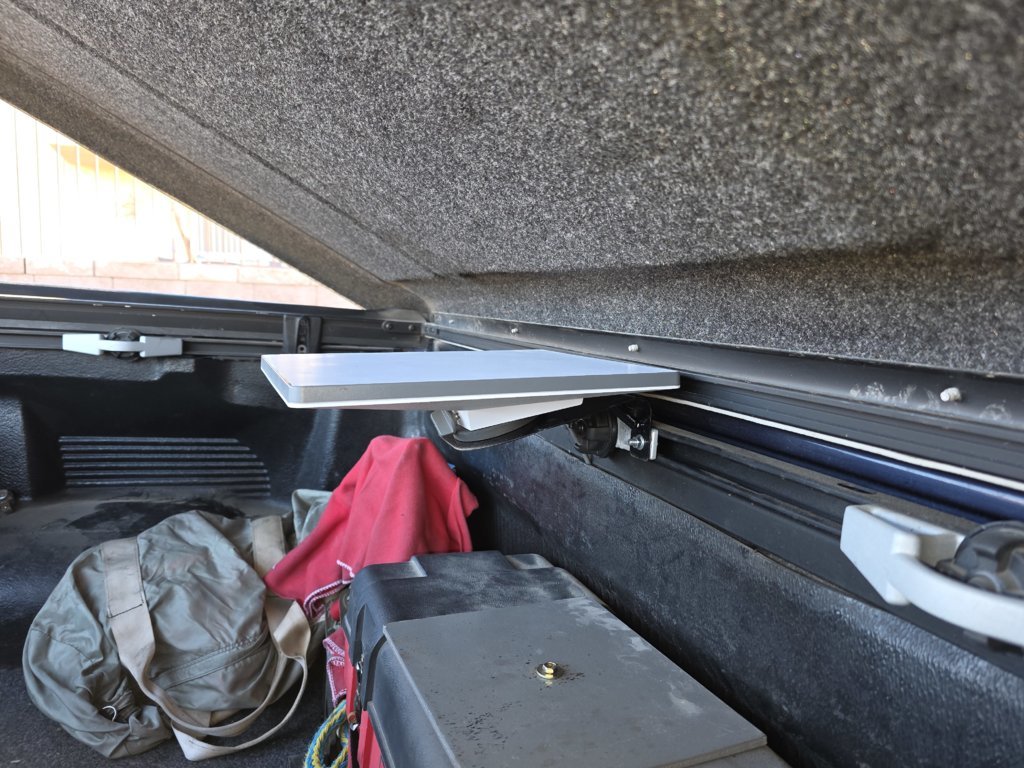

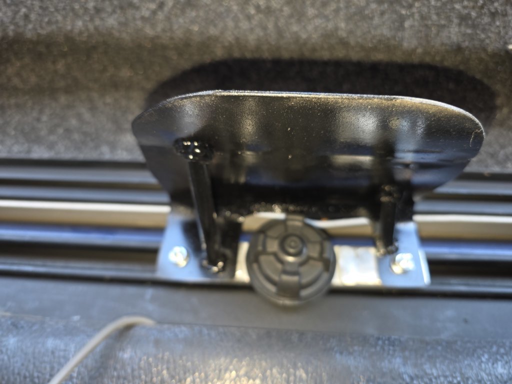

    Here's the rough draft version...
    Works like a champ with the magnet, and if the magnet doesn't work, I can bolt it to the plate if needed..
    Clears the bed cover by about 2".
    The cab doesn't seem to block the signal, my radio and phone both hooked up right away..
    You can put it in the bed anywhere as long as you have enough wire.
