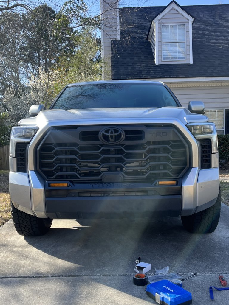

    Finally got my Amber SS6’s installed yesterday. Had them sitting around for three months and finally had the opportunity.
