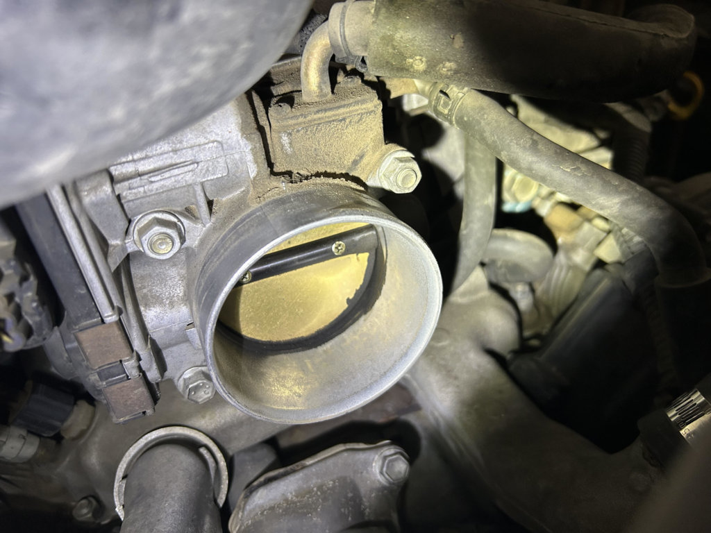

    Little update, was able to get the truck idling after holding the accelerator to around 8-1k rpms on startup for about a minute. I let it run until all temps were up and it didn't die which is good. I saw a similar video relating to my symptoms and this made me check the throttle body. Does this look bad? I plan on buying throttle body cleaner and just cleaning as much as possible without completely taking it off, and hopefully that will help.

    Yeah, that throttle body is pretty gross. I don't think that the dirty throttle body would cause a no-start situation, but it'll definitely effect your idle quality and MPGs.
    Make sure you don't spray the cleaner directly onto the throttle body. Spray it on a rag and then wipe it on. Might take a few minutes of scrubbing to clean off all that gunk.

    I would suggest CRC throttle body cleaner and once you undo battery for about 10-30 min, once hooked back up the ECU will then go thru a re-learn process.
    In fact, if you did not unhook battery after changing plugs, coils etc previously, could be the reason for needing to help keep it running.

    And don't spray the TB cleaner (or any other liquid) into the throttle body. Saturate a cloth and get wiping. Don't let the butterfly (plate) slam shut. And only use cleaner marked "throttle body cleaner". Before you start cleaning, remove the negative battery cable, so that when you finish cleaning, the vehicle should already be reset back to 'relearn' state.

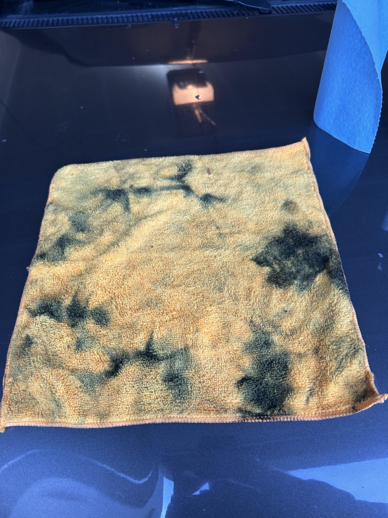

    Thanks ya'll for the advice. I cleaned it as much as possible with a clean rag and throttle cleaner and she fired right up after buttoning it up and connecting the battery.
    I also noticed the idling is a lot better. Prior when I had got it running using the accelerator, it was hovering around 500 rpms, now its around 800! I'm not sure if the cleaning actually did anything for the no start, or if just disconnecting the battery for a little bit did the trick; either way we're up and running now :)

    That was a hell of a lot of buildup. Almost looks like someone made the mistake of installing an oiled filter, like what K&N and other brands sell. It'll contribute heavily to buildup in the throttle body. May seem like better performance at first, but then it gradually degrades.
    Anyway, you shouldn't need to clean again for a long while if using standard (ideally OEM) air filters. And FYI, now you've forced a re-learn situation by pulling the negative battery cable, it may take a few trip cycles before it stabilizes.
    We most often see this "sputtering at idle" after someone's battery has been off and the throttle body is dirty. Basically, battery being off forced the ECU into re-learn, where it's using factory defaults on throttle position, but having the throttle plate unable to close properly due to buildup, it screws with the engine. It'd eventually make it to running normal again, but ...
