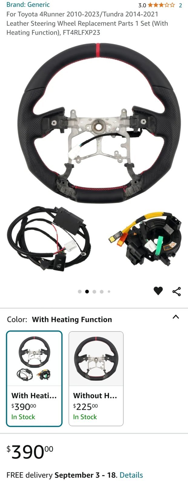

    Cheapest option out there for a heated wheel. Found on Amazon.
    I wonder which clock spring they include and which years it would plug into? Would like to make it work in my 08...

    An OEM clock spring is 424 bucks. Blew mine out today. This wheel and clock spring combo are cheaper. Wonder what the quality is.

    Ah damn. I have been considering a steering wheel replacement myself so I will keep this in mind should I go that route. And would especially enjoy having a heated wheel as well. Hopefully someone tries this one listed above so we can see if it works.

    That sucks man! Its probably just a cheap China replacement like everything else lol. Can maybe buy an aftermarket clock spring on Amazon or something?
