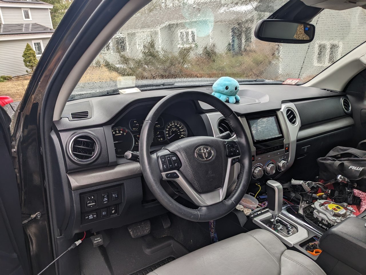

    Got the wheel mounted and the airbag/clock spring/controls are all working fine.
    Haven't hooked power to the clock spring's steering heat connector yet because it started raining, but nearly done!
    Note the AliExpress steering heat button on the left next to the auto full beam headlight button

    Shit yes this is awesome. I’ve always complained about the wheel especially in the platinum trim. I may need to do this lol

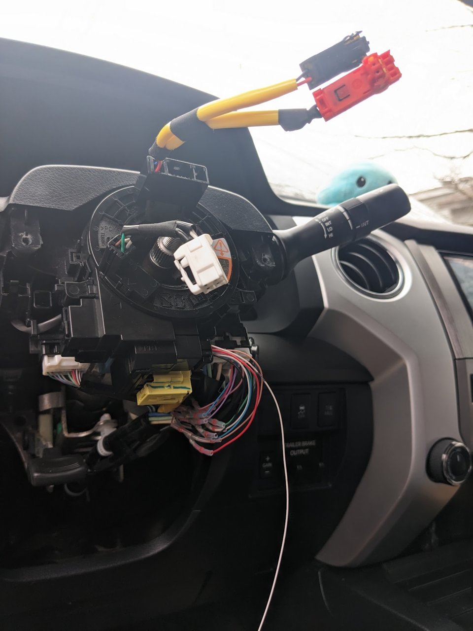

    The difficult thing is that nearly all toyota wheels post 2012 (with the exception of 4runner, tacoma, tundra, sequoia) use a 14pin socket at the column and a black 12pin socket for the controls in the wheel. tundra is a 12pin socket at the column and white 10pin in the wheel.
    So the options are to add your own heat tape to the tundra wheel with a new leather wrap, and use the 84306-50200 clock spring, or to rewire the column with a 14 pin plug, use the 84306-50190 clock spring that's like 40 bucks aftermarket, and use another wheel like highlander/sienna, rav4/corolla, camry, etc that all use the 12 pin plug at the wheel controls.
    you can see my notes here for the 12pin to 14pin conversion at the column:
    https://docs.google.com/spreadsheets/d/1Leie8b_zFCFKP0EM5M3Atvcips5oT4uP_m2W872qJb8/edit?usp=sharing
    don't rely on the colors in my sheet, toyota seems to have changed wire colors a number of times over the years
    helpfully, toyota didn't even use the same pins... the 14pin socket uses a newer type of pin than the 12 so it can't just be repinned... i ended up cutting off the tundra plug and wiring on the highlander/rav4 plug instead, you can see the solderseal heatshrink connections i used here:
    (highlander's cruise control stalk has backlighting, the dangling white wire i haven't hooked up yet just needs to go to ground / illumination -. in highlander if there's an error with cruise it will flash the backlighting on the stalk, but i don't need that)
