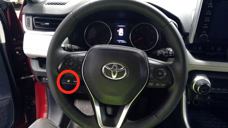

    Oh yeah, and here's the control switch I ordered. Won't come in until march so i'll probably steal a switch from my boat temporarily, since i'm not using that right now anyways lol
    https://www.aliexpress.us/item/3256803661245477.html

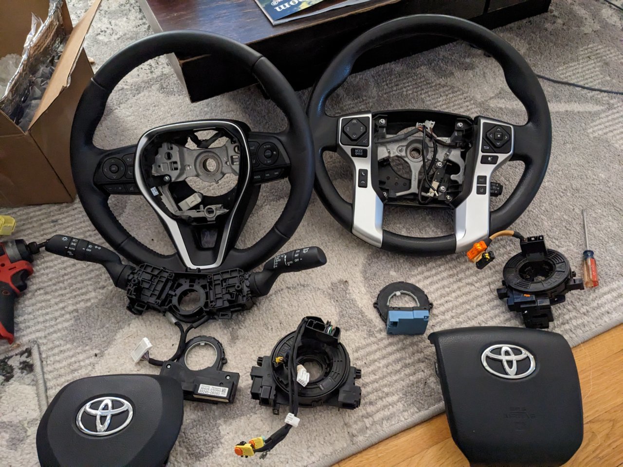

    Well... Back from my Florida tow so I can take a better look at this. Must say I'm a little disappointed to find that the center bore of the RAV4 wheel is bigger than that of the tundra, so... There isn't a single part that can be transferred from one to the other. Back to the drawing board I guess.
    I'm a bit surprised as I know people have put Tacoma wheels on a tundra, and there was a guy who put a Corolla/RAV4 wheel on a Tacoma. Maybe a year difference.

  29. Feb 25, 2023 at 3:46 PM
    #59
    vilord
    vilord New Member
    Jan 8, 2023
    #89973
    96
    Jesse
    2019 TRD
    Looks like toyota changed from a 19mm nut to a 10mm hex key screw in the 2018-2019 redesign for rav4, so the older ones might fit. think i'm going to look at highlander first though, as i'm having an easier time finding a limited/heated column locally for a 2018 highlander, and it has all the buttons, 2018 rav4 doesn't have the lane departure button
