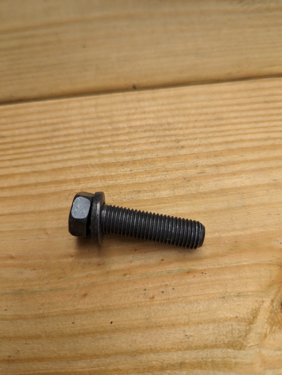

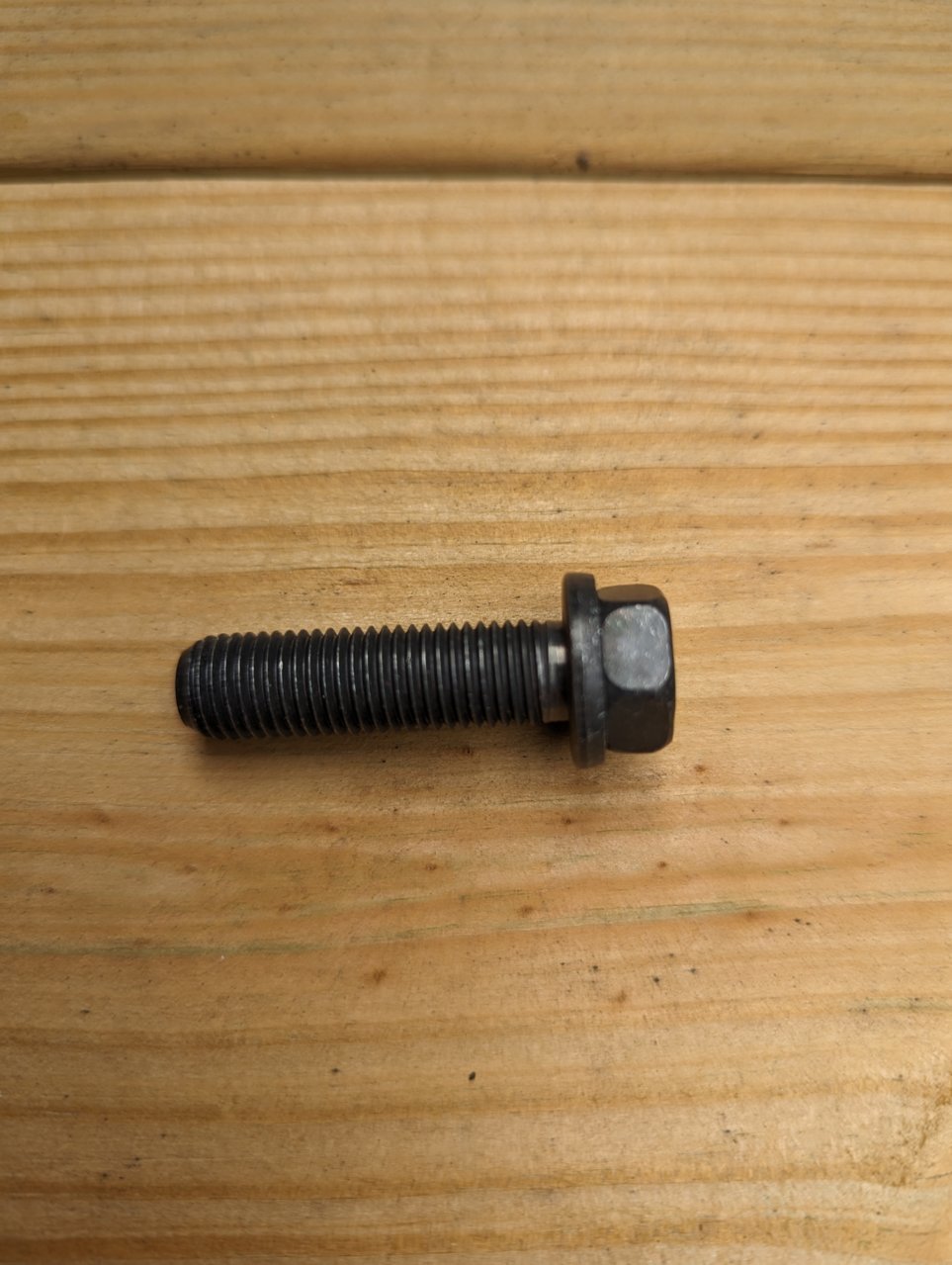

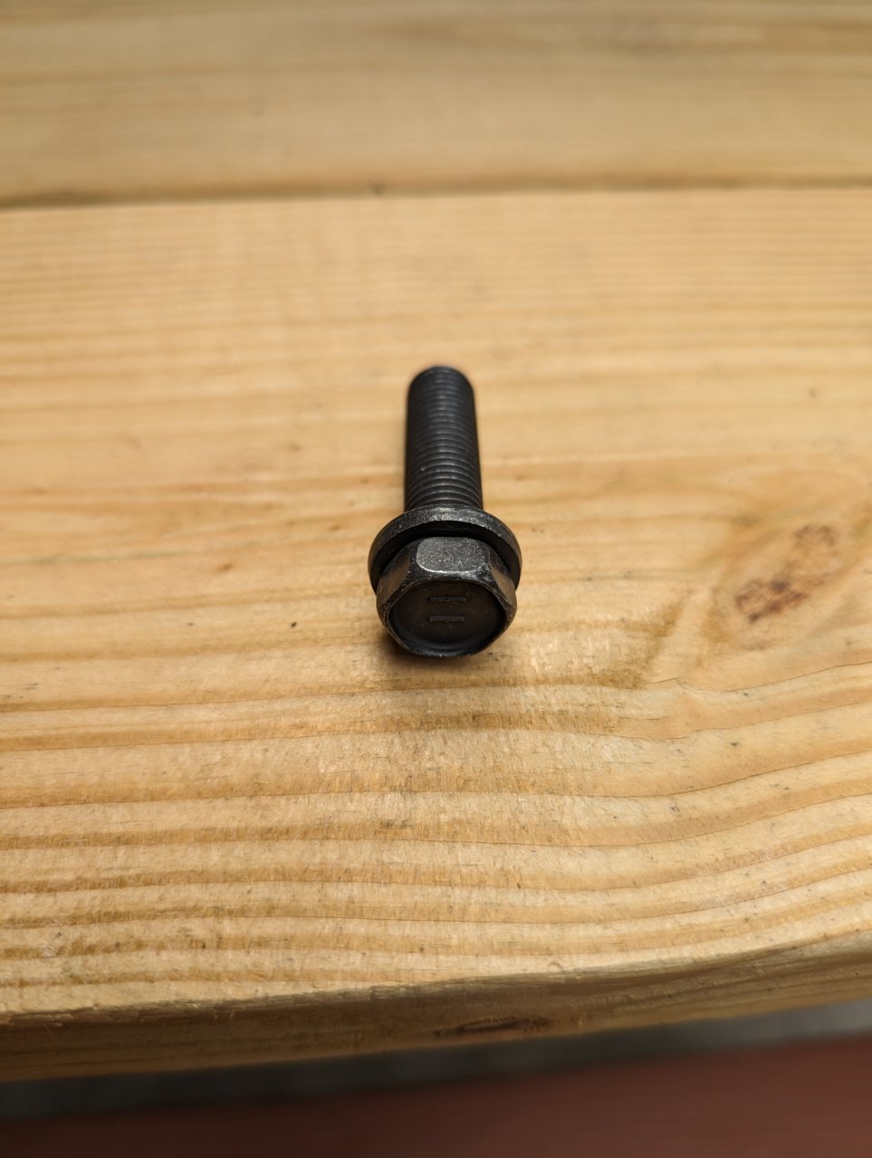

    Here are the money shots. I really had these bolts work hard for the perfect angle.

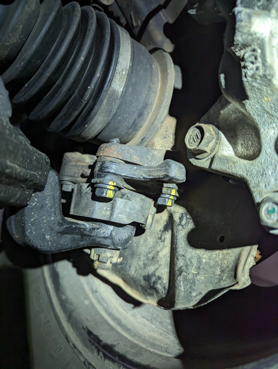

    New shiny bolts in place. Torqued correctly this time.

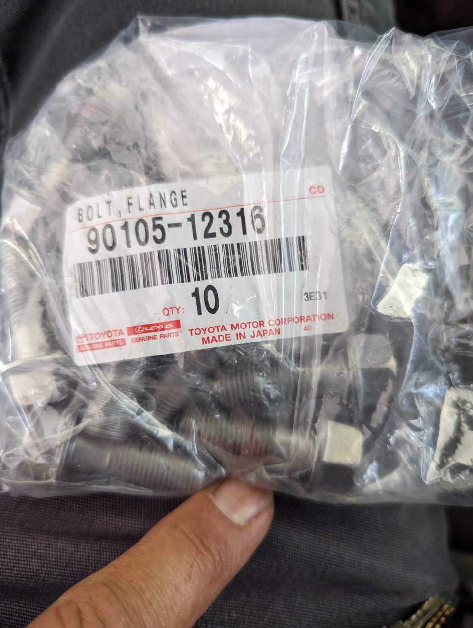

    37ft lbs? I assume you paint marked them to make sure they did back out? Do those ones come with loctite on them like these.

    Yes to 37 and yes that's why I used paint. And you reminded me I forgot to use Loctite. :facepalm:

    Those look like they already have red loctite on them

    That's not my picture. The black bolts don't come with Loctite.

    Sorry, I meant to quote @Hi06silver's picture, the bag full of bolts.

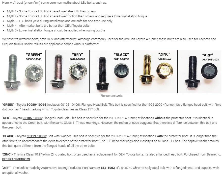

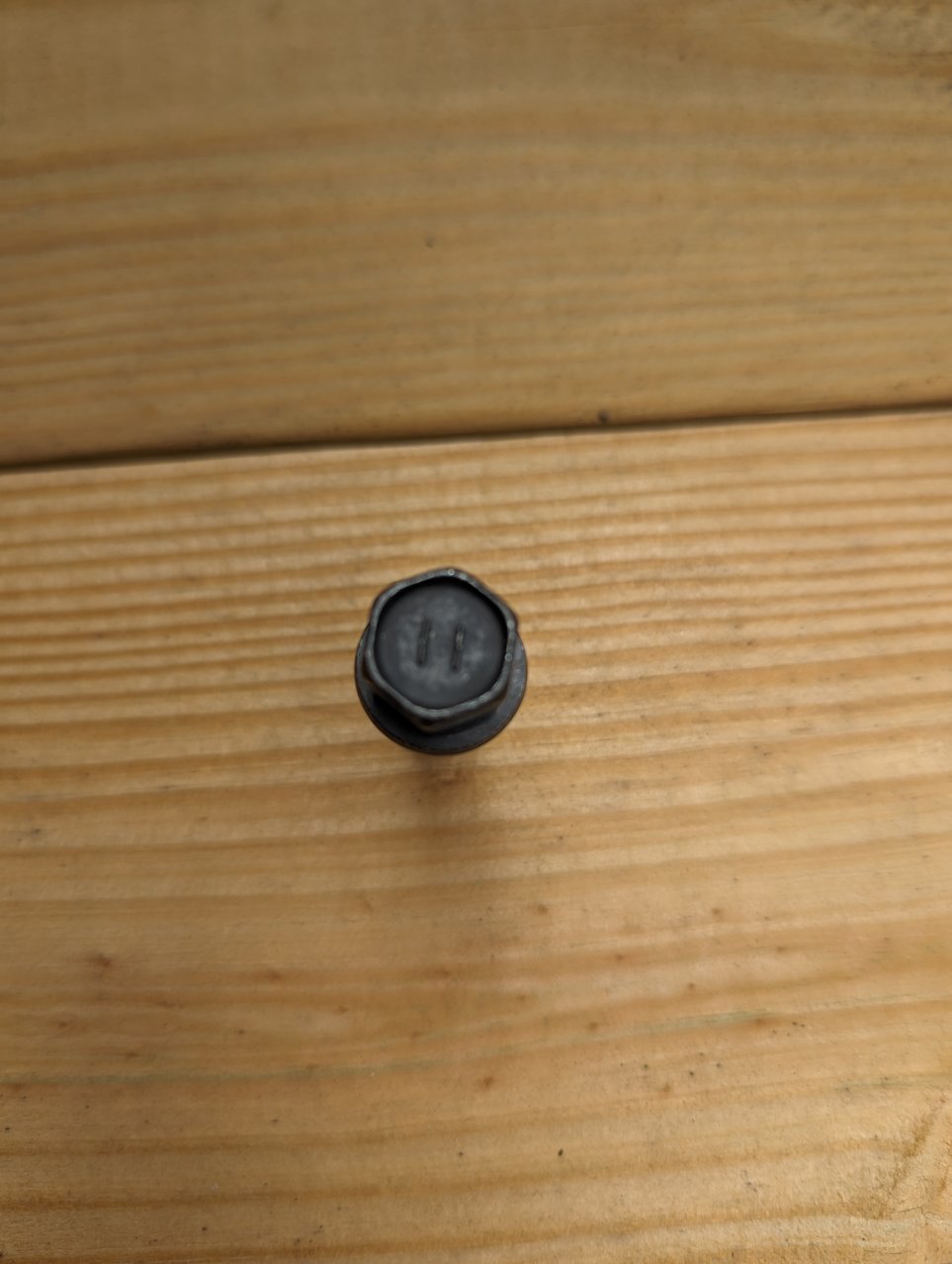

    Class 11 stamped on head(11T) and black in color is somewhat the criteria for torque spec.
    Saved this article from last year which has some way over my head info....friction coefficient etc
    Choosing Lower Ball Joint (LBJ) Bolts – ADVENTURETACO

    And from the test in the original post it's one of the best bolts.
    "Based on these results, our top recommendation for LBJ bolts would be the Toyota Black Bolt w/Washer (90119-10933) or the ARP Bolt (673-1004). The Black bolt excels in its incredibly low friction coefficient, which leads to a silk-smooth installation, and allows the bolt to reach 10,000 lb of preload at only 37 ft-lbs, significantly higher than many other bolts could achieve at 59 ft-lbs. It also provides the highest confidence in the preload generated at the applied torque, and does not have much degradation with reuse. The ARP bolt is the strongest of the group, giving it very high margin between installed torque and yield torque. It also does not degrade much with reuse."
