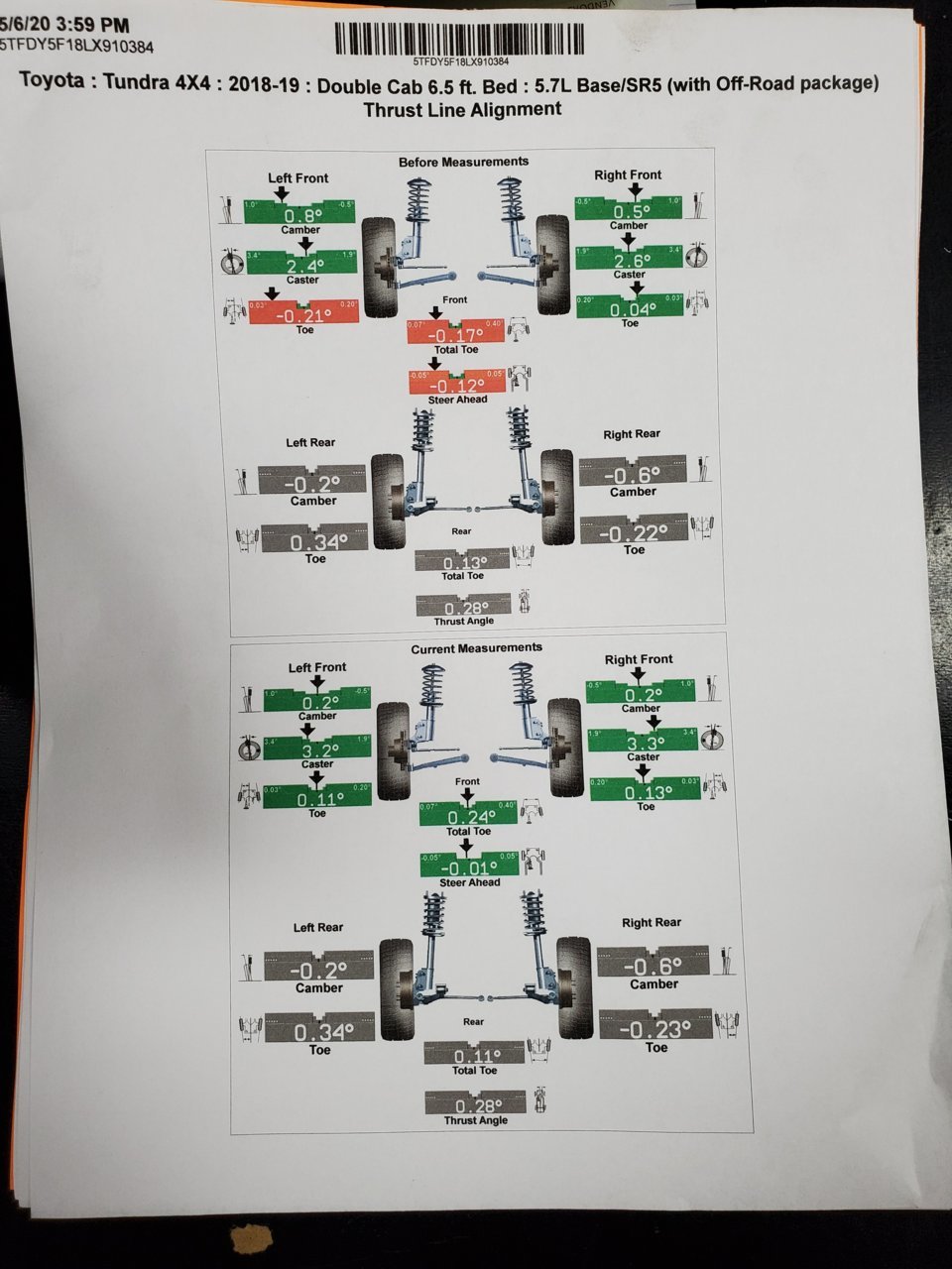

  30. Jun 11, 2020 at 9:42 AM
    #60
    Backslider
    Backslider Thirsty...
    Jun 7, 2016
    #3553
    3,245
    Tooele, UT
    2022 GMC Sierra AT4 L5P - 2017 4runner SR5P - 2023 Tesla Model 3 LR
    Here are my numbers from my last alignment and Zone UCAs.
    Can't find numbers from my old truck but I recall they were the same.
    I'm not saying people haven't had issues with them, but I personally haven't.
    Black Wolf likes this.
