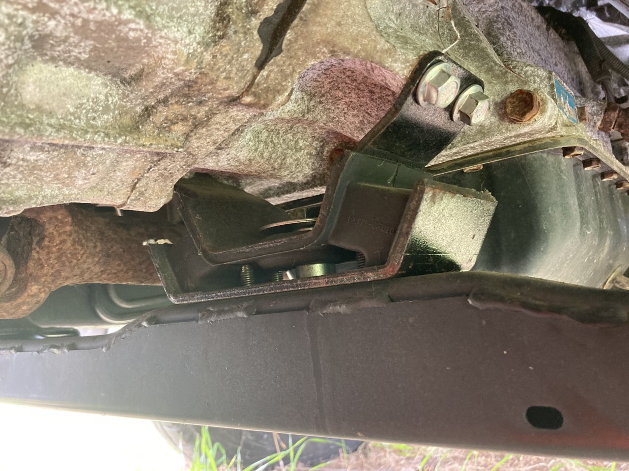

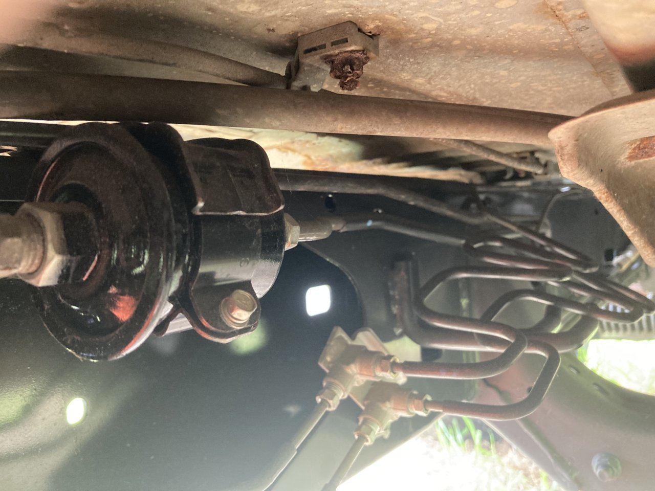

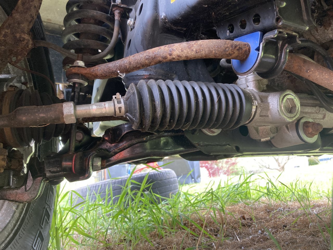

    Yes I’m in the rust belt I’d imagine. Truck is from Mass and CT. But here’s some positive pictures of the new non rusty parts :)
    E0E76387-3A39-4352-A2A2-72F12080EBBD.jpg 126F31C9-6408-4937-AABA-C2790A20A459.jpg 84476361-3E82-41E7-A020-0E74C2B0BAFF.jpg 63FBA924-28AB-4844-8360-0E9C7C72BE34.jpg

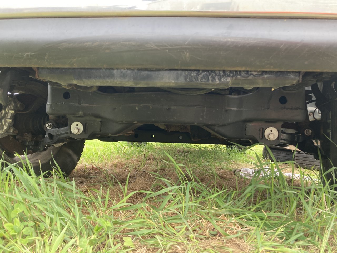

  6. May 6, 2022 at 9:42 AM
    #66
    Joecontois
    Joecontois [OP] New Member
    Apr 26, 2022
    #77642
    41
    Joseph
    2002 SR5 TRD

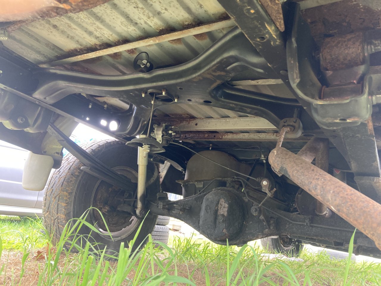

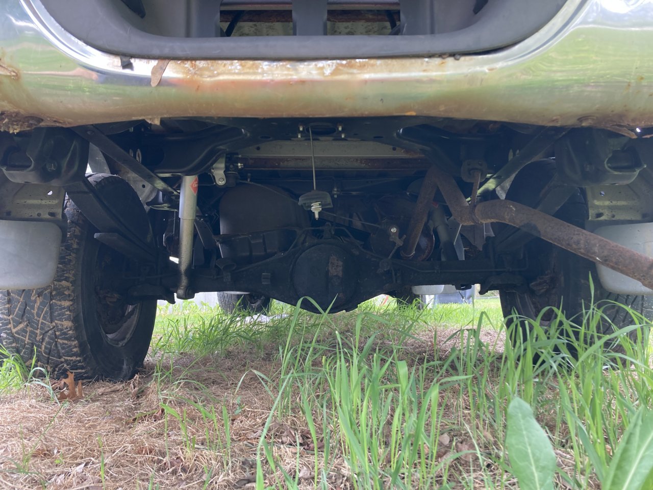

    Bought it last year. Figured it was a good foundation to build on, one that I could replace parts as I go. Was waiting until this year so I could register it as a classic. Now gotta figure out what made it stop starting.
    FA893260-B513-40AE-B1AD-F9625B498407.jpg117D5D6E-F6FB-41C2-BFFE-43DDFEC13388.jpg BACE97C7-D1C6-4D36-B534-1CDF6115C472.jpg C49BA5B3-5EBE-47FF-8E0B-8BC24D32FC50.jpg
    bmf4069 and Sirfive like this.

    Obviously someone previously had Toyota replace the frame, which is a great start. Won't fix the body rot, but at least the chassis is safe to roll on.

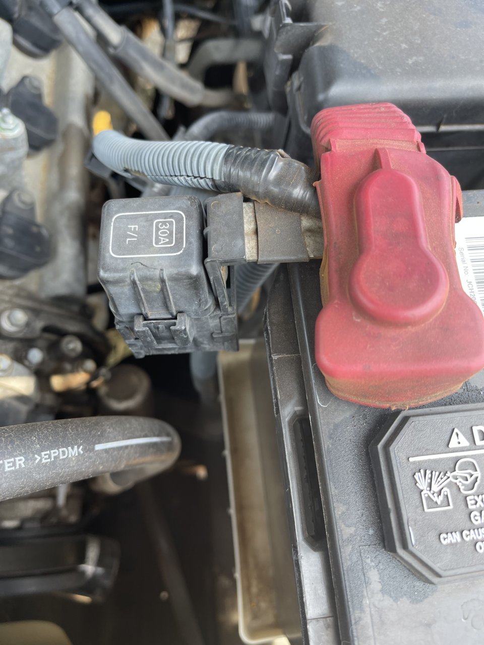

    If I were you, first thing I'd do is disconnect the negative batt cable to prevent shorts, then clean the rust off everything on the positive battery cable, including the ungodly amount of rust on that 30A relay or whatever that's off the positive battery terminal (whatever it is - I don't have one - and I'd test to make sure it's good). then reassemble the positive terminal

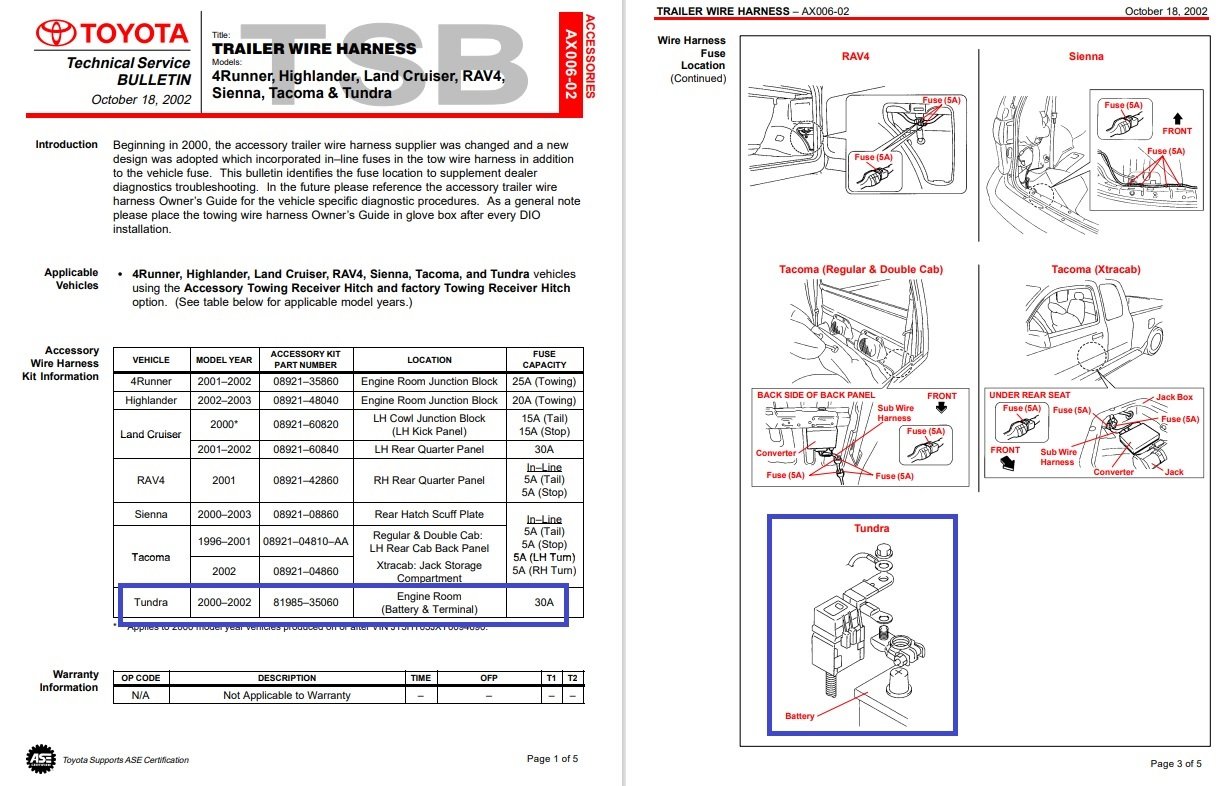

    By the way, guys with earlier model trucks, what the hell is this 30A fuse/relay thingy attached to the positive terminal? Is this aftermarket or stock? What does it actually do? It's rotten af on this truck.
  9. May 6, 2022 at 11:15 AM
    #69
    Sirfive
    Sirfive Master Procrastinator
    Jan 24, 2021
    #58078
    4,827
    SATX
    ‘02 Limited AC TRD
    Bassani cat-back
    Ive got one.
    quick search says its for the trailer lights.
    BubbaW, shifty` and Joecontois[OP] like this.
