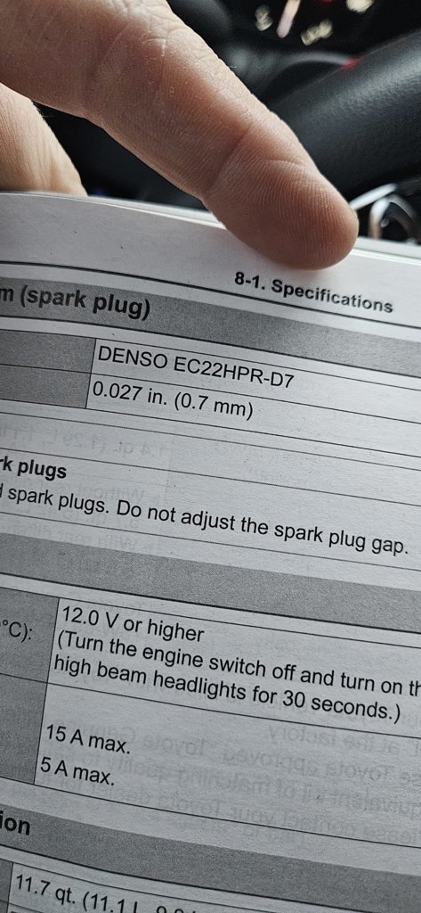

    What are the factory plugs? The Manual Says ec22hpr-d7 denso. But Rock auto and the denso sales site says they aren't compatible with a 2023 SR5.
    I assume the manual is correct but a bit paranoid

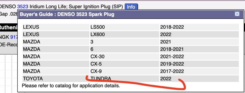

    Indeed, it's very strange that they only have the DENSO EC22HPR-D7 listed as compatible for 2022 and nothing else:

    Stranger still the Denso 3523 is listed for the 2022 tundra. But not a 2023. Yet the other available plugs/brands are listed for both years

    Looked further. Looks like rock auto just dosent have it updated the Alternative part number of 3532 IS EC22HPRD7.
    So same plug. I'll order these!

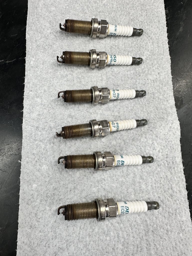

    For those wondering at 46k miles I just did the plugs (and what a pain........) plugs looked like above pics and had proper gap. And all my hesitation is gone. Snappy throttle and strong idle is back!
    Tundrastruck91 likes this.
