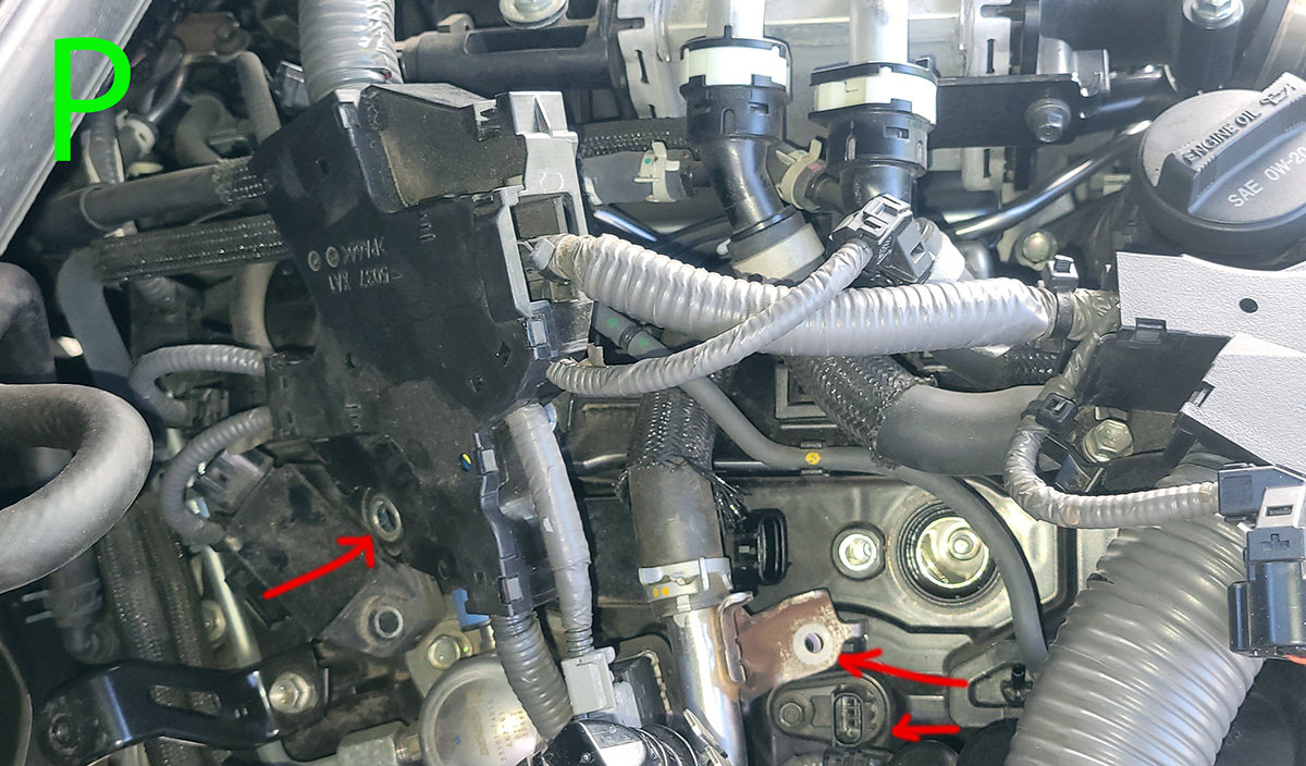

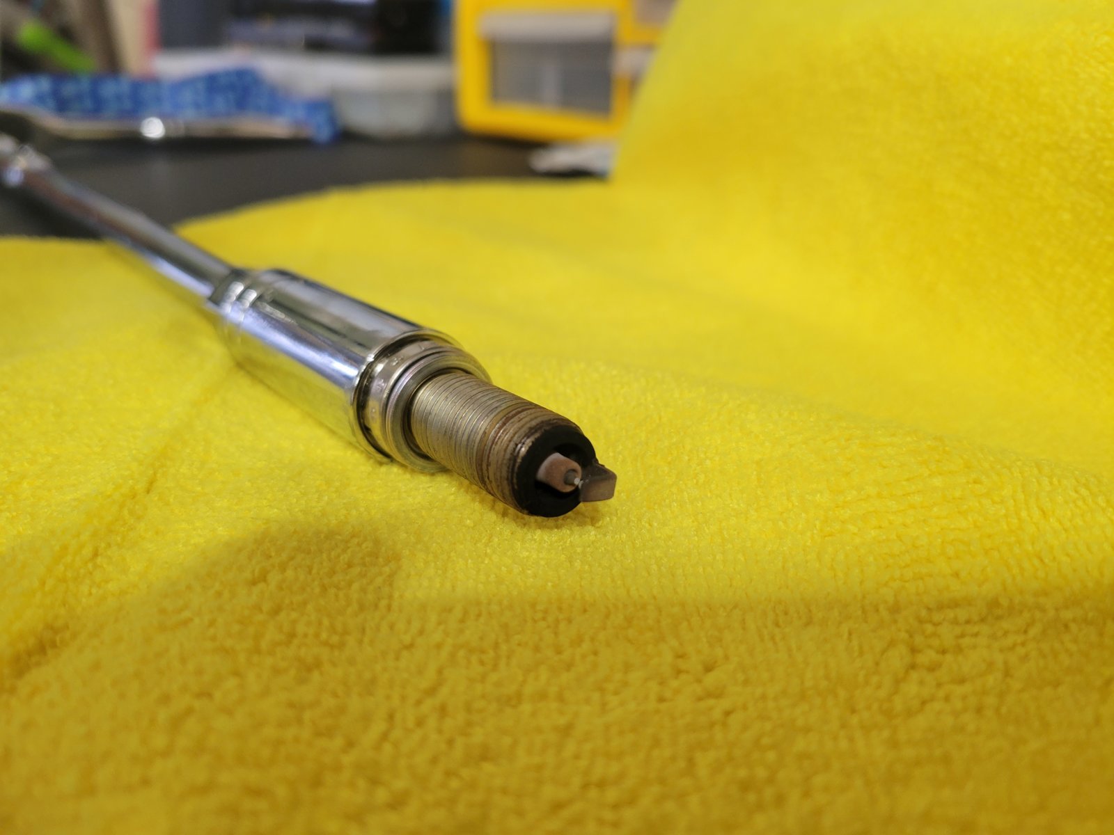

    Alright, I just finished mine.
    Time: about 1.5hrs, where I spent probably good 20 mins just looking around figuring sh** out.
    (I think this job would take 45mins the 2nd time around, maybe 1hr tops)
    I did NOT remove any of the major components shown in the PDF someone linked before. Only loosened or removed (driver side, cyl4 for sure) a couple of brackets, otherwise there is no way you can pull the coils out.
    Pass side: unplugged probably 4 connectors to give the wire loom enough room to move, and removed a couple of bolts to let that wire loom move enough out of the way to remove coils on cyl3, especially.
    Driver side: bracket by cyl4 (i marked it as "2" on the pic for some reason) needs to be removed, and another near by loosened. a connector and a hose removed on whatever that thing is in front of cyl6 plug, then move it out of the way just enough to get things in/out. Same as pass side - a few connectors unplugged, but nothing compeltely removed except for one small bracket.
    Cyl1, 2, 3 are easy to access.
    Cyl4 needs brackets outta the way.
    Cyl5 needs bracket bolts removed and wire loom pushed away; still not too bad.
    Cyl6 is the least accessible; even with things out of the way, it's tight in there. Not the worst job if you have plenty of different sized extensions/etc. If you have large hands you won't like it...but with enough scrapes and bruises you'll get to it somehow.
    I took a few pics for ref. but it's hard to show exactly where and what needed to be unbolted or outright removed.
    See you in another 40K miles.
    Pic:
    -tools used (spark plugs are "skinny" and needed 9/16 plug socket, otherwise good old 10mm and 5/16 for small bolts)
    -comparison of brand new plug vs 42K one
    -driver and passenger sides, with some marks of things or bolts removed
    PRO tip:
    Do this when it's warm enough outside (and the engine bay is warm too) b/c you don't want to break off conectors/tabs or have things simply crack with cold/brittle plastic. I hate to think what will happen in a decade on a job like this, when 1/2 of these things will be old, brittle and oxidized. You know how it is with old cars - tabs break off, looms fall apart, etc....

    You know, looking at the low wear of the 42K plugs, I think I'll wait till 100K next time this truck needs plugs replaced.
    I could have (and should have) measured the gap difference...but that's water under the bridge now.

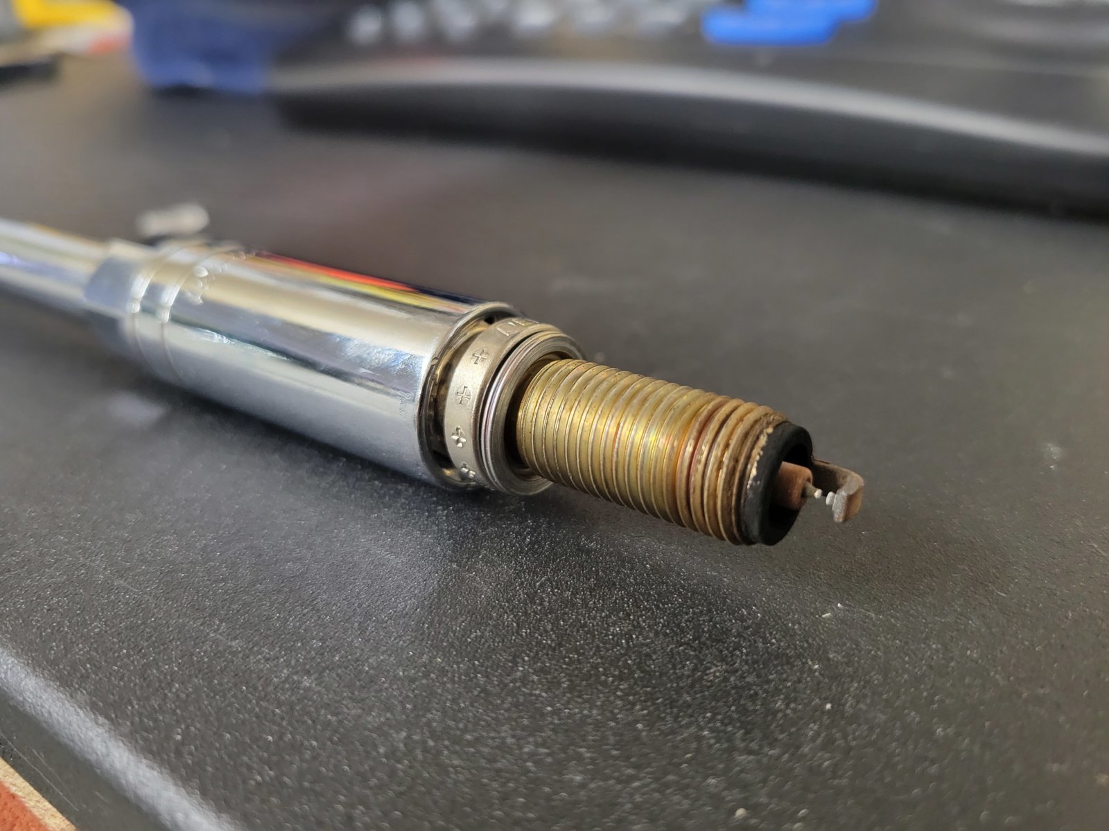

    2022 Tundra Platinum
  26. Nov 19, 2023 at 9:29 AM
    #86
    Breathing Borla
    Jan 21, 2020
    #41531
    6,794
    Northern Illinois
    those don’t look bad at all

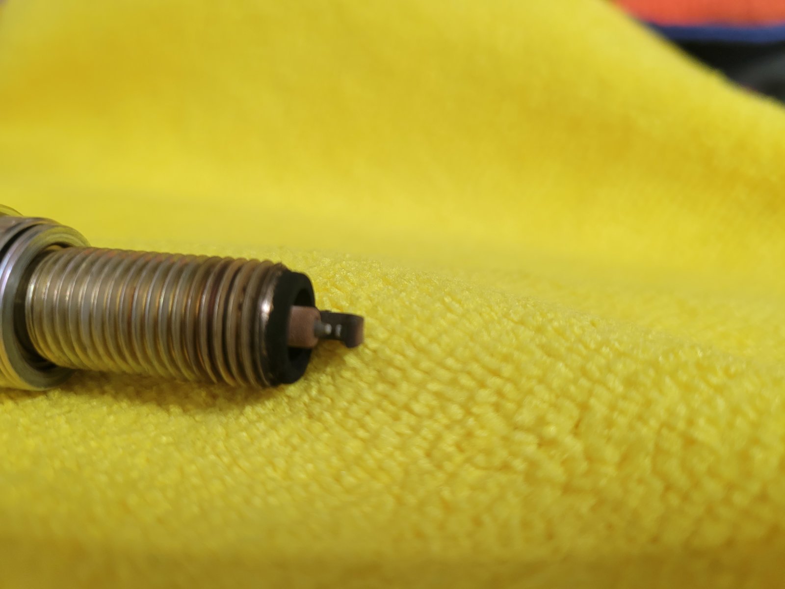

    Did change them today
    The one closer to the cab, left and right bank, where the one darker. See the pic attached. The other four where in pretty good shape. IMG_0227.jpg
    I started on the driver side and it took me about an hour. The passenger side it took me about 30 minutes.
