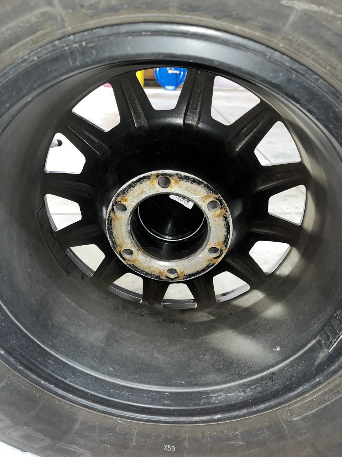

    So I’ve got some BORA spacers for my front tires and I’m contemplating whether I should actually put them on.
    They are 20mm thick (approximately 3/4”) and if I go through with it, I will have to trim down my stock studs. Not very excited about that bc these are already short. Does anyone know if I cut these studs, would there be enough thread left to where I could still use them stock if I decide to remove spacers?
    I’m worried I put them on, and my rubbing will be worse. I do have 285/70/17 with UPC upper arms.
    Also, the instructions for the spacers mentioned having a “clean machined backpad” for the wheels. Are mine good?

    If it were my truck, and I run spacers, I wouldn’t cut the studs. I would get a slightly larger spacer instead. Also I would cleanup the mounting point faces before installing as well as the hub.

    Firstly, I would NEVER try to trim the studs down. Risk of cross-threading is too big. Go get shorter studs and properly install them if you're dead set on installing spacers. Secondly, where are you rubbing now, and why the concern of worse rubbing if spacers are installed? If you're rubbing on the UCA, then you shouldn't need to worry about making it worse by installing spacers. If you're rubbing on the inside of the wheel arches, spacers aren't going to do a bit of good. Thirdly, if you install the spacers, thoroughly clean all of the mating surfaces with a wire wheel, light sanding, or something similar. Looks like you've got some cleaning to do. Lastly, I wouldn't install spacers. You're adding more stress to all of the components. With the known failures of LBJs on these trucks, the last thing I would want to do is exacerbate the problem.
