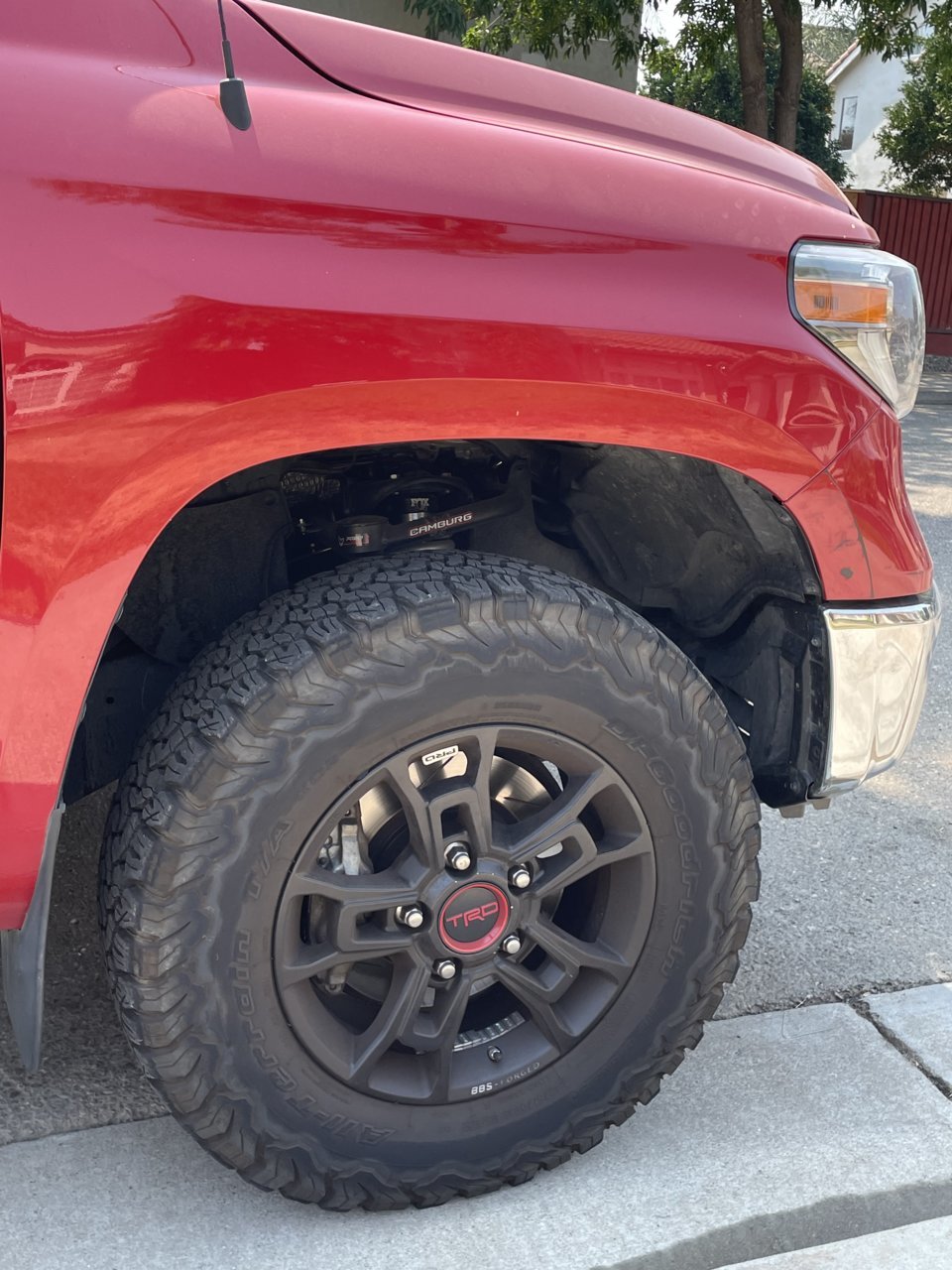

    I have an odd setup. I got some 2.5 IFP up front set to about 1.5” of lift. Rear fox 2.0, stock height. Didnt looks for anything crazy just less of a rake while having a better performing suspension setup.
    now I do have Camburg UCA which give me a bit of caster; about 6.4 degrees. So I get some camber while turning.
    I’m looking for spacers to widen the stance a bit, give me more clearance between the wheels and suspension components. I believe the trd pro wheels are +60 offset. Looking at maybe a 1” spacer. Would I run into any issues with wheel assembly?
    The stock skid plate rubs while performing fully locked turns, so I’m changing it out for starters.

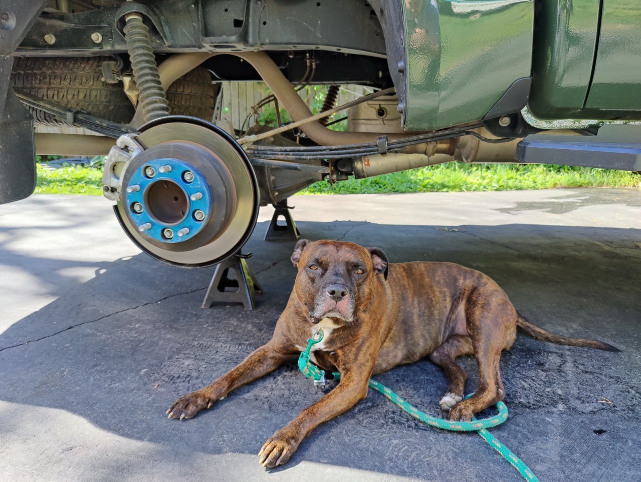

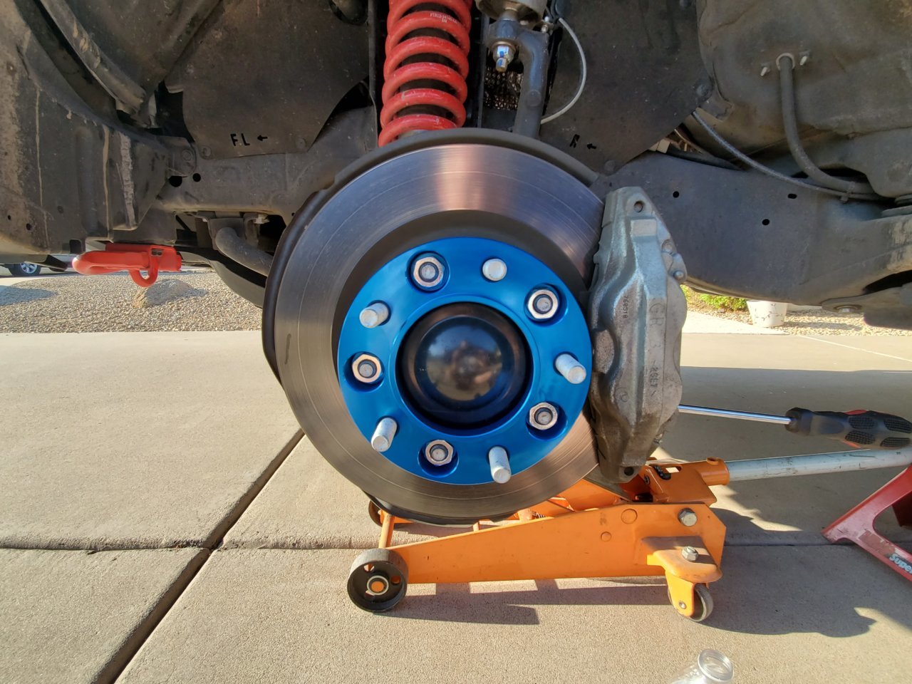

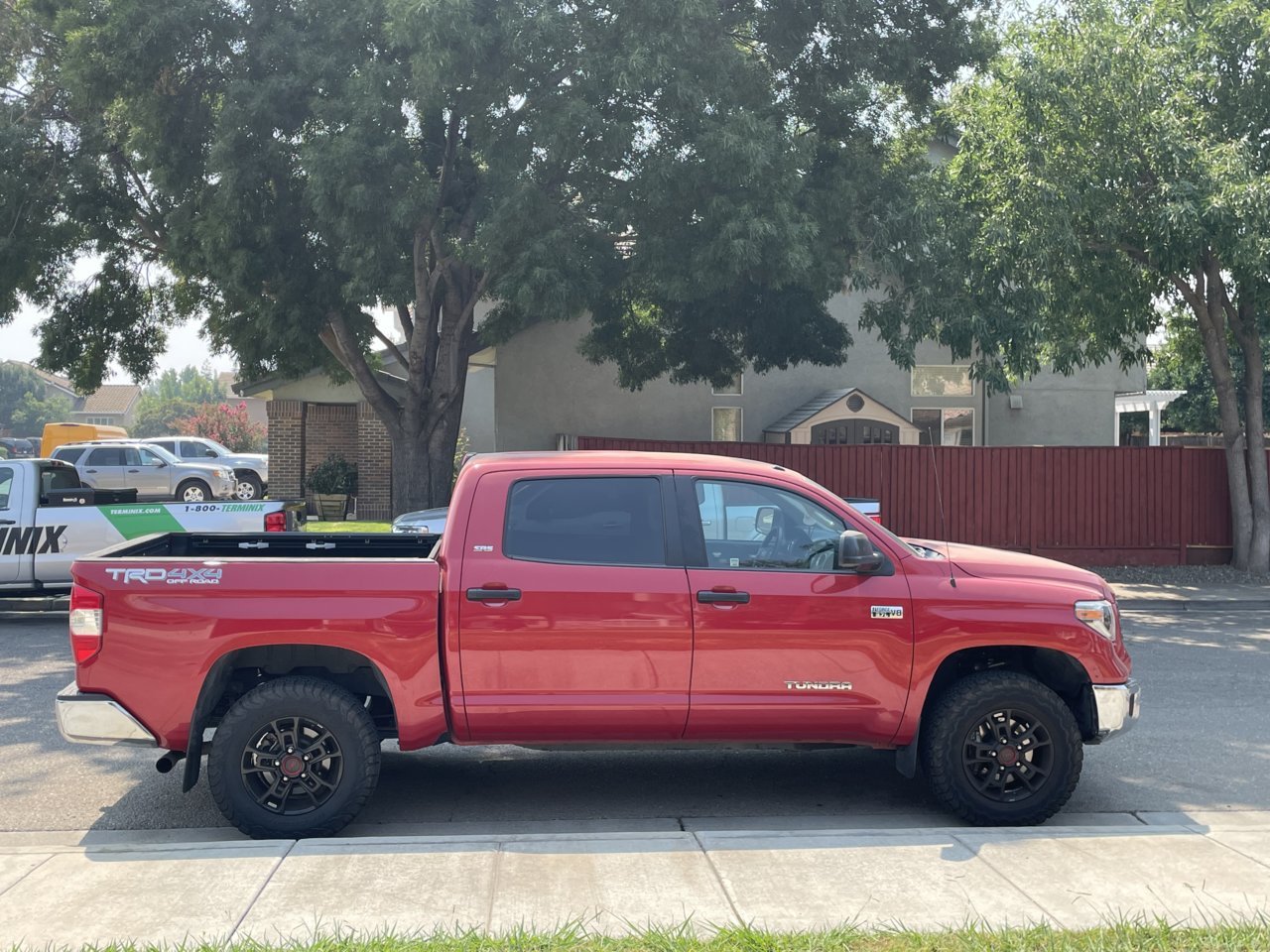

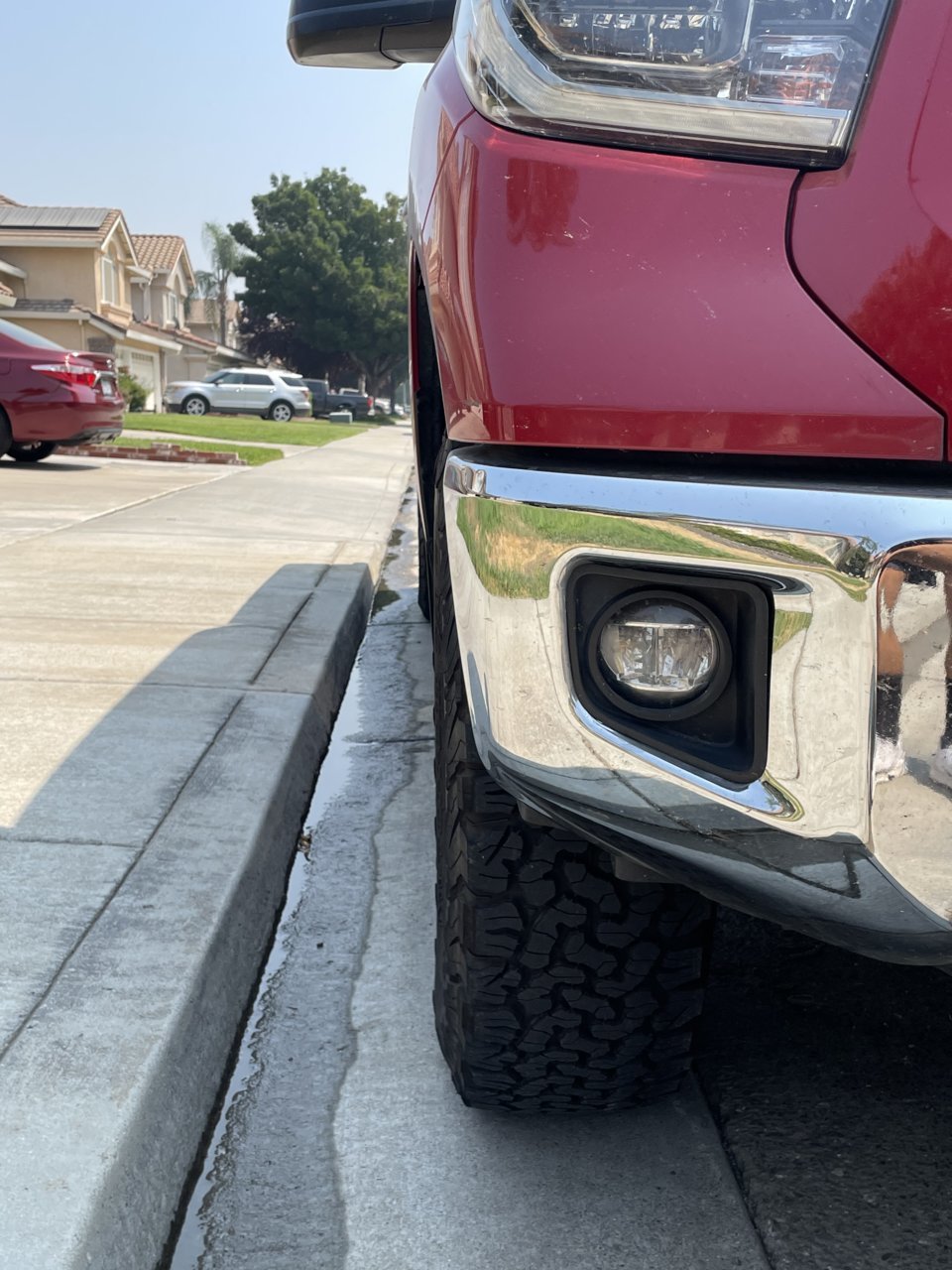

    I'll give a vote to Bora's here only because they're made to the size you want. NOTHING against Spidertrax as they're the only other option I'd suggest (ran Spiders on a Jeep that was off-roaded regularly for years, no issues). I went with Bora's because I wanted 2" spacers (effectively reducing my offset to +9mm roughly with stock TRD off-road wheels, 35x12.5 wide tires). Here's an image to show the resulting aesthetic. Bora or Spidertrax, nothing else. Bend the skid plate. You'll be fine.

    Those all look clean. What size spacers are those. I’m looking at 1”. Yours seems to clear the studs, I’m wondering if a 1” would?
  9. Aug 28, 2021 at 5:04 PM
    Ckatz53
    Ckatz53 Newish
    Nov 10, 2019
    #38511
    1,829
    MD
    2020 Cement Tundra CM Limited 4x4
    www.fouroneodetailing.com
    Those all are Spidertrax spacers. They only come in 1.25". If you want 1" specifically, you'll have to get them made by Bora.

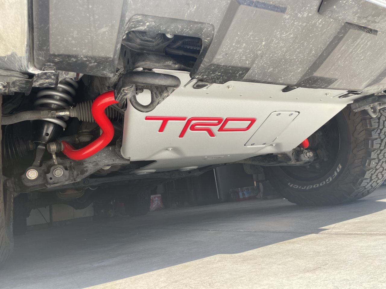

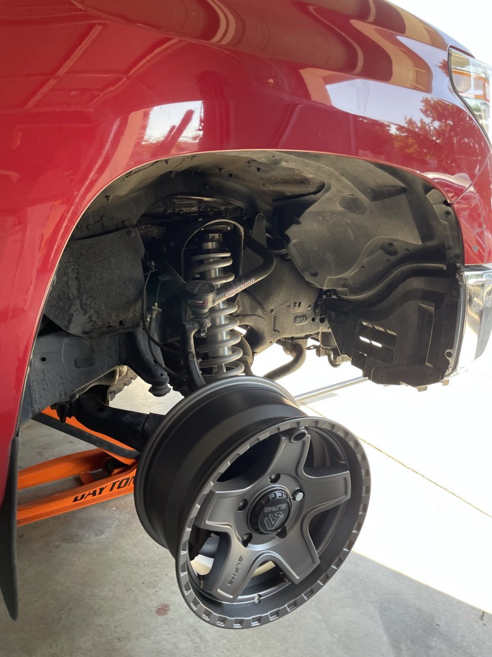

    I ended up snagging a trd sway bar for 150 and trd skid plate for 380 both new from maita toyota in sac. Labor Day sales looked good.
    I got a nice deal on Alphaequipt 17” Echo wheels, they cleared the brakes and are +35 offset so about the inch I was looking for.
    quiet honetly still on the fence about the wheels cause the BBS’s look pretty clean.
    Black Wolf likes this.
