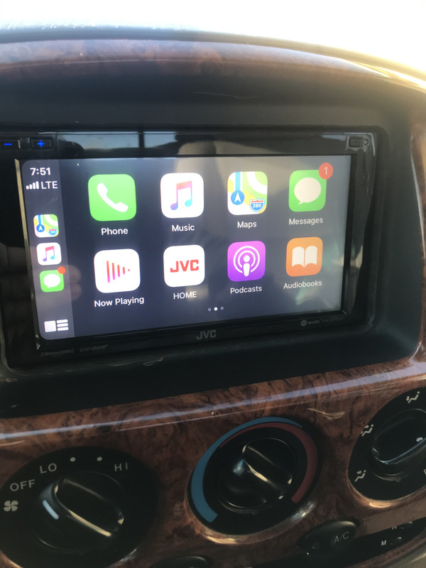

    Decided to upgrade the radio. While the old one still worked great, I needed something that would have better call quality. The Amazon one had a built in speaker but it was junk.
    Did some research online and found out Best Buy will not only price match (including Crutchfield) but will also install for FREE. I didn’t believe it at first but it really was. I ended going with the Best Buy’s geek squad recommendation on the JVC-M750BT. I was hesitant at first because I had my mind set on a Sony but he assured me this was a better unit. The people that I have called says it sounds like an OEM Bluetooth call and the apple car play is an awesome feature. It’s a lot of bang for the buck at $269.
    One of my favorite features is completely adjustable Backup camera lines.

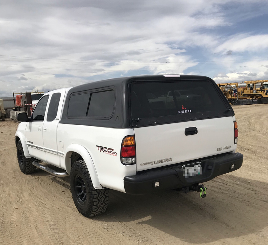

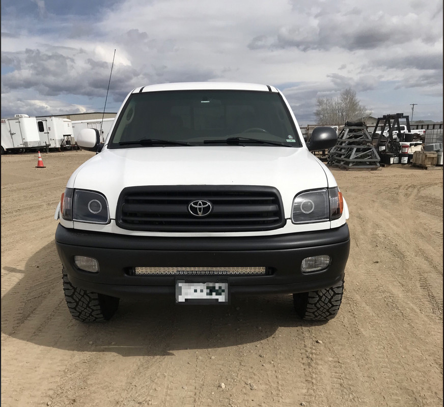

    When I bought this truck, my intentions were to restore it, not build it. Well... I think that has officially changed now.
    Since blacking out grill, I’ve wanted to replace the bumpers to get rid of the chrome. I saw another first gen that had the bumpers covered in bed liner and I wanted to do the same. After reading how much prep was involved, I opted to do plasti-dip. It’s on there pretty dang thick (8 or so coats worth). I cleaned it really well, sprayed a coat, waited 20 min and did another coat. Repeated that a bunch of times and it’s on there thick. I don’t think any rock chips will be getting through, at least for awhile.
    And lastly, her latest and biggest upgrade; a Leer 100R topper. Found this by accident and I got a smoking deal on it. I’m going to upgrading and painting a few things on it to bring it back to life and then will be building a sleeping platform for an air mattress.

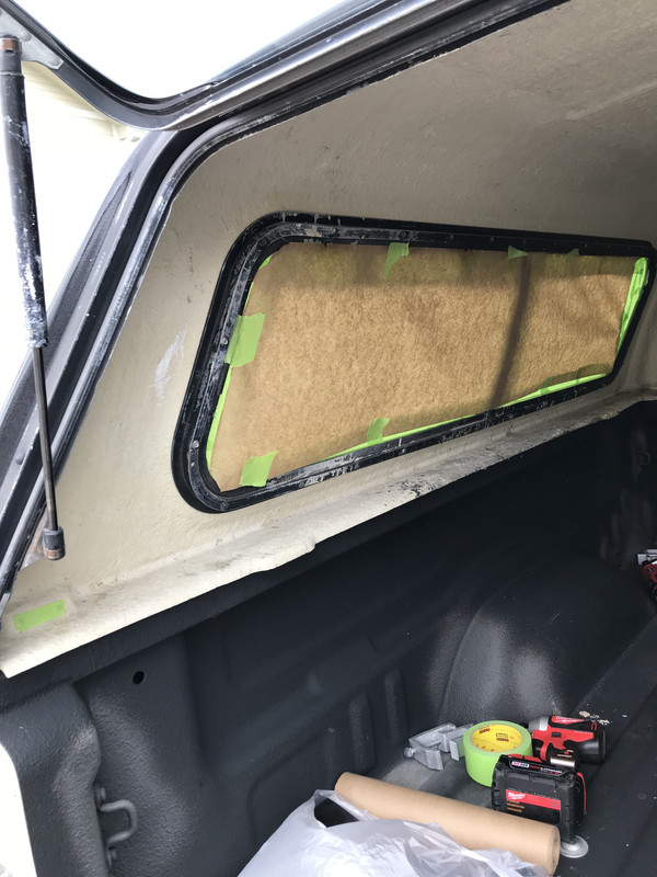

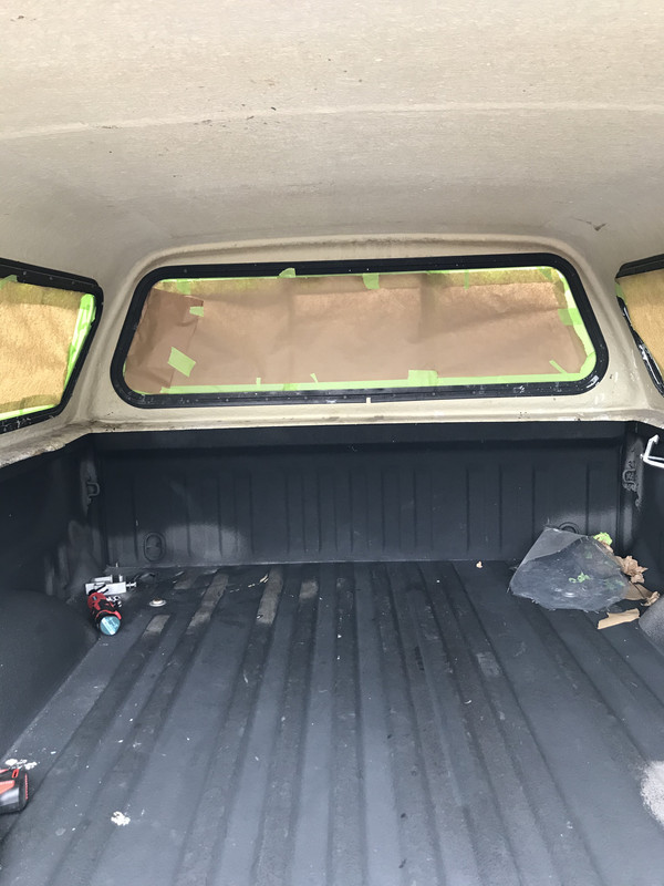

    Beautiful cool day in Colorado so I decided to work on the shell. The previous owner was obviously into construction as the inside had paint all over it and glass. I got all the paint off the windows via a razor blade and removed all the chunks of paint off the fiberglass I could. Then ran it down to the car wash and washed it all out. Stopped by the auto parts store and picked four cans of Duplicolor TR250 truck bed coating. Got everything masked off and shot it. I’m really happy the way it came out and it dried really hard. The texture was exactly what I was looking for.
    Before
    A
    fter a solid coat:
    And the finished product. I’m sure once it dries completely, it will look more uniform.
    H
    ere is an example of the texture. A piece of tape came up and I didn’t catch it right away.

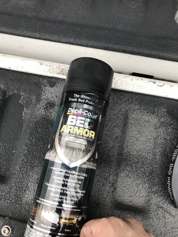

    I debated on what to coat it with. I called a topper place and he suggested just a roll on latex paint. I then thought bed liner, plasti dip and regular spray paint. I decided on bed liner because I wanted that texture and I felt it would ‘fill in’ the deeper spots better.
    Product used - Dupli-Color Truck Bed coating TR250. This stuff sprays fast, strong, wide and doesn’t clog. I had ZERO issues in the four cans I bought. Three cans would have done it so the fourth was just for added thickness.
    For anyone looking at bed liner in a can, DO NOT use their Bed Armor stuff. I had an extra can laying around and figured with this, plus the four I had I would be enough. I started with this and within 30-45 seconds of spraying it clogged up and ran down the the side of the can. I cleaned it and tried again but it kept happening. Halfway through the can and I pitched it.
