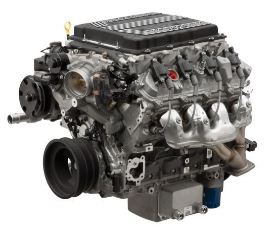

    bmf4069 and ColoradoTJ like this.

    I dont think i'd want an aluminum block or high compression on a truck (i know the titan is aluminum, but its 2wd & doesnt have a hitch. Basically a crossover.). Low rpm and cool would be the ticket. Thats my main beef with the 2uz, it wants to spin, but has 2 bolt mains & '03+ has weak rods.
    im not happy with ethanol gas, wouldnt hurt my feelies to swap in a diesel.
