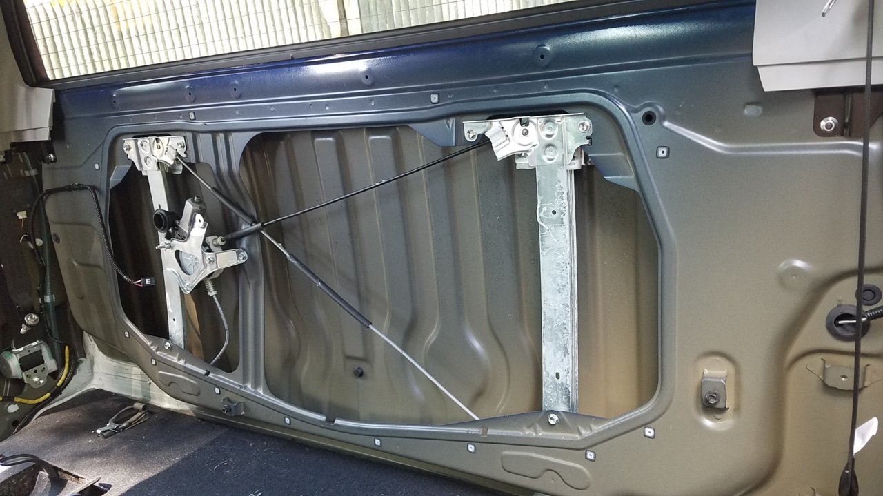

    Starting the back wall and under seats....rear seats removed is step one. Sub is also coming out now

    As you can see there's some deadening behind the rear seat, including a large sheet of MLV

    Had to remove seatbelt bolts to get trim off. Then removed factory sound barrier. This will do back in later

    Remove panel that covers the rear window motor. On this area it looks like I can apply some CLD tile material. No room for anything else.
    Dont need much to kill the vibrations
    Also made up a foam gasket to go around the black panel to cut down on vibes
