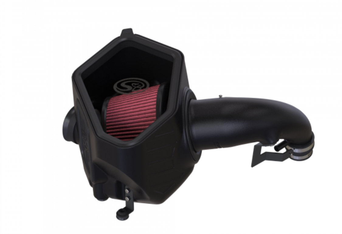

    I would lean toward S&B if you were going to buy an intake. All of the AFe parts I have ever bought were disappointing. Overpriced and lower quality. I will only buy their stuff if it is absolutely the only option.

    LOL yeah, I added myself to the waitlist for the S&B air intakes. They look pretty nice with that plastic top part.

    Thats the one I was wanting but just got tired of waiting so got the only open air kit ready for now…the k&n…..I bet the s&b will be great!
