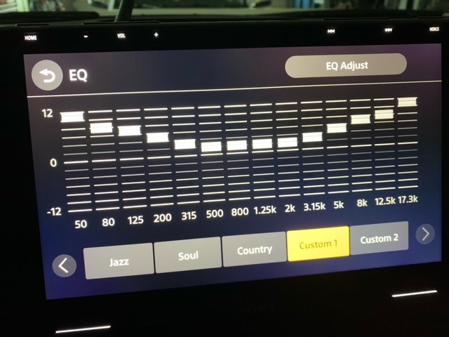

    I found a video where the creator was talking about EQ settings from a basic standpoint, nothing to do with this head unit in particular.
    He said that generally speaking, EQ settings need to form a kind of "smile" pattern and then can be fine-tuned from there based on user preference.
    Spending time with the unit listening to various songs with every 'stock' EQ setting (i.e. Rock, Pop, Dance, Jazz, etc.) I came to the conclusion that they all sound anemic and crappy.
    I set up a profile under Custom 1 that more or less mimics the EQ settings featured in his video, and to my ears, it's an improvement. Not perfect, but much better than stock EQ profiles. Again, this is in conjunction with the TGP Kicker bundle (front, rear, and 2 dash tweeters) and my iPhone/CarPlay via wired connection to USB.
    Haven't played around with the parametric EQ because I don't know WTF I'm doing yet.
    Here's a screenshot FWIW:
