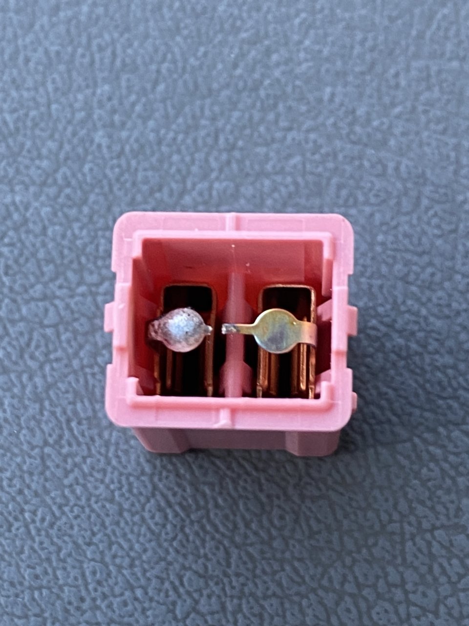

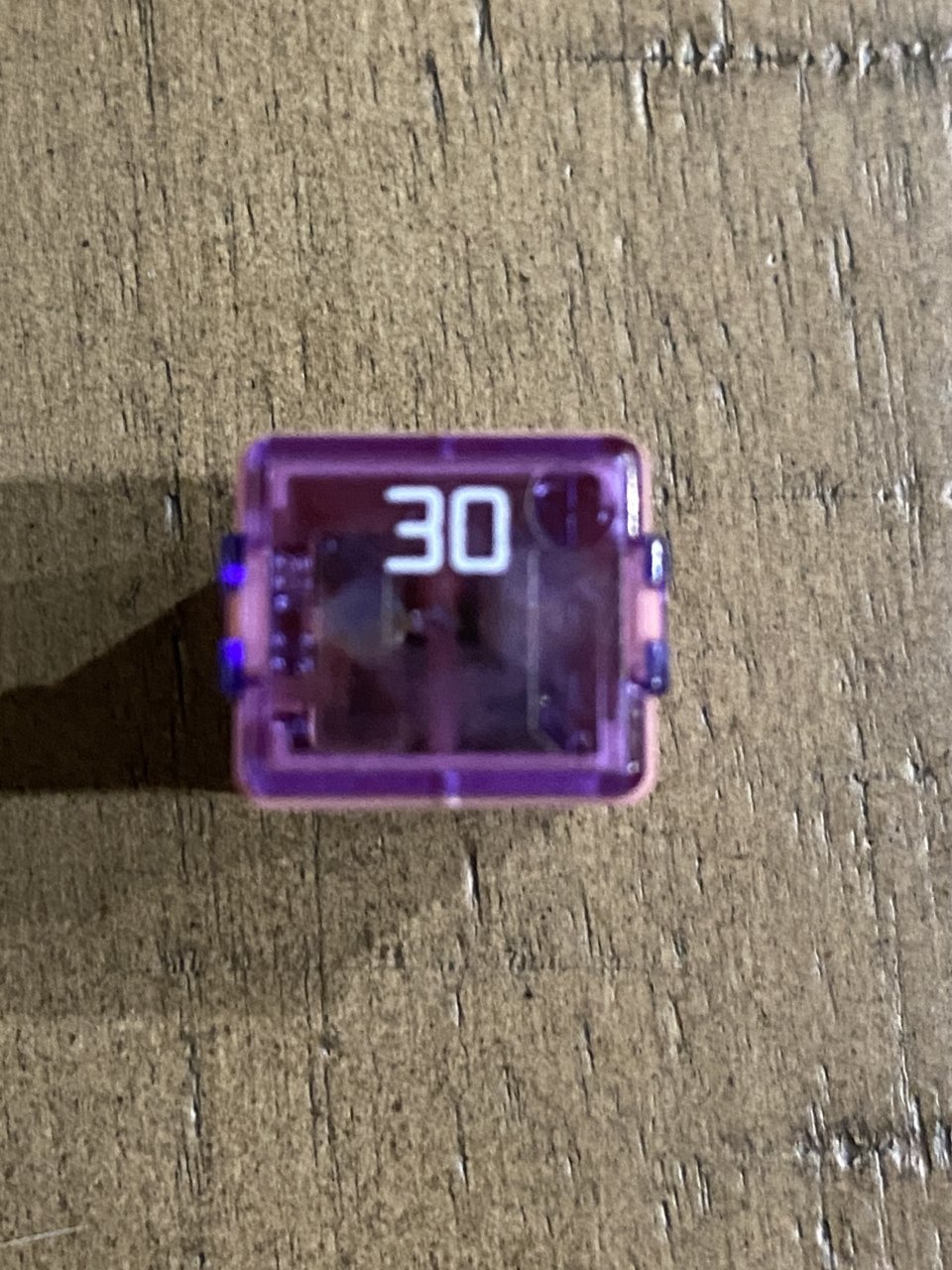

    OK... so I found this issue and it's FIXED! Thanks for all of your help. It was, indeed, a fuse. HOWEVER, there is a fuse that you really cannot see or check unless you pull off this tinted cover and see that it's blown.
    Under the dash is a 30A power windows fuse that is different sized than the others. This was the culprit. I'll post pictures of the blown fuse, and the part at NAPA for it. Hope someone else can learn from my mistakes. But I did learn A LOT about checking fuses with a light tester and a multimeter!

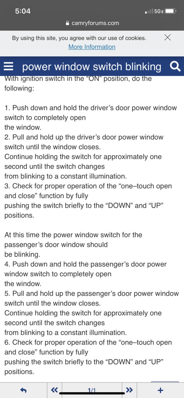

    Just went to roll my front passenger side window down this morning and it would not go down. Double checked the lock switch and that didn’t change anything. All of the other windows work as well as the door locks from the main drivers control. However, The window will roll down using the switch on the passenger side. I haven’t checked any fuses yet. Does this sound similar to anyone else’s issue?
    UPDATE-
    Found this on the Camry forums. Fixed the issue. This was all after I replaced my battery and it needed the factory reset.

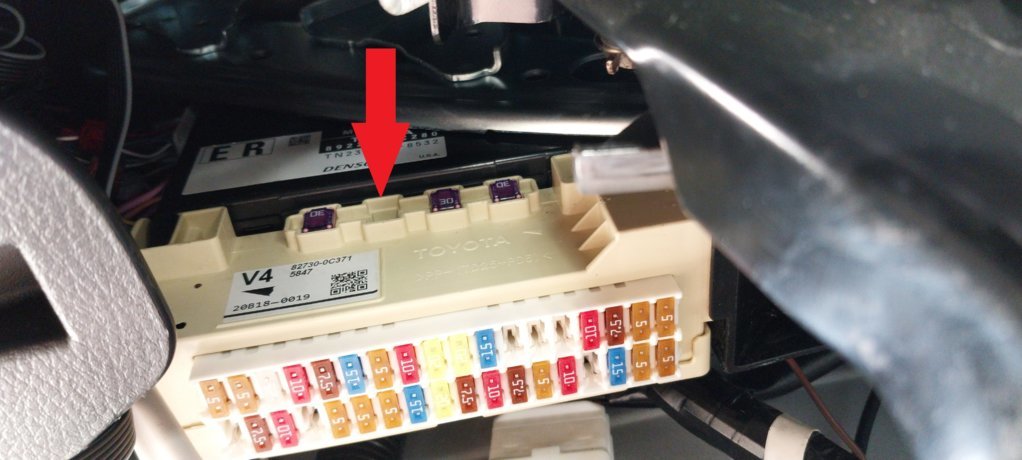

  20. Feb 3, 2025 at 4:32 PM
    #50
    dsurfkiller
    dsurfkiller New Member
    Mar 30, 2020
    #44512
    3

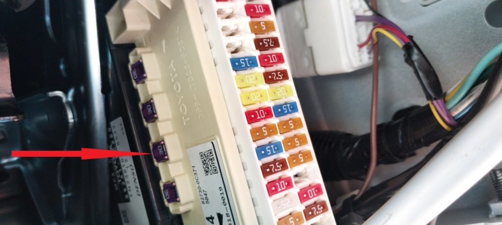

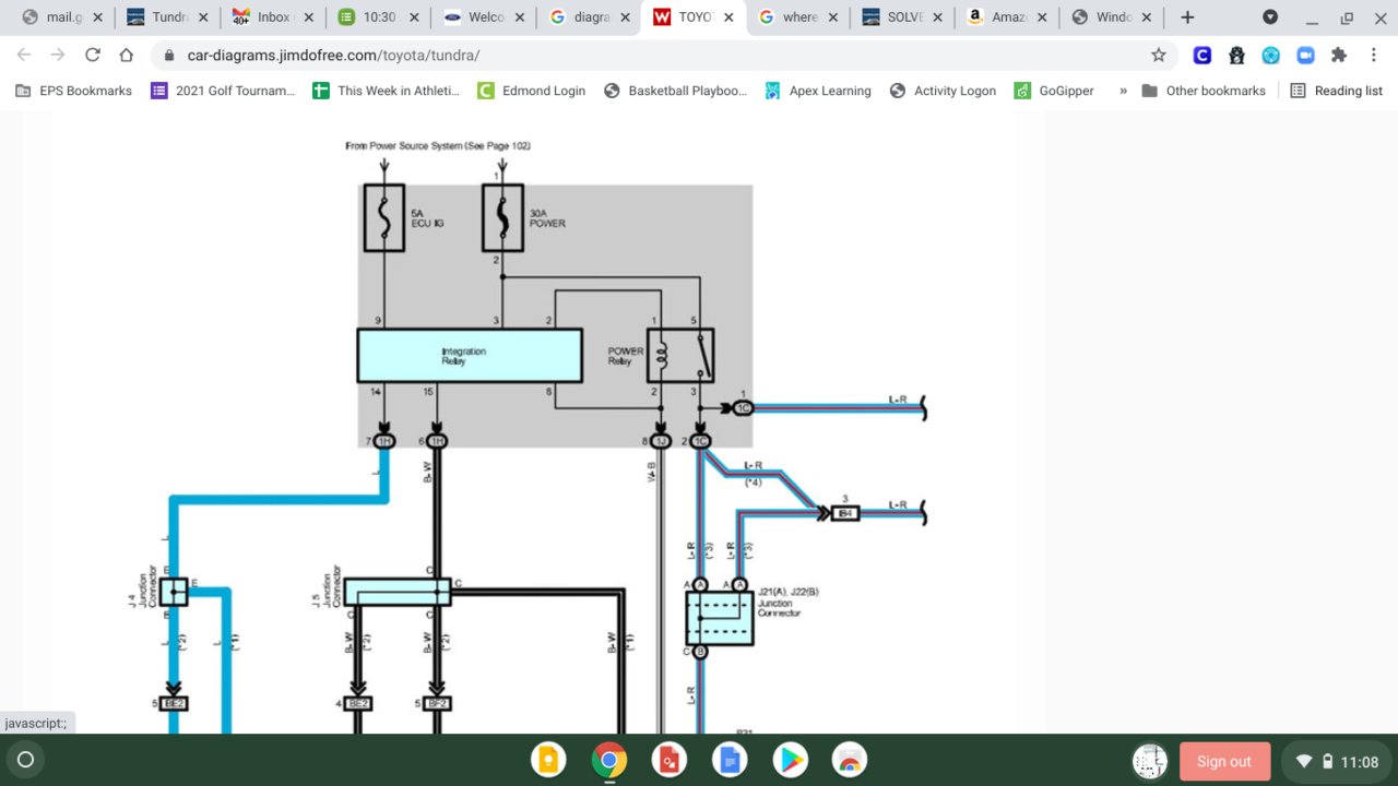

    Related topic for the benefit of the group...
    If none of your power windows are working, it may be this not-labeled 30 Amp fuse on the side of the drivers-side footwell fuse box (located above the parking brake).
    I blew it accidentally shorting an unused relay socket in the under-hood fuse box, causing none of the 4 power windows in my 2020 Tundra SR to work.
    This fuse is not identified on the owners manual, nor the service manual, nor on the fuse diagrams. It is depicted, but not labeled, in the power windows wiring diagram. All_Windows_Fuse_Location.jpg All_Windows_Fuse_Location_2.jpg
    BrandonL812 likes this.
