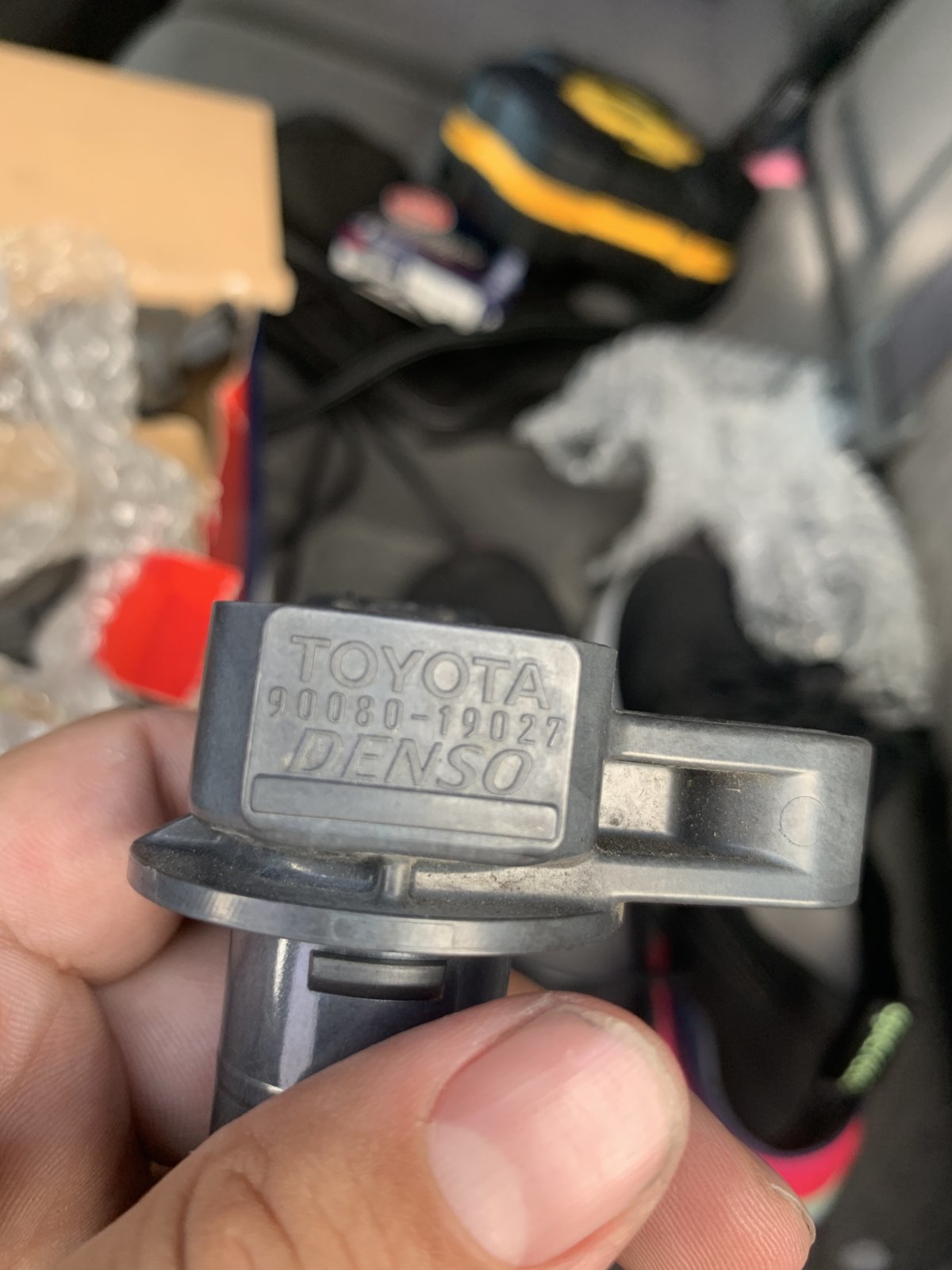

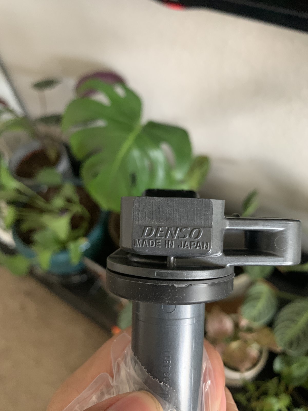

    Always Denso for coils, it’s pretty much oem
    Easily get another 200k miles
    Rockauto denso, looks like Toyota was shaved off
    orginal Oem
