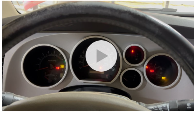

    2008 Tundra - similar issue as a couple of the guys here. Wouldn’t start, one loud click, took her apart and replaced starter. Last night started 6-7 times with new starter. Came back early today and same loud click. We have tried a new battery and cleaned terminals but no luck. Now this happens on dash.
    any advice pretty please and thank you!

    @blackdemon_tt - the connectors seemed okay, the normal breaking of the plastic clip but added a little to hold it back on - started again after I posted the first post and now wont start again - cleaned all the terminals and will try to unwrap and look at cables as explained.

    heres a video of dash now

    What do you think I should pick at next? Today got a crankshaft sensor code so replaced that and still nothing
    4lo blinking vac off blinking tire sensor blinking - cleared codes and still same sound

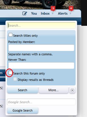

    1. Post your issues in a new thread inside the 2nd gen forum here: https://www.tundras.com/forums/2nd-gen-tundras-2007-2013.26/
    2. When doing your searches, always start inside that forum (like, bookmark that link so you always come here via that subforum) and while using the search feature, click this "Search this forum only" box so you only get 2nd gen results which will apply to your truck.
