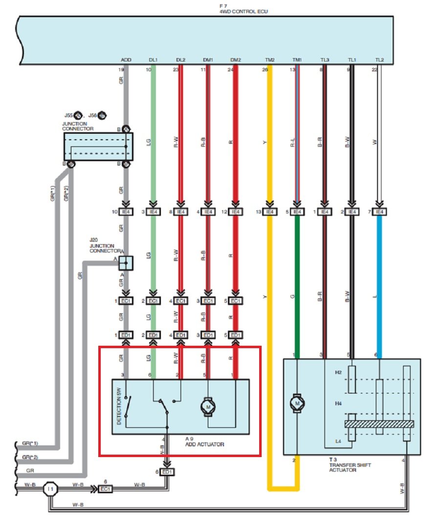

    My Update: New transfer case actuator works fine. In 2WD, no flashing lights and the front axle is unlocked. If I press for 4Hi, the actuator responds and locks up the front drive shaft. However the lights is flashing and there's no response from the ADD front actuator. I plugged in a new ADD actuator and it didn't respond either. I'm glad I decided to test it by plugging in the connector. It would of been very disappointing to install the new one only to find out it's not getting any power. Decided to test the connectors for both actuator for continuity to the 4WD ECU connector. I was able to verify continuity for each wire on the transfer case connector and the 4WD and 4Lo switches. I checked the ADD connector and wasn't able to confirm continuity between gray wire on #3 of the connector and #19, which becomes a green/black with at a connection with gray #3. I was hot today and I did 4 hours of troubleshooting and checking wires. Had to call it a day. So the question is...why isn't the ADD actuator getting any power when the 4WD button is pressed? There is absolutely nothing; no clicks, buzz, movement. It's dead. I need to check again there's no #3 to #19 continuity and if so, I'll track down the connector where get #3 connects to become GRN/BLK going to #19 of the ECU. #19 is connection point marked "ADD" on the diagram. (I attached a diagram for a 2002 model but my Tundra is an '04. If anyone has the '04 diagram, I'd appreciate if the can confirm the #3 to #19 wire is the same for both model year---my Tundra is a DC and they weren't available in '02. Thx.

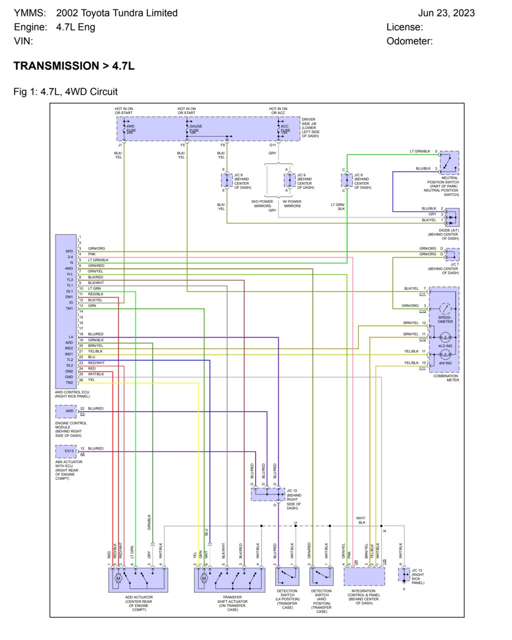

    As mentioned on page 1 post #24, EWD's can be had for an 04 and other years at the link below.
    This link ---> Ultimate TUNDRA Wiring Diagrams Collection | Toyota Tundra Forum (tundras.com)
    Also in that post was a pdf file that is the appropriate EWD pages for an 04 DC 4WD....4WD flashing. both actuators ok

    SOLVED! (Finally!!!) So it turns out the small electric harness that attaches to the front differential actuator was shot. Fortunately Toyota had that small section available so I replaced it. Then there were issues with the wiring attached to the 4hi and 4lo switches, that are attached to the transfer case actuator. Next, 8 of the wires attached to the 4wd ECU were cut or had the sheathing trimmed off so I fixed all that. I checked continuity for all wires going to both actuators, both switches and ecu for those wires that connected to the ECU. I cleaned up the front actuator but had a difficult time putting it together because I wasn't sure of the timing of the internal rotary gear. However, the transfer case actuator was beyond salvaging. I bought a cheap actuator instead of OEM since I didnt want to dig myself to far into the hole without knowing the outcome. It turned out ok but I didnt use the shift rod that came with the actuator, since I would have to take the TC apart to use it. Instead I used the original shift rod abd attached the cheapo actuator body to it. I had to fanagle a bit to get the rod timed with the actuator gear, but I finally got both actuators timed with eachother and 4WD is working smooth. I can't say I enjoyed the project since it was a bictxx..but I'm glad it worked out. Tundra is an '04 DC with 233k miles. When I bought it 4 years ago I saw the prior owner (this was an auction purchase for me) had damaged the TC and declined Toyotas $4,200 repair quote. Apparently a bootleg repair was done and that is why many wires were cut and poorly spliced together. I got 3 years of good 4wd service but the last year issues started up until 4wd finally crapped out. Thanks to all that responded and helped me out.
