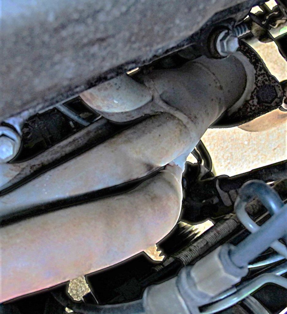

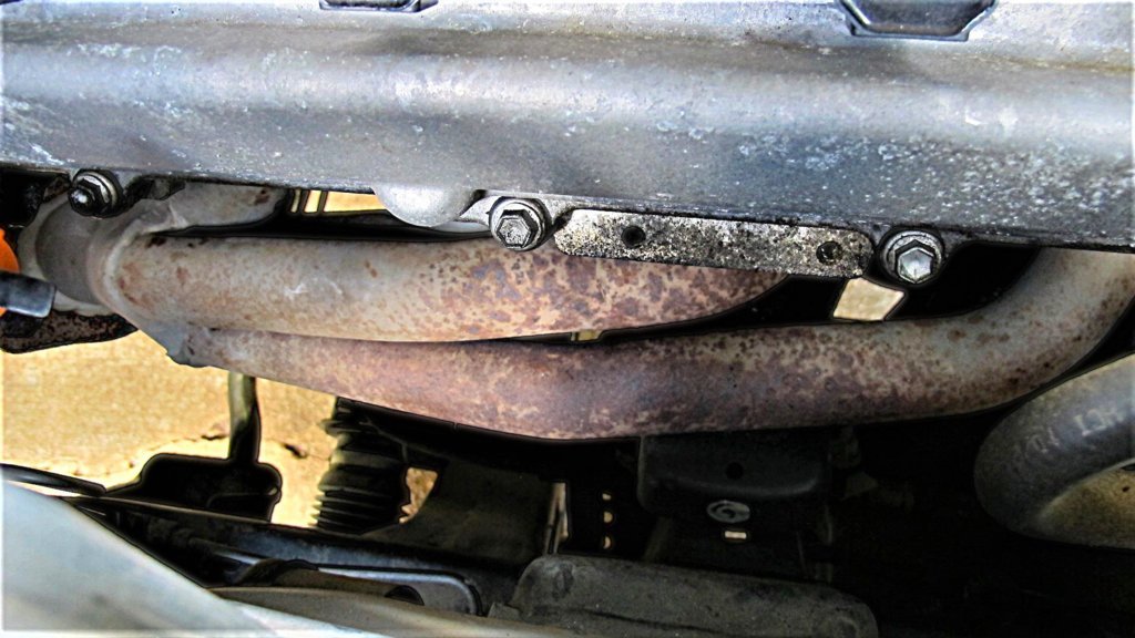

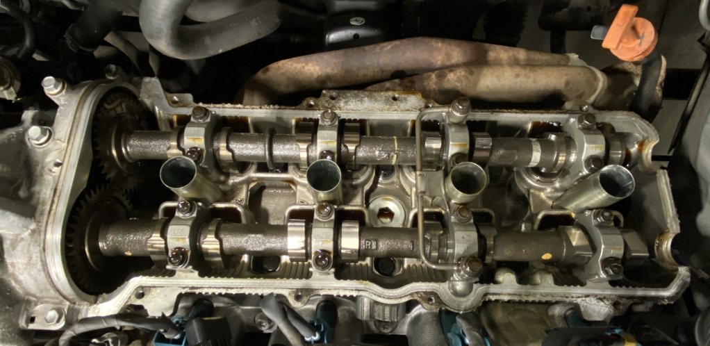

    My ceramic coated JBA shorties have been on the motor for more than 20 years, and even though they don't look great they are still working as advertised after almost 180,000 miles of service. I took these pictures a couple years before replacing the valve cover gaskets.
    Another look while the valve cover gaskets were being replaced.
    The sound is slightly deeper, but no louder than stock.
