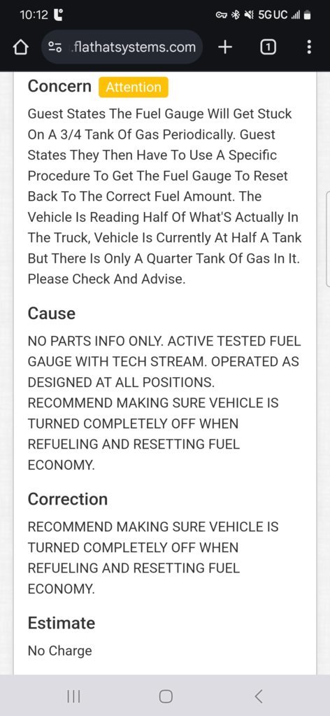

    This is what my local Toyota repair shop just sent me in regards to my fuel gauge not functioning properly,
    Essentially they said there is nothing wrong with it and functions as it should.

    WOW!
    Maybe we need to disconnect the battery when filling! How do you "completely" turn off the truck?

    LOL. That’s what they all say, and after 3+ years now!! (Lying Dogs) I’m still waiting to hear if the ‘25 is still doing it.

    That Concern text is totally wrong.

    You're absolutely correct. I spent about 15 minutes trying to explain the issue to them and they still entered it in incorrectly. So this is the game you have to play with Toyota. You have to take your vehicle in multiple times and continuously try to re-explain the same issue over and over until they get sick of you. So my plan is to once again fill the truck up to full and drive it until it happens again and make another appointment that is usually about three weeks out to get in again and do it all over. I think the one diagnostic tool that they could have used they didn't. If they would have just put gas in it and did a simple math calculation they would have seen that the actual amount of gas in the tank was off by a quarter or 8-ish gallons, but all they did was plug in the diagnostic tool.
