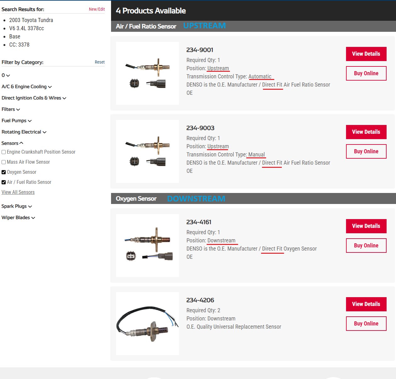

    Battery light may be alternator, may be corrosion in the wires if we didn't already say that.
    P0134 could either be bad upstream O2 on the driver's side, or an issue with the O2 sensor wiring.
    If someone is a fuckwad and cut the harness to install a universal or aftermarket sensor and didn't use appropriate sealed splices, or if something snagged a wire and cut/pulled it out, that would do it too.
    If the sensor is truly bad, it's recommended to change upstream and downstream on that same bank (driver's side for V8, or pre-cat on V6) with Denso brand "exact fit" part. Part number lookup is @ www.densoautoparts.com
    Be careful, upstream is often listed as "air/fuel" sensor in their lookup tool. Also, they'll usually list a couple, one "direct fit" and a "universal". Finally, 2WD and 4WD sometimes have different sensors for bank1 or bank2. Sometimes Manual vs. Automatic have diff't sensors, like here, note underlines, showing the front is different depending whether your V6 is manual or auto:
