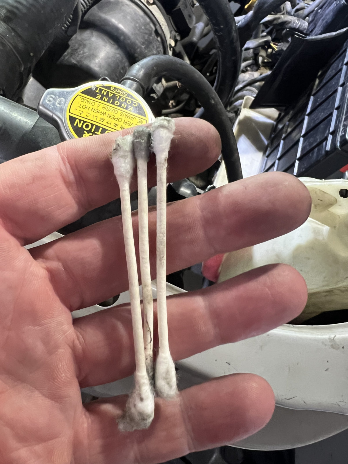

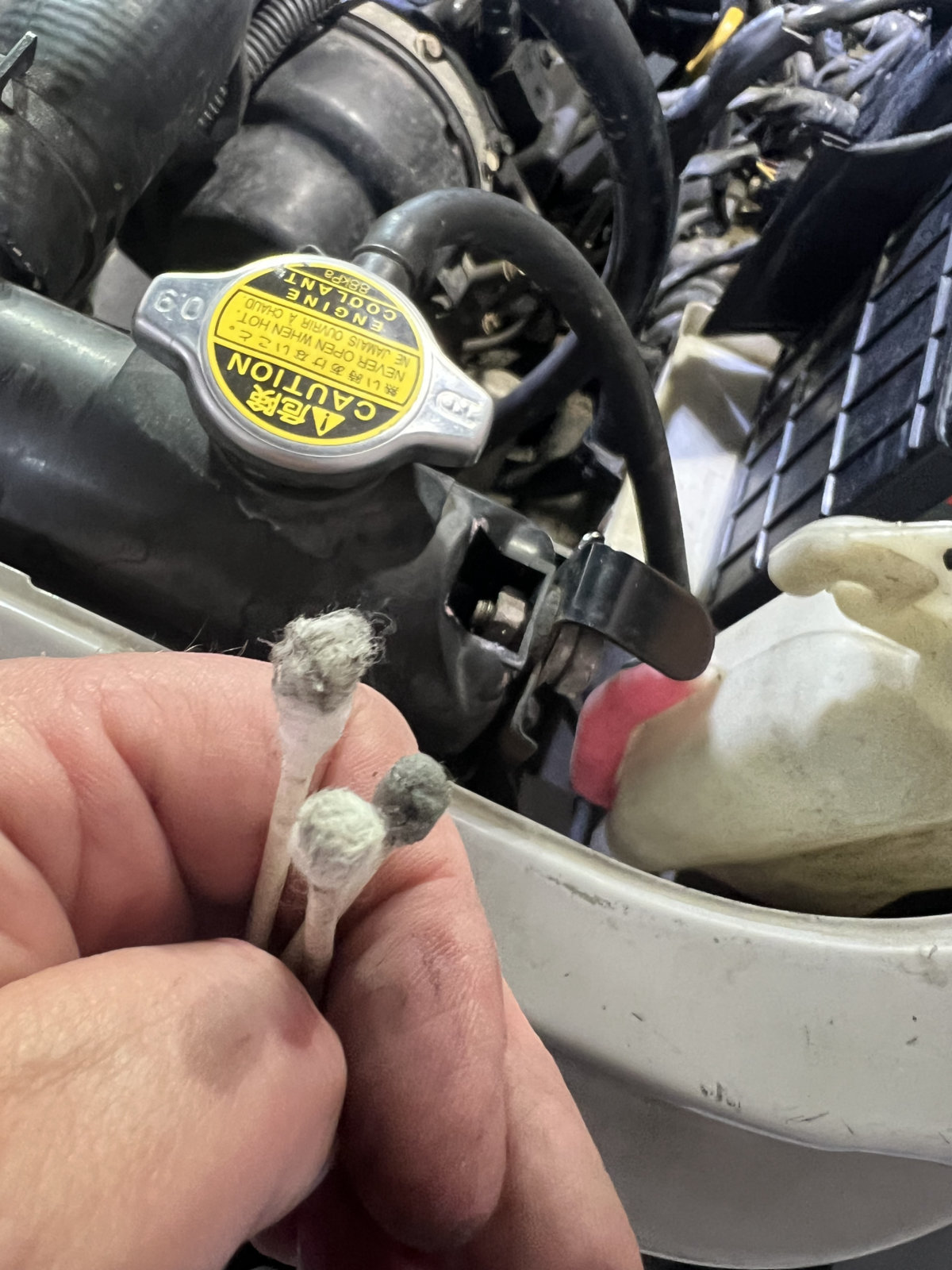

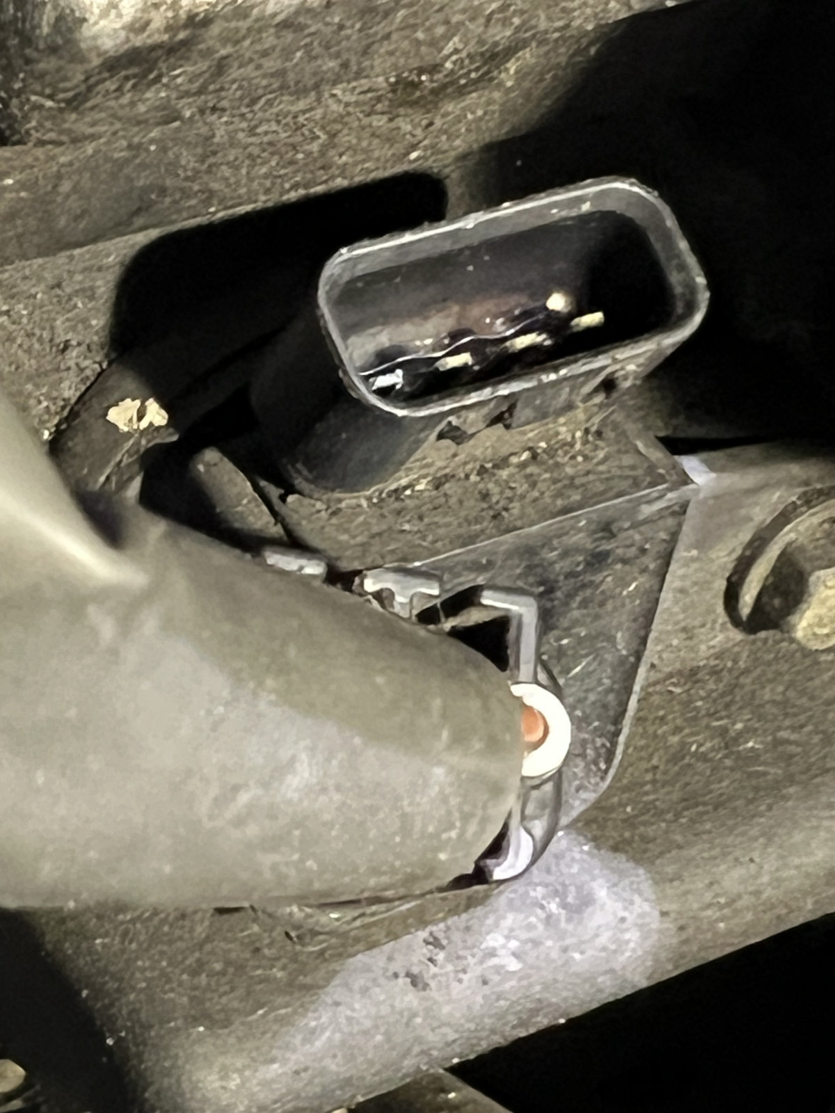

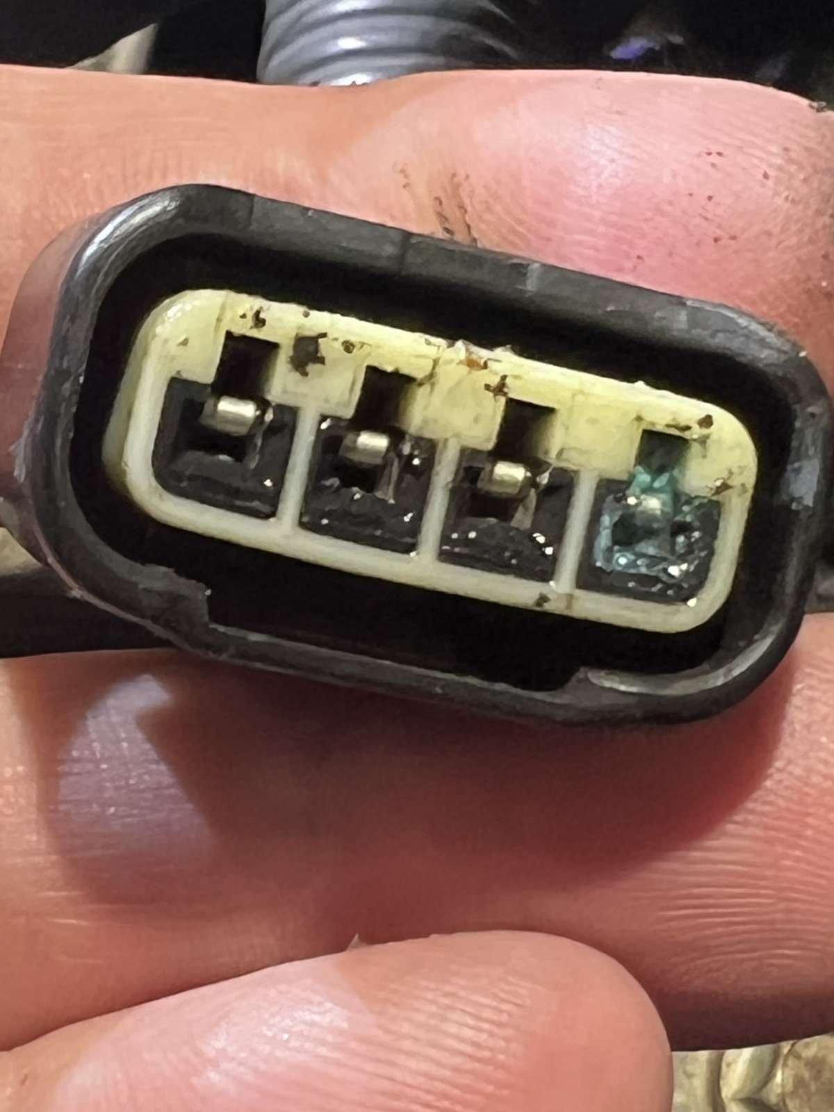

    One more update before the rig goes to the mechanic. I went back again and removed every connection and looked very closely at each connection and thought I found the problem. The front right coil connector (if facing the engine from the front of the vehicle) has coolant in the bottom. It wasn't a lot but I assume some splashed in there when I was removing one of the coolant lines. I hoped it would solve the issue so I used some q tips and dried it out, cleaned it out and then did the same thing with a q tip to each coil connection. I ensured I left no "fuzz" from the q tips and then used my handheld leaf blower to ensure each connection was dry and debris/dust free before reconnecting. I fired up the sequoia and it runs rough still. I drove it around the yard a bit and when in gear and motionless, it's pretty rough. It smoothes out when I accelerate but I'm not confidant it would make it to the mechanic so I'll wait until tomorrow. That needed to be fixed regardless of whether it solved the P1300 or not so thanks to Bfunke for mentioning the coils a few times, it made me zero in on them again and take care of a maintenance item. I did clear the code but it came back instantly, still P1300.
    I tried to get clear pics up close but it didn't work as well as I had hoped. In the connector pic, you can kind of see some pink in the top right of the pic and thats the toyota specific coolant.
